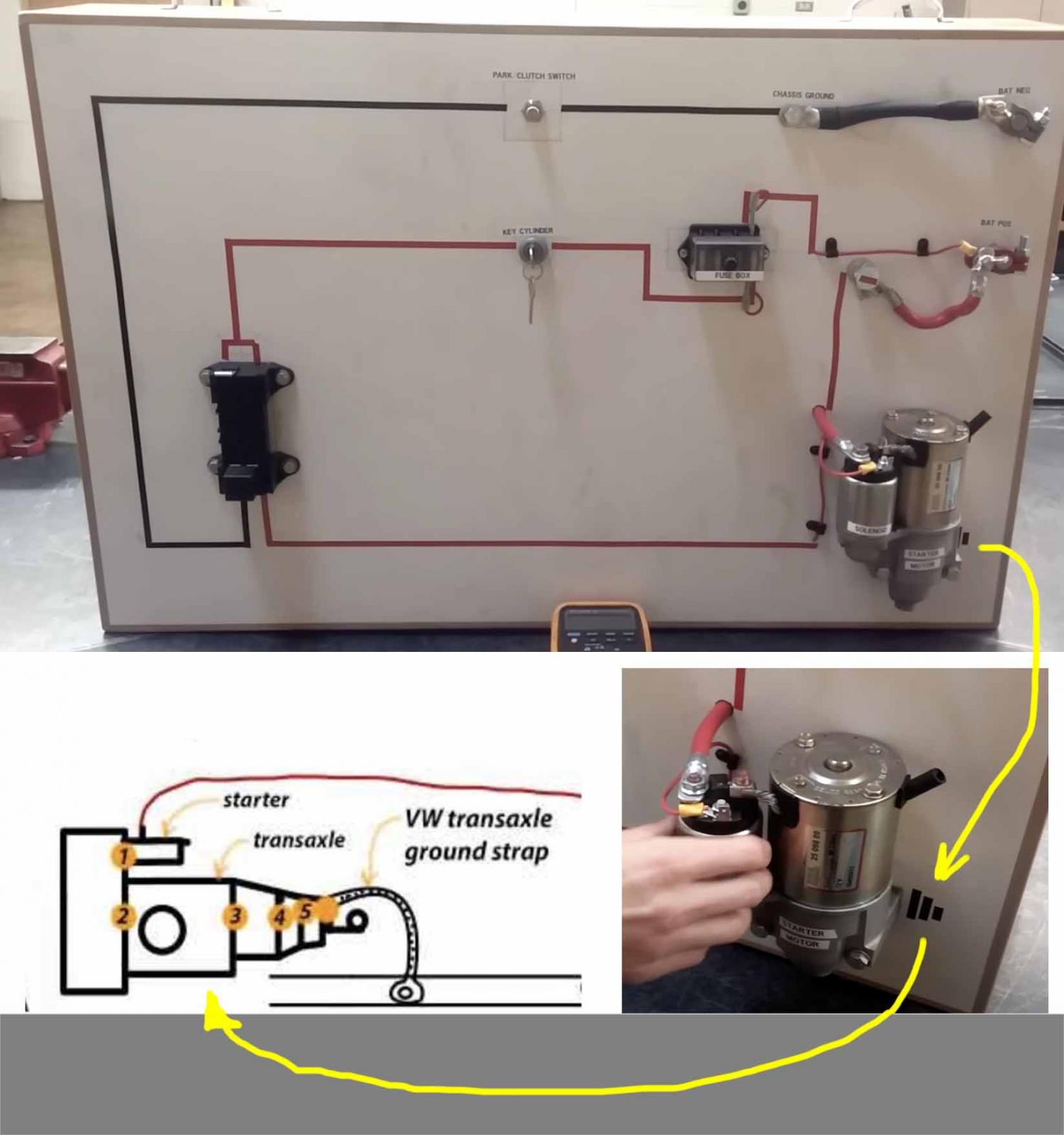

1. Charge battery, test voltage at starter=12.5v.
2. Remove and wire brush ground strap to trans. Everything shiny as a penny. No change.
3. Remove starter, bench test. Solenoid was a little sticky-I knew it! A-ha! Cleaned all connections, clean and graphite lube solenoid piston, bench tested starter and solenoid and it works fine on bench, but no change in van.
4. Test voltage at solenoid trigger wire to starter from hard-start relay=12.6v when key is turned.
5. Manually apply 12v to solenoid with starter in van. Starter triggers instantly. WTH?
So everything seems to work independently, but not together. I've read about voltage loss, adding ground straps, swapping ignition switch, etc, but I seem to get adequate voltages and be properly grounded in all the right places and still no start. Any ideas of next steps to take? I'm going crazy trying to find the logic in this.

Did you check the ground strap at the battery? And take it totally off and inspect where it attaches to the body. It often is corroded there. Scrape off some of the paint, apply dielectric grease to prevent corrosion, and reattach a good cable.
You should also do a voltage drop test while attempting to get the starter to work. Resting voltage means almost nothing. It only takes one strand of wire to give you a good voltage at rest but that strand will not pass enough energy during starting...

Regarding voltage drop, I just watched this video which was very helpful and enlightening to me:
Everything?
That's a lot of work. Wink
Curious how you cleaned all the internal blind threads?
Did they have that typical white corrosion on the threads (between steel and magnesium)?
And did you unbolt the front gearbox mount?
1) Starter body to bellhousing (perhaps OK because you removed/rebolted the starter)
2) bellhousing to main case ( internal blind threads, steel contacting magnesium)
3) main case to gear carrier ( internal blind threads )
4) gear carrier to cover ( internal blind threads )
5) Cover to steel mount ( remove transaxle mount to clean connection )
6) transaxle mount to copper ground strap (easy to clean)
7) copper ground strap to chassis (easy to clean)
All those connections are probably 40 years old, all dissimilar metals, outdoors.
I'm willing to speculate that about 5 of those 7 have never been cleaned in 40 yeaars.
Do you know the procedure to do a "voltage drop test" ( across 1 to 7 )?
That test would tell you,
definitively in about 5 minutes,
if your starter-circuit has high-amperage losses across the transaxle case.
I find it very strange that I am the only one to mention this
------ > on post #15.

E1 did you notice any key parts of the Vanagon start circuit that were not addressed in the video?
We need a similar video... done specifically for a Vanagon.
The basic problem is, everybody thinks:
    the positive is important
    and
    the ground is not.
Even that Video guy.
Elaborate presentation on the positive.
Nothing on the ground.
But if the ground cannot pass exactly the same amperage as the positive,
the starter cannot produce any power.

Sodo wrote:
Everything?
All the vans are pushing 40 years, and many vans live outdoors.
This is not "new technnology".
1987 Westfalia GL
Sodo
Joined: July 06, 2007
Posts: 10639
Location: Western WA
Sodo is offline
PostPosted: Tue Feb 25, 2025 1:27 pm    Post subject: Re: Another no start starting problem. Next troubleshooting steps? Reply with quote
tikiman71 wrote:
Ok-not quite everything, but I've seen your posts and will be adding some new grounds in the future, in addition to the voltage drop tests--thanks!
I am curious why you have embarked on a starter diagnosis without doing these mods first?
There's almost NO cheaper, easier mod.
One cable for $15.
Go all-out and do two cables ($30).
If proper grounds solve your problem, good.
If they do NOT, at least future diagnosis will be valid,
and you will arrive at the solution sooner,
and your van will be that much more reliable in the years ahead.
Starter cranks faster.
Headlights are brighter.
Gear oil doesn't blacken (etc).
There's almost no "better $30" you can spend on a van that's been outdoors for 40 years
and cringes when flatbeds pass by.
I put up this info repeatedly.....with almost ZERO feedback.
No feedback means that I don't know what is missing.
Why aren't people understanding this stuff?
----->Well, because as my brother says "just face it, some people will NEVER understand electricity" (that's me.....to his level)
But I think we can keep a few Vanagons off the flatbed if people will start to understand the Starter circuit.
It's very, very simple, but I don't know what people don't understand, because there's zero feedback.
Likely there is zero feedback because people don't know what they don't understand.
It's a problem. Cat chasing its tail.
tikiman71 wrote:
I have cleaned the mating surfaces from starter to bellhousing, and some of the other transaxle connections were cleaned/replaced and polished 12+ years ago when the Subaru adapter plate was installed and trans rebuilt. Maybe I get some partial credit for that at least? Ha!
You DO get partial credit. Everyone's a scholar here!
But partial credit delivers partial Amps.
Partial Amps is a failing grade though.........
F for Flatbed.
