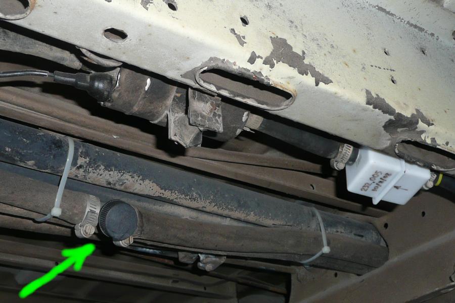

I added a flush tee to the heater hose as shown. Seems like this might be an easy to reach location for a shutoff valve.
[img]
Uh, definitely thinking outside of the box. ;D
Seriously, this does suggest something more plausible.

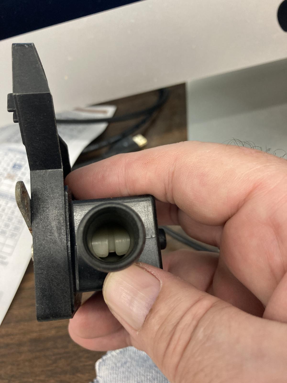

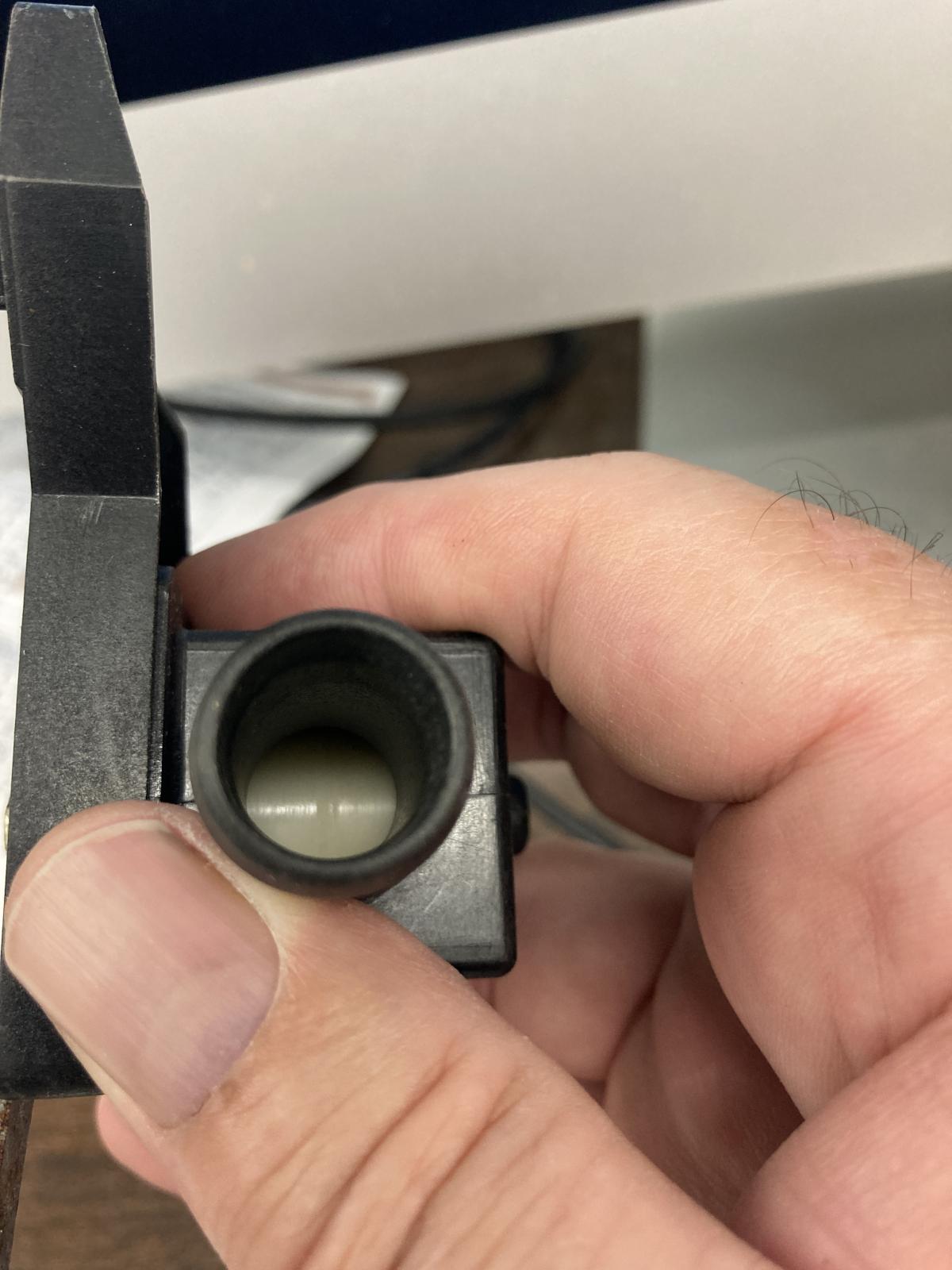

i can't speak to the Intrepid valve but the OE valve has a slight channel in the ball that bleeds thru a small amount of coolant. i suspect this is intended to keep fresh, non-depleted coolant in the heater core. the cure is to increase the non-heated airflow thru the core and ducting so have the levers wide open. that will quickly remove any heat soak from the core and firewall and it will be ambient outside air temp coming out of the ducts.
if you close the bottom, blue lever, it will close off the ducts leading to the door channel and to the vent openings above the slider. this can result in more air flow thru the front ducts at the expense of noise. the ram air effect from the intake scoop is strong, you won't need to run the fan unless crawling at city speeds.

this is entirely correct. those that have put a ball valve in place for heater regulation know how friggin' touchy the control is to modulate the heat. the groove and ball shape allow small coolant flow adjustments in the early stages.
i'm calling my initial statement about the groove allowing a small bleed of coolant thru the core for corrosion protection BS. blowing thru the closed valve with my mouth, there is a SLIGHT passage of air, not by design of the groove which ends before it meets the shell, but by tolerance of the plastic ball. the BTU contribution is negligible considering the slow passage of cooling-as-it-moves fluid thru a 10' hose with just a few milliliters per minute of flow.
pictures...
