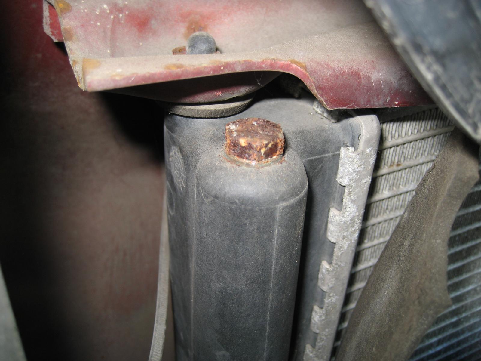

Hi all,
I am hoping to bleed out the air from my '89 Vanagon but discovered that a previous knucklehead installed a plain steel hex head cap screw in the radiator instead of the correct bleeder screw.
It will not unscrew with a medium amount of torque and I don't want to force it as I think it may well break the brittle plastic it's screwed into.
Any tips on how to bleed the system, or to get this sucker out?
Thanks.
It's a Subaru conversion, if it matters.

Just to the left of the bleed screw, in the black plastic is a round embossed emblem.
Read the 2 digit number in the center of it.
That is the year the radiator was made.
If the same or earlier year as your van then consider what might happen soon anyway.

Are you sure it isnโ€™t a bleed bolt? It looks stock to me. Anyhow, I believe there is a brass insert for threads not plastic. Maybe some PB blaster and some patience and it will free up.
I agree with Mark, that a new radiator might be a better option. Itโ€™s important to have that ability. There are likely some ways to get the air out, but not worth the risk.

Earlier Nissens rads had a plastic screw/bolt that easily snapped off. They supply a metal one now. I replaced mine with a SS bolt. Lots of PB Blaster?
Bleed it by running it hot and parking it with raised rear end (slope or ramps). Any air will collect in the expansion tank as it cools.
Edit: there should be an O-ring with the rad bolt.

Well I just assumed (haha) that the original bleeder bolt would not be made of steel that would obviously rust.
Maybe it is the correct screw. It has a 13mm hex and has the raised script ESKA 88.
The date code circle shows 88. So it looks like the original radiator.
I am not going to pre-emptively replace a good, 37 year old radiator with a POS aftermarket one that may last one tenth to one quarter that long, from what I've read about them on this site.
Well there is a $1000 USD all aluminum unit but I'll pass.
In my experience these plastic / aluminum radiators start to leak slowly and don't fail catastrophically. So I'll wait.
With luck it will get a tiny leak at the very top, allowing air to be bled out while only losing a few drops of coolant a week.

After 40 years your original radiator is guaranteed to be filled with sludge. PB Blast it, try to get the screw off, but if it snaps, it snaps. It's time to replace it anyway.

Well what you got there is galvanic corrosion, the screw should be brass, but since it is steel, well it galvanicly corroded given that it is screwed into brass.
High heat aint an option for you given the plastic near by.
So try the penetrating oils, Kroil, PB Power Blaster and such. You may need days of soaking.
Then keep a trying to loosen it.
If that fails, remove the radiator for access and try to drill the bolt out, with the right drills, technique and a steady hand that can work.
Replace with a brass screw to prevent reoccurance of corrosion.

No O-ring on my 1986 Van, it has a brass bolt and a soft copper gasket for the seal. There is no groove for an oring. With no o-ring groove, an o-ring is at risk of failure.
Use a soft ( annealed) copper gasket for the seal. and a brass bolt so in as it wont under go galvanic corrosion as is the case with the steel bolt which is the subject of this thread

I would warm it with a torch with a needle tip three time, using my fingers to keep it well under plastic melt temp.
The get a socket on it and off it will pop.
Worst case if it breaks or melts, JB Weld in a stopcock and bleed from there.

You can also try tapping that bolt with a light hammer about 200 times and see if that can loosen the scale enough to allow you to turn it out. Good luck.

The fix is simple, crack that bolt loose. If it breaks and becomes useless, go to a hardware store and find the old guy with grey/white hair. He will hook you up with epoxy and a valve.

The drilling idea got me thinking - I could drill a small hole in the bolt and thread it for, say, a 3mm (stainless!) screw to bleed it.
If I were really lucky I could loosen the radiator and tip it forwards at the top so I could do the job without having to remove it.
When the van is warmed up the radiator is only hot on the lower third, which seems to indicate that's the coolant level. In other words I have one third the cooling potential of a properly functioning system.
But the climate here is not too hot so it's been okay for the few years of ownership.
I did try putting a 13mm box wrench on the bolt and tapping it many many times with a big brass bolt, I will also try the suggestion of heating the bolt gently while shielding the rad.
