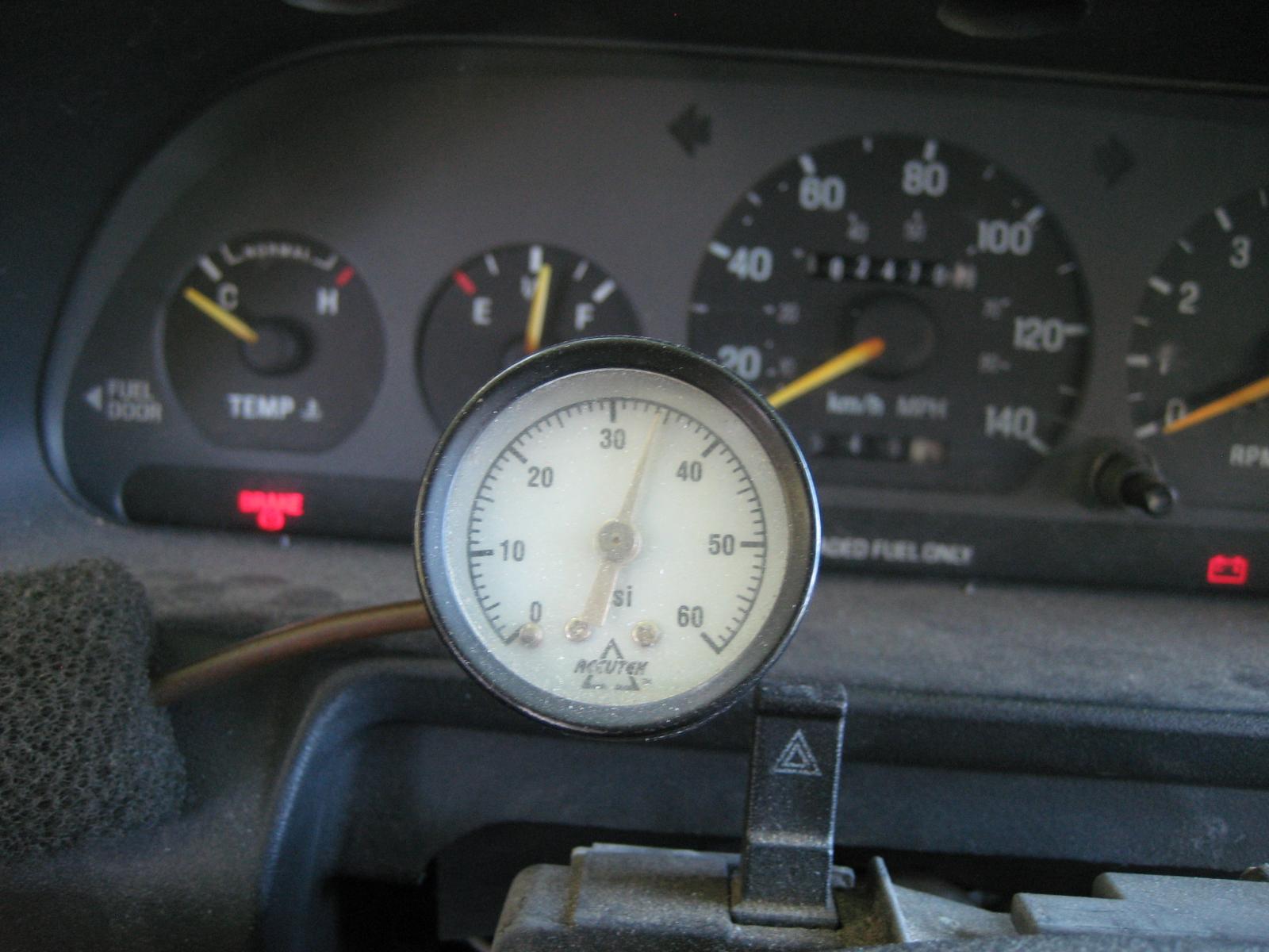

How are you monitoring fuel pressure while driving?
I installed a mechanical gauge temporarily in an off topic car a little while ago. Very useful diagnostic tool:
Oh im not even driving. I’m just idling when this is happening. My fuel pressure regulator has a gauge on it at least so I can monitor what’s happening, I think if I was to drive I’d probably make it a block or two before it fell on its face and I’d be stuck pushing it home.
