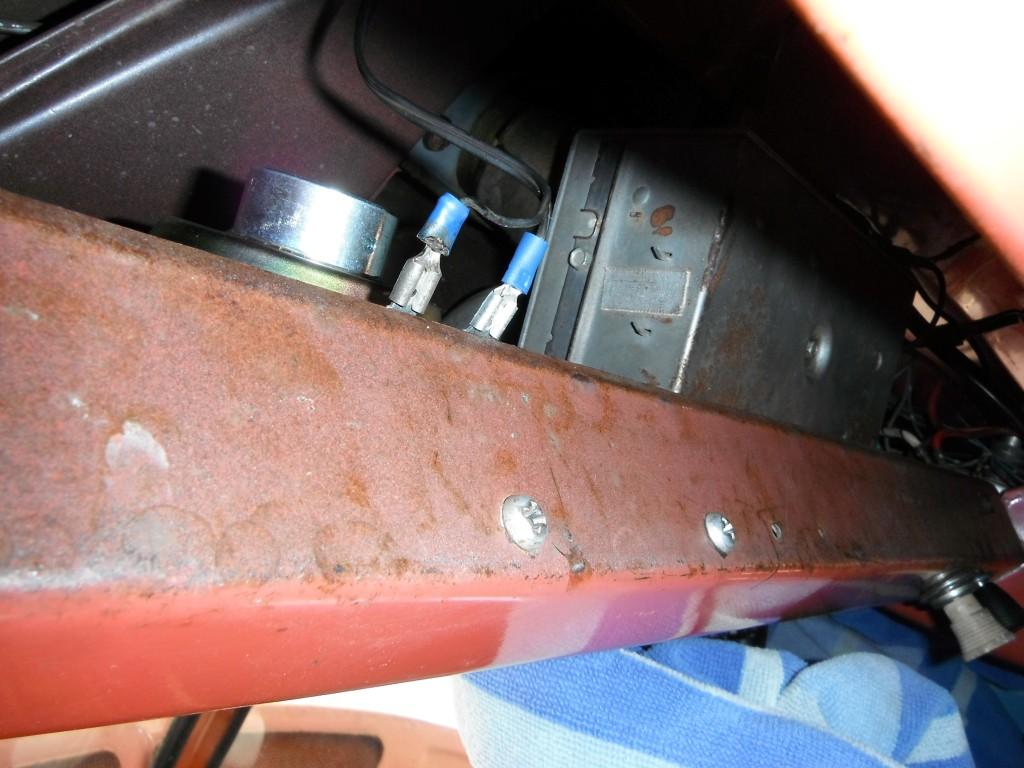

It screws in from underneath off to the right of the radio and is not close to the wiper motor.
A couple pics of the bracket and it mounted in my '61:
A '65 has the larger wiper motor and assembly though, right?
My '61 might be much easier.
Maybe someone can post a pic of that or explain if it doesn't easily slip up in there.
