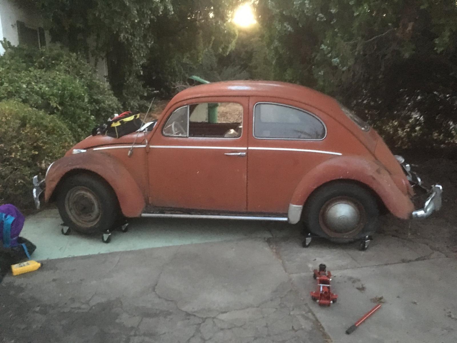

Dad purchased Ruby in mid October 1968, the second owner. Sadly, in the 1980s she was stolen by a vending machine robber (convicted of armed robbery because carried a knife) and lost all her paperwork plus her black and yellow plates. Dad remembers one of her dates is Bastille Day, though the birth certificate (which is currently lost in all the boxes of papers) says born in January 1964. Do see lists as a tourist, so wondering if that could mean they traveled Europe over the Spring and that date was import?
Then the call from the police doing a welfare check on Dad last Sunday in June informed he had passed in his sleep, turned 72 in November so unexpected (all the other family passing well into their 80s and even into their 90s, Oma was 98 ).
Going though a bag of magazines, I found the will stating I was the next custodian of the Beetle. I knew this, made it easier having that. So, contacted Jeff at Four Corners and had her shipped to Arizona. First though, had to be moved for putting the dumpster in the drive and to do that, the juniper had to be trimmed (some brilliant person in the 1950s planted it at the edge of the drive).
There she is!
Sure nice to have the dollies and even nicer to have my Brother's help (I was pulling on the front).
And the temporary spot.
We made sure my niece and nephew got to sit in the driver's seat, unlike us children (except me one time because Dad needed me to push the brake pedal though being 12 was a tad bit of a reach). We loved seeing them enjoying it and the different personalities (he wanted to go for a long drive while operating everything and she just wanted a drive). My hope is they come out to see me and when able to, drive her as they most likely will be the next custodians.
Without asking or even the adults saying anything about cleaning, my niece got a broom and went to work. She is turning out to be an amazing person, hopefully continues though her life. Ruby had been sitting for about 15 years so was a lot of work.
An amazing friend named Jack gave me four wheels with rolling tyres that for some reason came on a Notchback. Without that, getting her onto the transporter be really difficult if not nearly impossible.
We got most of Oma and Opa's house cleared out (three generations of stuff to resolve) though my Aunt in a hurry to grab everything of her parents would dump piles of stuff in the front garden, hard not to cry. To make it worse, dumper didn't get taken away when promised, so couldn't go forward and through the garden and tight squeeze going back. Can always make lemonade.
Then when when the driver and I tried moving, despite all four drums not stuck to the shoes, was hardly moving. So, I asked about using his straps as had the idea to use the UHaul; work smart not hard. That was the way to do it. Was really wishing had cash on hand to tip and he dropped with no one there so again couldn't.
Ruby moving to a new home, end of 50 and about a half years at the same home, same parking spot on the drive (except few years at other homes a few times).

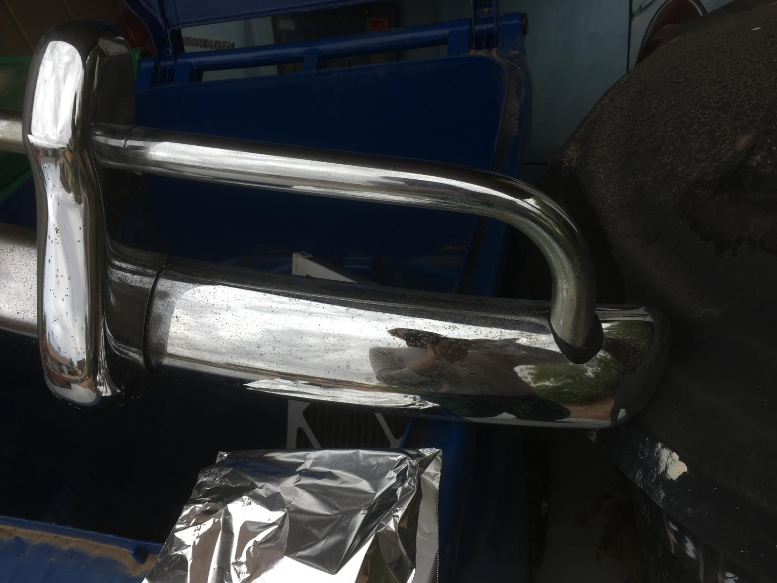

The really interesting find was a bumper in the garage attic. It has been there since I can remember, wrapped in a heavy paper, almost cardboard. Dad said it was the bent rear bumper from when rear ended, grabbed it in the few minutes allowed in the garage, and only after got home did I unwrap. Which transitions into the next topic.
Being rebuilding the fuel pump was a bust (Wolfsburg West filter too thick so the cap isn't sitting strait and they refuse to remediate) decided to go have fun and unwrap the bumper.
My goodness, a brand new front bumper! Shocked It's Brazilian, isn't it?
Some reason the picture after polish my cellular corrupted. Still has pits, though being on the front, a new bumper get pitted quickly anyway and I am on a budget (get $400 a month from the Special Needs Trust to live on). Plus, as time goes on, leaning to doing the restoration like Dad would have if he didn't have a garage (and didn't restore as didn't have a garage to keep it safe, stolen twice so understandable his concern).

That's an aftermarket bumper. You can tell by the rubber grommet at the point where the towel bars meet the blade.
Looks like that '64 will be a great starting point for a resto project...should be a sweet ride when you're done.
My thought too, plus the fit is awful. Though with a good set of bumper brackets can give her a strait smile (right now has Brazilian brackets on one side and not all the holes align to where can have bolts). When have the bread can get her a Wolfsburg West bumper (which been wanting since they first came out).

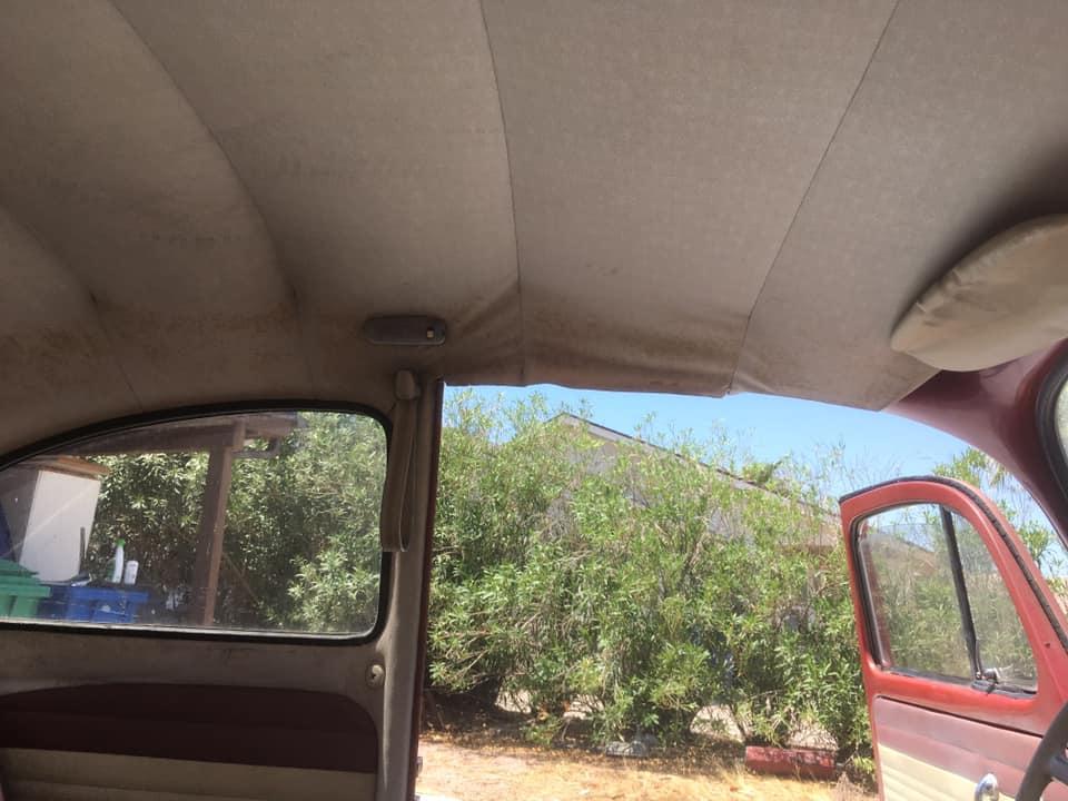

Spend a day in over 100 degree butter thick humidity using recommended cleaners and couldn't get the brown spots out.
I was hoping to save the headliner as in decent condition, no holes, not coming down except at the door edge, and still pliable. So what are those spots and will they come out?
I can reach my hand inside and feel no padding at all, shouldn't there be some?
If the headliner can't be saved, thinking add something to reduce the heat in the cabin even if not stock.
Wolfsburg West bumpers are, by far, the finest reproductions available. Look beautiful and fit perfectly. Expensive, but worth every penny.

rcooled wrote:
Thank you for confirming. Dad loathed the rear bumper as can't open the engine lid without pushing on the bumper with your foot. Felt so weird the other day when I did it, first time for me.
When repainted, will only be the outside and the door jambs, just as Dad would plus want to save the dash even if doesn't quite match, don't care.
When it comes time for a repaint, remove the glovebox door and take it down to paint shop and have them read the color from the inside of the door. If the dash paint has faded, have them read the front side of the door. This way, the new exterior paint will almost perfectly match the interior. If you have a shop do the painting, they'll probably be able to match the paint in the same way.
I was planning to use the glove box lid though was under the wrong impression that wouldn't match. There is an old paint supply shop that I used the code to get touch up paint for a vintage Mercedes and was bang on. Not that would, just saying blessed don't have a 45 minute drive like in Sandy Eggo, plus have books going back at least forty if not fifty plus years.
