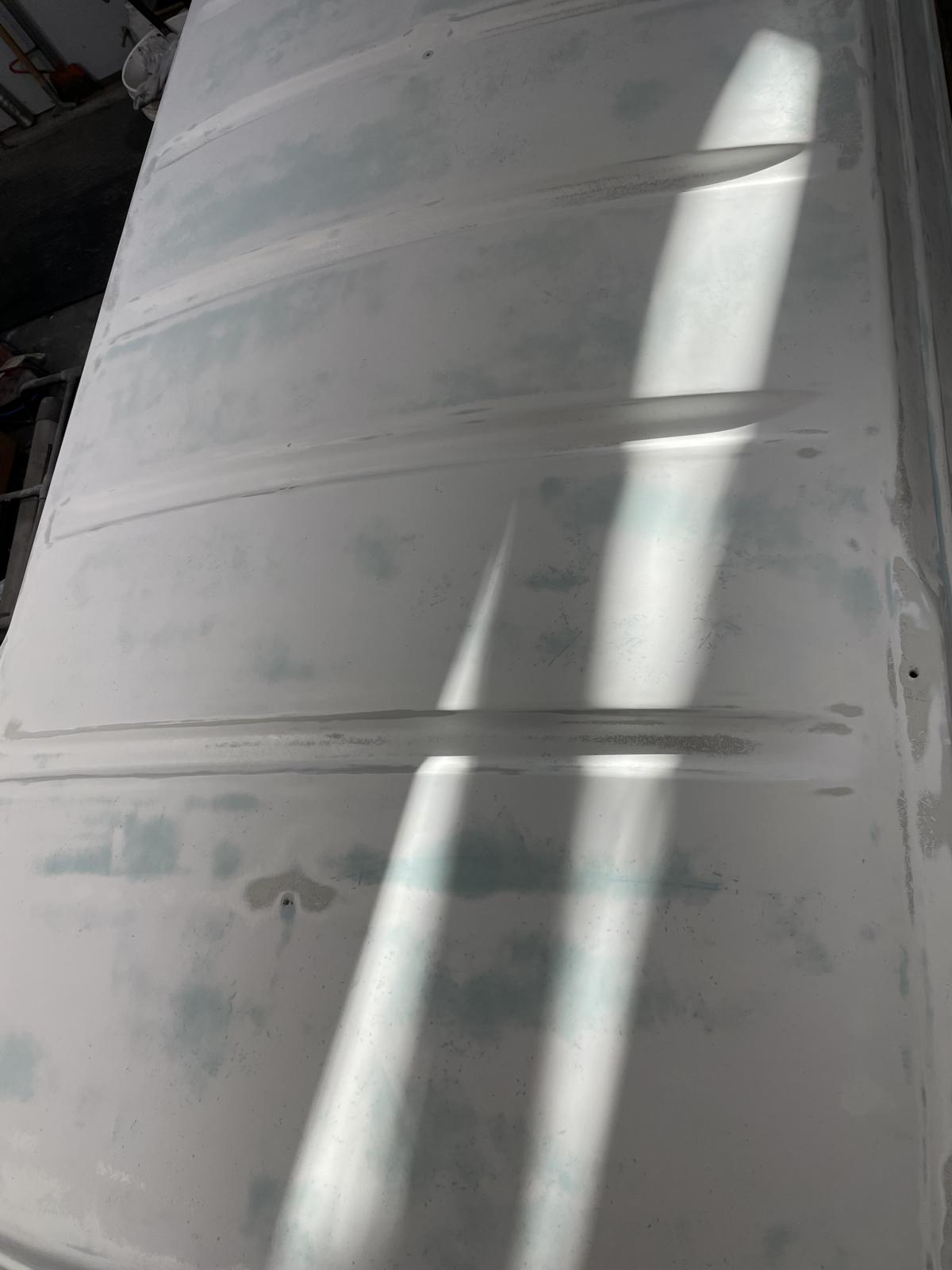

I’m currently working on my ‘71 Westy that has a shredded canvas. I’d like to remove the fiberglass to re-gelcoat it and take care of some surface rust on the roof of the Bus. Unfortunately, buying a new canvas isn’t in the budget at the moment as I focus on other areas the Bus needs.
Would there be any issues if I were to put the fiberglass back on without the canvas? I’m mostly concerned with the roof not closing correctly and potentially leaking or being loose while driving because there’s nothing under it.

First off, I'd just paint the top with Interlux "off white" bright sides paint. That's what I have done with mine 15 years ago any they still look perfect.
No canvas will mean a lot more air flowing under the fiberglass top. The top will be wobbly as all get out if you open it up. The canvas helps hold the top in place by tension. But overall, you won't harm anything by running it without. But I'd sure want to figure out a way to put a new one on while your'e doing the other work. Cool

This bus spent the first 40 years of its life cooking in the New Mexico desert. The top is very dull with surface cracking in the original coating. Will the Interlux paint still be sufficient to protect it? The price between the Interlux paint and gelcoat from my local West Marine is pretty comparable, though I’m sure the application is different.

New gelcoat may not stick too well to well to old well cooked gelcoat unless its well abraded.
Also note that gelcoat is intended to cure when between a mold and layers of laminate, in the absence of air. If you paint it on it may remain depressingly sticky until it has built up a layer of protective dirt..
You need flowcoat.
Or a really good clean and rinse , degrease, sand, fill and paint

I think the interlux paint will work fine on your sunburnt top. One I did was sitting in the desert for at least 15 years. You will want to sand it first and use the recommended primer and I'd suggest 3 coats of paint on top of that. You can roll it on or brush it on. I think I rolled and tipped mine.

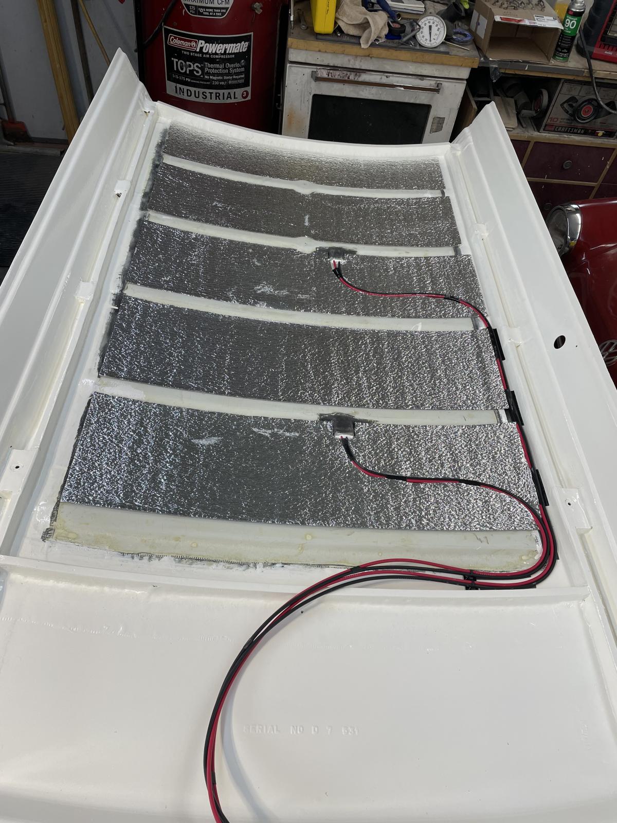

I ran mine a year without issues with no tent.
The top was painted when I got it, but it wasn’t prepped properly and there were a ton of dry spots and missing gelcoat, and the woodwork was broken or coming off.
So it got primed and painted with the interlux inside and out. Added wiring for the solar panels, a layer of insulation and some hull liner ,
I should have added a roof light while I was doing all that, but it didn’t occur to me until our first camping trip Rolling Eyes

PostPosted: Fri Jul 11, 2025 7:38 pm    Post subject: Re: Westy fiberglass top without canvas… issues? Reply with quote
That top looks great.
Interlux it is.
Thanks for the info.
