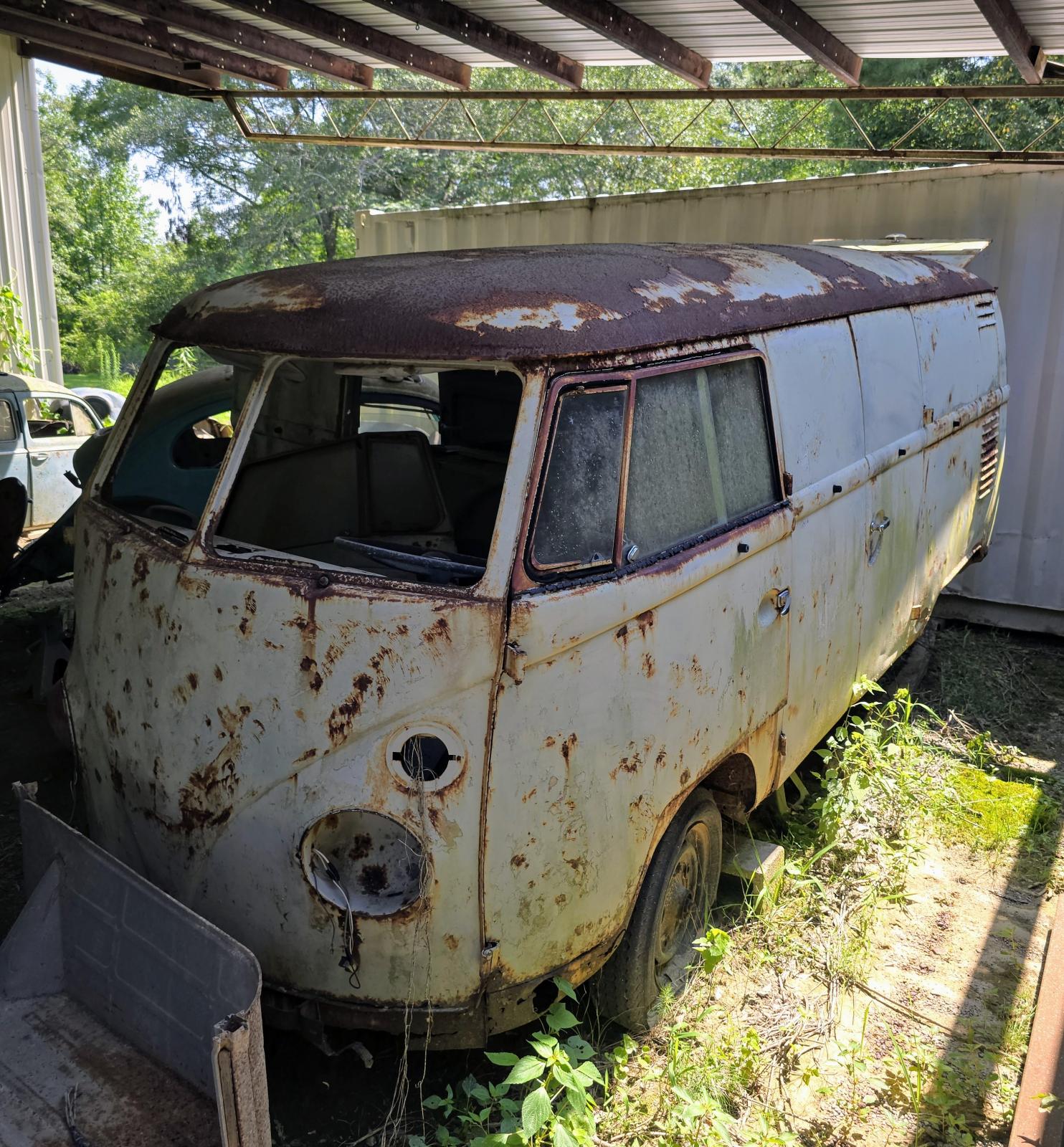

I have a 1963 double door panel bus that somebody cut the entire rear torsion and suspension out of. So now I am thinking I would like to replace it with IRS.

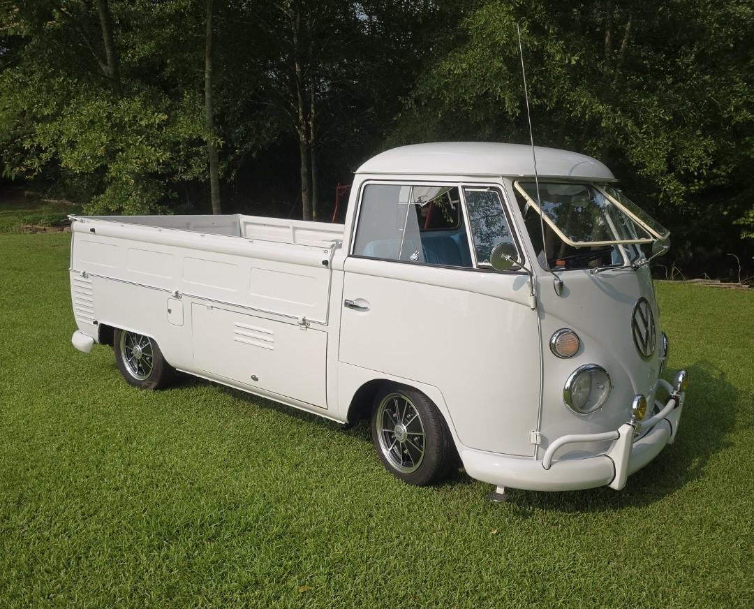

Not going to be slammed. Probably only lowered 3-4". My '63 single cab has just removed gear boxes, then dropped spindles and it drives great.

Back end of this bus is very rough, but I have bought all new metal for the outsides and a donor clip from a walk through bus to repair the area above the motor. And I have bought clips for frame parts from different years of buses just in case too.

It seems like a ton of time and expense for a fried egg panel van with massive rust issues in some challenging places. Correctly fixing the drip rail alone is a substantial undertaking. That’s even before all the fab work for the running gear.
There’s 7-10k in just panel cost alone… and a drivable comparable example is worth.. 7-10k… it would be possible for someone to straight-up buy one and save a year (or more) of their lives in the shop AND be financially more ahead.
I admire the dedication but perhaps a better starting point would be something to consider.

Karl H- Wow! What a thread! I read all of it. This bus is cut about 8" ahead of where the torsion tube used to be. So, I can use whatever this thread comes up with. I do intend to machine the bay spring plates like pyrOman did if I go with a bay torsion. Narrowing the torsion is a possibility. May have to cut the torsion bar ends and take some out of the tubing. My guess is 1.5-2" total is probably safe to do. Also guessing the best way to cut torsion bars would be in a lathe and have oil sprayed while being cut?
Pandoras Box- I was told there are far more options in rebuilding a beetle IRS transaxle, but I do not know this for sure. And I also figure VW used the 3 ribs because they are better. I do not intend to carry heavy weight in the bus. Probably only used for taking vw parts to The UPS Store and trips to pick up shop supplies.I have never used or installed air ride, but I'm very interested. And I am willing to tub this, but only 2" max because my '63 single cab is stock seat and only lowered with dropped spindles and I have to lean forward to see stop lights.
Majoring Martin- I live in Alabama. Only 3 VW shops left in the entire state, zero junkyards left and most VW guys sold the good cars and projects years ago when prices went up. I have recently heard that the North West still has a lot of cars available and at lower prices than what we see on line. Finding a more solid bus down here would be very hard to do.
I have nearly 100% of the new metal and donor metal bought already. This roof is very solid. I only found 2 pin holes and I felt around inside and squeezed the inner structure and it is very solid, no holes or weak areas.
