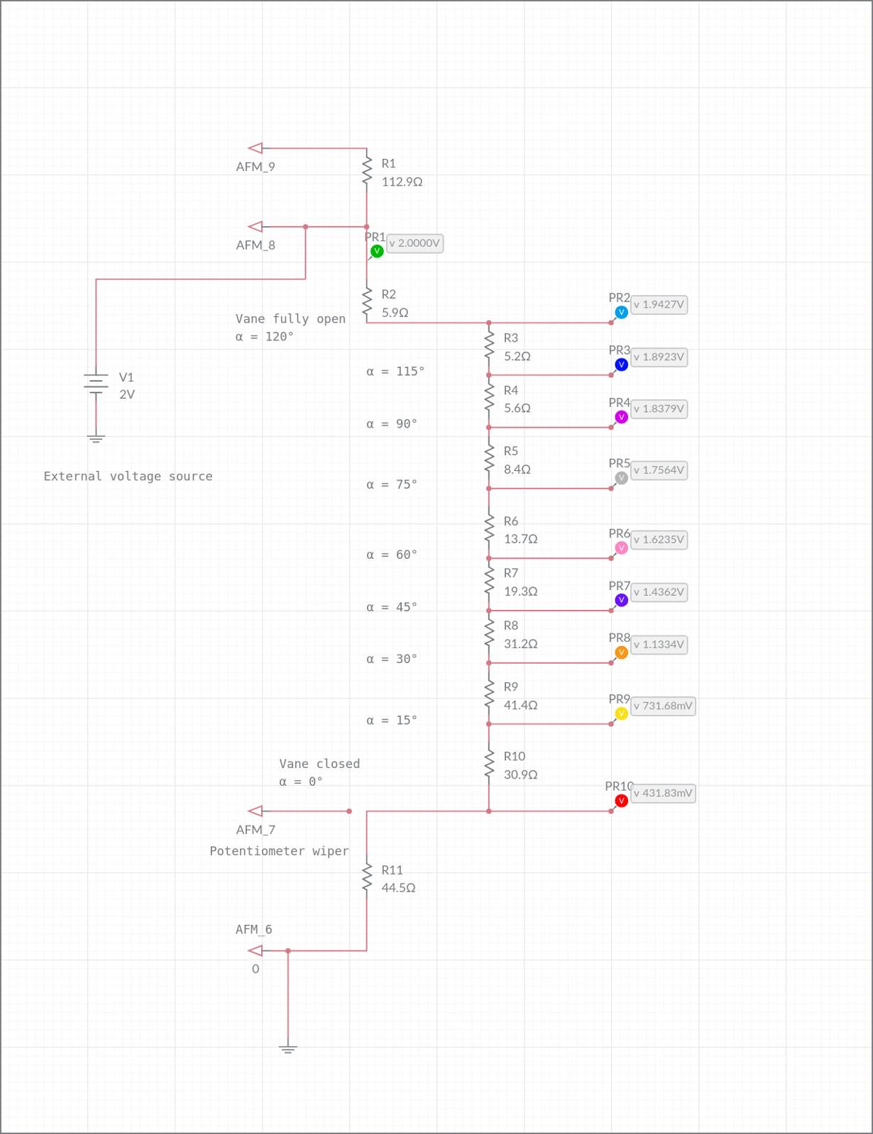

Some background to the questions:
Whenever I've done this test, I've always used a higher voltage at pin 9. I noticed when you connect an ECU, the voltage there is about Vbatt - 2V, so I either applied this voltage directly, or used the ECU to provide it. The end result of testing the voltage variation on the track should be the same for a low and high voltage there. I'm just curious as to whether you had a particular reason to test with low voltage.
A while ago, I measured the parallel resistor network on my spare AFM, and at some point I thought I'd simulate the circuit, but I never did. Your post prompted me to finally do it Smile
The pictures below show the AFM circuit diagram (without TS1), with the resistor network and the voltages at each wiper segment's junction point with their corresponding parallel resistor.
Those voltages would be read at pin #7 whenever the wiper reaches the given point on the track. Each full segment traveled corresponds to an angle of 15° of deflection on the vane.
• With an ECU connected and 12.6 V supply:
• With your 2 V applied directly to pin #8. The simulation of my bus' AFM seems to confirm your measurements on the bug's AFM, so the PCBs are probably the same
As per the need of pin #8, I've never understood why it's there. In some literature it's called "compensation (7.5V)", but I can't see what compensation it could be doing. The voltage to operate the AFM is provided by the ECU at pin #9. The ECU then seems to just tap into the voltage divider and the Air Flow voltage signal is taken at pin #7, referenced to ground.

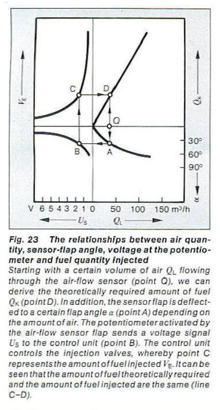

In addition to the Bosch manuals, often a good source of reference for the FI system is the Datsun 280-Z manual.
There I found this schematic of the AFM circuit, which is the same as the one in a bus (although most probably the resistor values are different):
Notice how it seems to indicate that the air flow voltage output is not taken between wiper (7) and grond (6), but rather between 8 and wiper (7).
The main thing that this seems to do to the output curve is to flip it vertically, so that voltage DECREASES with INCREASING air flow. That would then better match the curve of AFM voltage vs. angle part (bottom left hand side) of the Bosch four-quadrant diagram. Taking the output of wiper (7) and ground (6) produces the opposite (voltage INCREASES with INCREASING air flow).
On the other hand, this was probably a generic L-Jetronic marketing diagram, not particularly for buses, so I don't know how accurate it is, or if the magnitudes apply to the Type 2.

ve7kilohertz wrote:
I would like to know what AFMs you have tested telford dorr and furgo.
I tested a 0 280 200 020, bus 2.0l AFM for a '79 Federal ECU. I also tested a 0 280 202 007 for an Opel Commodore (6 cylinders).
The voltage output was quite similar, but the resistor values were different. The return spring is set much stiffer on the 007 unit, and also it has a different max air flow (400 m³/h vs. 300 m³/h).
ve7kilohertz wrote:
Look forward to learning more about the ECU/AFM relationship and why some AFMs work with only certain ECUs.
I think if the AFM was designed for a bus, the only AFM/ECU incompatibility would be the presence or absence of the air temperature sensor (TS1) on the AFM box.
I *think* for instance, that your 0 280 200 006 AFM does NOT have a TS1, so you'd need an ECU that does not expect it.
telford dorr wrote:
My DVM, like most, has ranges 2 volts, 20 volts, etc. full scale. Wanted to use as much meter resolution as possible, but didn't think 20 volts would be acceptable to the AFM, so I used 2 volts. In short, purely arbitrary.
Ok, makes sense now.
telford dorr wrote:
(1) Feedback to an op-amp which drives pin 9, thus regulating the voltage at pin 8, and therefore the voltage across the resistor divider, or (2) a place to measure the voltage across the divider, used to ratiometrically determine the wiper angle, and thus the airflow. These are guesses - haven't reverse engineered the ECU circuit. Option 1 would be more elegant, engineering-wise, as it would make subsequent circuitry simpler. Option 2 would allow operation at much lower voltages, such as while starting, or with a low battery and bad alternator, but would require an analog multiplier circuit to determine the vane angle, adding complexity to the design. It has to be one of these reasons, as battery voltage varies too much to use without some kind of compensation.
Excellent, thanks. I'm not sure it's (1) though, as I don't think the current is regulated. The voltage at pin 8 varies with varying Vbatt. Unfortunately, it's not possible to reverse-engineer the ECU in this area. I tried a while ago, but the AFM inputs go first through some filtering and then straight into one of the Bosch proprietary ICs (i.e. black box).
telford dorr wrote:
The trimming process for these resistors must be pretty complex. I wonder if it was done on the bare resistor substrate, or on an assembled AFM? I noticed test pin pads on the substrate. One would think that if testing was done on the bare substrate, that it's manufacturing process would be able to hold much tighter tolerances, alleviating the need for such radical trimming. This makes me think that the trimming is done on assembled units, and is compensating for mechanical variations. It's a guess, however if it's correct, it would eliminate the possibility of mass-producing replacement resistor substrates. Crying or Very sad
Good point, I noticed the test pads too. I don't know. I guess there were two processes: 1) trimming, with a voltage measured at the test points and 2) placing the PCB in the right location, so that the wiper start and end points have got the right voltages. I had always thought that they were done in the same step, so that measurement only needs to be done once. Say if trimmed replacement PCBs were produced standalone, would it not be a relatively easy process to place them in the right spot, though? Am I missing something or is it not just a matter of checking that the wiper is in the middle of the track throughout its full travel, and that the initial (vane closed) and final (vane fully open) voltages are as expected? At leas the AFM remanufacturers manage to do that, right?
(I wrote this before Ray's reply, which probably invalidates my guesses there Smile but the question of installing the PCB still remains)
raygreenwood wrote:
And bear in mind that the TS-1...meaning temperature sensor in the AFM...is variable ballast for the resistor stack up of the potentiometer.
I need some more time to read your full reply (thanks Ray!), but this bit caught my eye at a glance. Unless I'm missing something, on a bus AFM the TS1 thermistor does not affect the potentiometer output. Yes, it's connected to pin 6, but that pin is GND (see the Datsun circuit I added on my last post)
'79 Westy, P22 interior, FI 2.0 l Federal, GE engine (hydraulic lifters)

Yes....TS-1 may not affect potentiometer outpit on bus (I will have too look at the schematic)....bjt it most certainly did on Datsun and other makes....where the connection of the variable resistant of the TS-1 is connnected to either input + or - on the potentiometer input leg..
In my reply....in reaponse to your last post.....make note that trimmimg of these boards is not that complex. Rqy
Indeed, I had undestood that (actually, a while back in a conversation with you Smile). My question was rather on the installation of the board.
