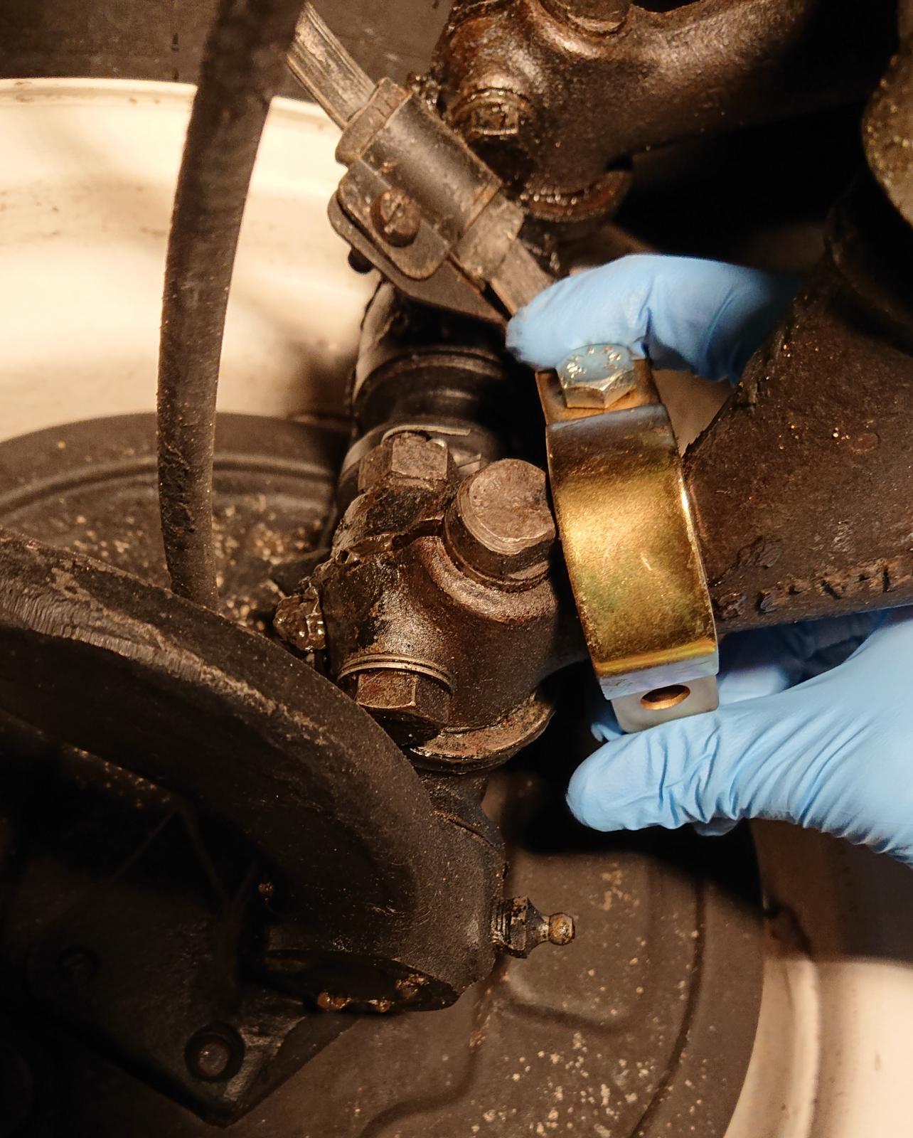

Hi
How is the rearmost sway bar clamp supposed to sit? I'm fitting a bar to an early beam which I've read works, although it wasn't a factory option.
I have both sets of clamps, the bushing clamp and the smaller rearmost one.
It looks like the smaller clamp should square up to the outside edge of the lower trailing arm. In that position it would run perpendicular to the flat spot on the bar. When I offer it up to test fit though, the rear of the link pin gets in the way...
The only way I can get it to clear the link pin is to twist the clamp so it squares up to the inside edge of the trailing arm, but that way it would sit at an angle across the flat spot on the bar. It also looks like it would interfere with adjusting the link pin..
Has anyone else had this problem? What is the solution?
Thanks
Andy

Whether or not it is correct, this is the same situation I faced after installing one on my ‘62 DC stock setup. Adjusting the link pins is and has been a bit taxing, but so far no issues.
I’m also interested in learning, if there are ways to mitigate it or if this is the nature of the beast in installing one in earlier setups. Again, mine has worked and is noticeably better; the clamp situation at the link pin is a mild concern. Hope someone has some insight or comforting words haha. Note: off-roading with the sway bar was a bit bumpy hahaha.

The clamp does interfere with the access to adjust the link pin. Its a small price to pay for the improved handling that the anti-sway bar provides.
I put the anti-sway bar on all of my buses, even though none of mine came with it when they were new.

PostPosted: Sat Jan 26, 2019 8:54 am    Post subject: Re: Sway bar / anti-roll bar on early beam Reply with quote
Thanks both. I thought a compromise might be necessary.
To clarify; have you installed yours like the first or second image above?
Thanks
Andy

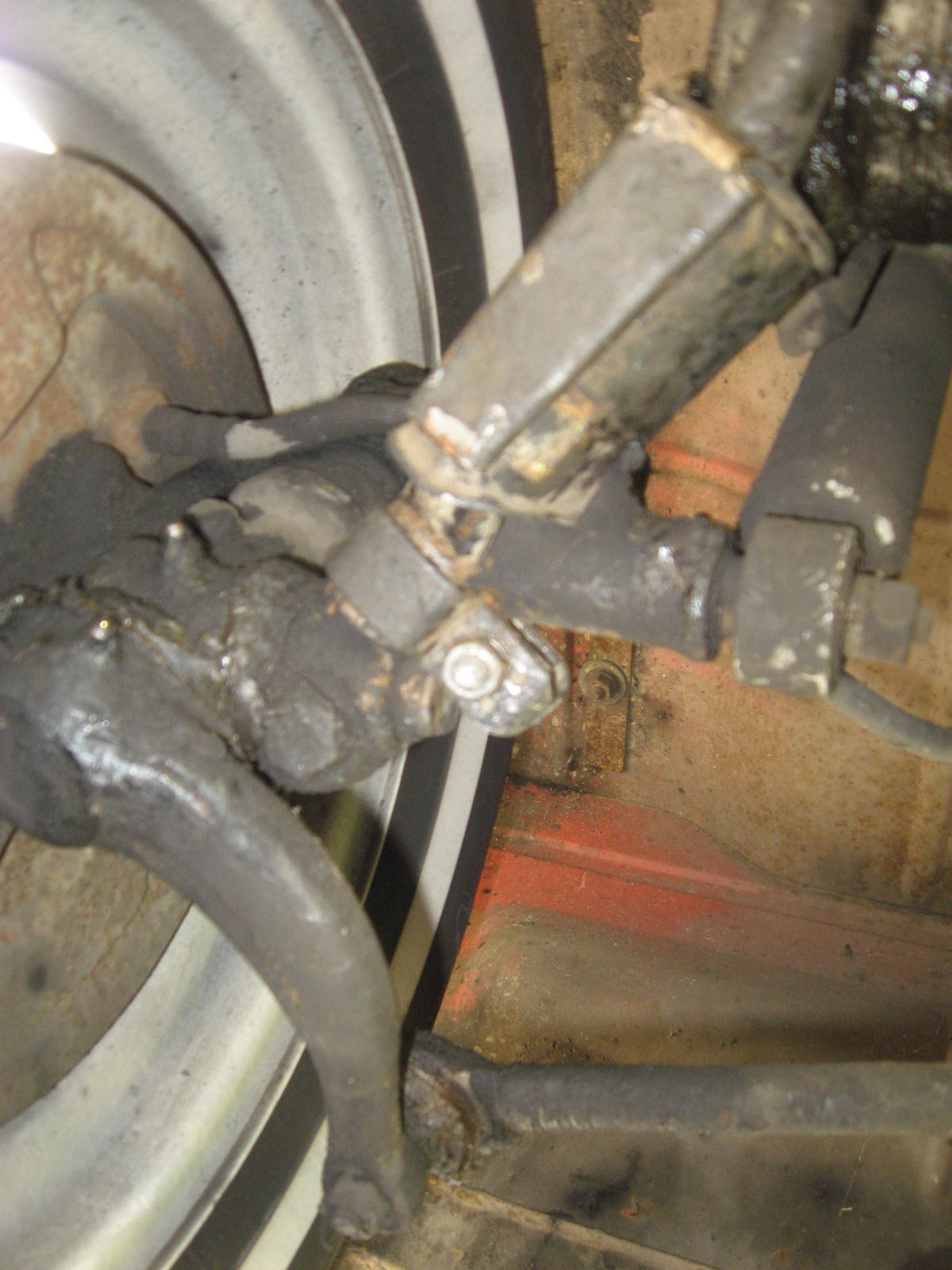

PostPosted: Sat Jan 26, 2019 11:31 am    Post subject: Re: Sway bar / anti-roll bar on early beam Reply with quote
A couple of pics of the '66 front beam with the factory sway bar installed in my '56. You can see how the bar mounts on a late beam, hope this helps.

PostPosted: Sat Jan 26, 2019 12:10 pm    Post subject: Re: Sway bar / anti-roll bar on early beam Reply with quote
https://www.thesamba.com/vw/forum/album_page.php?pic_id=688670
my 61 15 window with 64-65 beam with 66-67 sway bar:
End clamp is on backwards, as the T for the shock mount is wider than the 66-67 trailing arm, and it doesn't fit right. Awkward to adjust the link pins.
compare to:
66 kombi with 66 beam with stock sway bar:

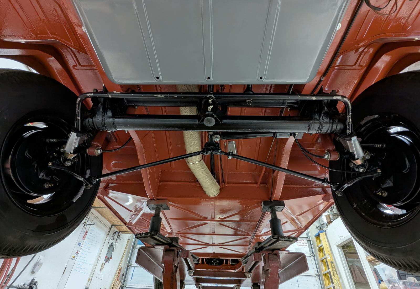

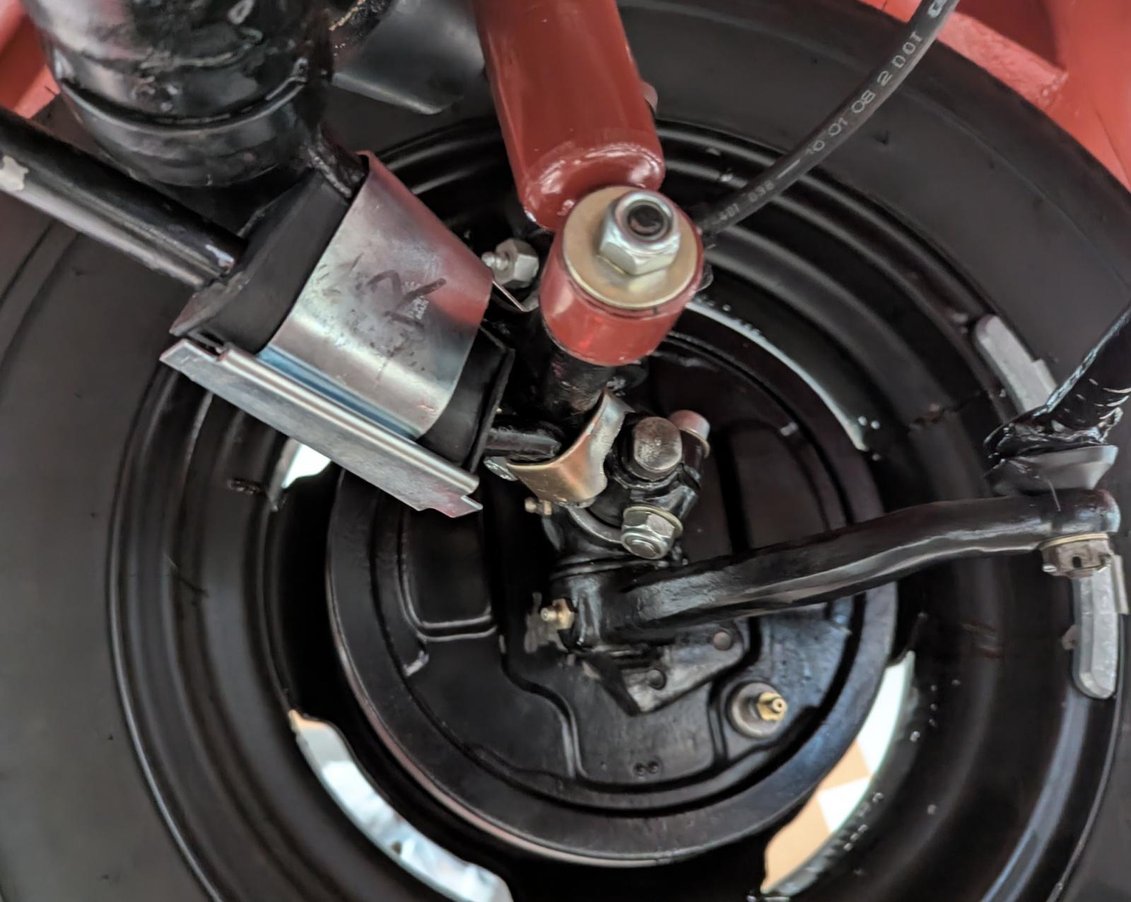

PostPosted: Tue Jan 29, 2019 1:05 pm    Post subject: Re: Sway bar / anti-roll bar on early beam Reply with quote
Quick sense-check before I bend the lock tabs. Do the pictures below look correct? I went with Clara's suggestion of reversing the clamps. I think I'll need to replace the bolts though as they've bent like bananas. I'm a little concerned the bolts will shear in use.
Do these look OK?
It went together pretty well.
Tips for anyone else trying this...
I boiled a kettle and put the rubber bushings in a bowl with the hot water for 15 mins before installing to soften them.
I greased the ends of the bar and the holes in the bushing, so they slid over the flat ends of the bar.
I used big zip ties to suspend the bar and hold it in place while I put it all together.
I filed the edges of the flanges on the big brackets to get rid of any rough edges and greased the flanges and the little locking pieces with copper grease, in case I need to get them apart in the future.
I greased the insides of the brackets and the outsides of the bushings so the bushings wouldn't bind or pucker when I clamped them up.
A pair of channel-lock pliers, followed by a couple of Mole grips clamped on the flanges brought the edges of the flanges together enough that the little brackets slid most of the way on by hand or with a couple of taps with a screwdriver. I only had to use a hammer when I ran out of space for the pliers and grips
Andy
