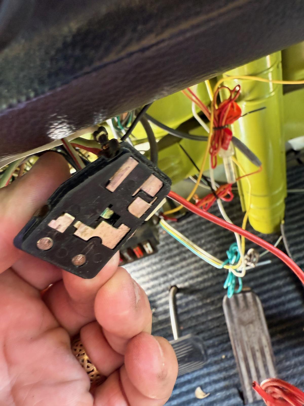

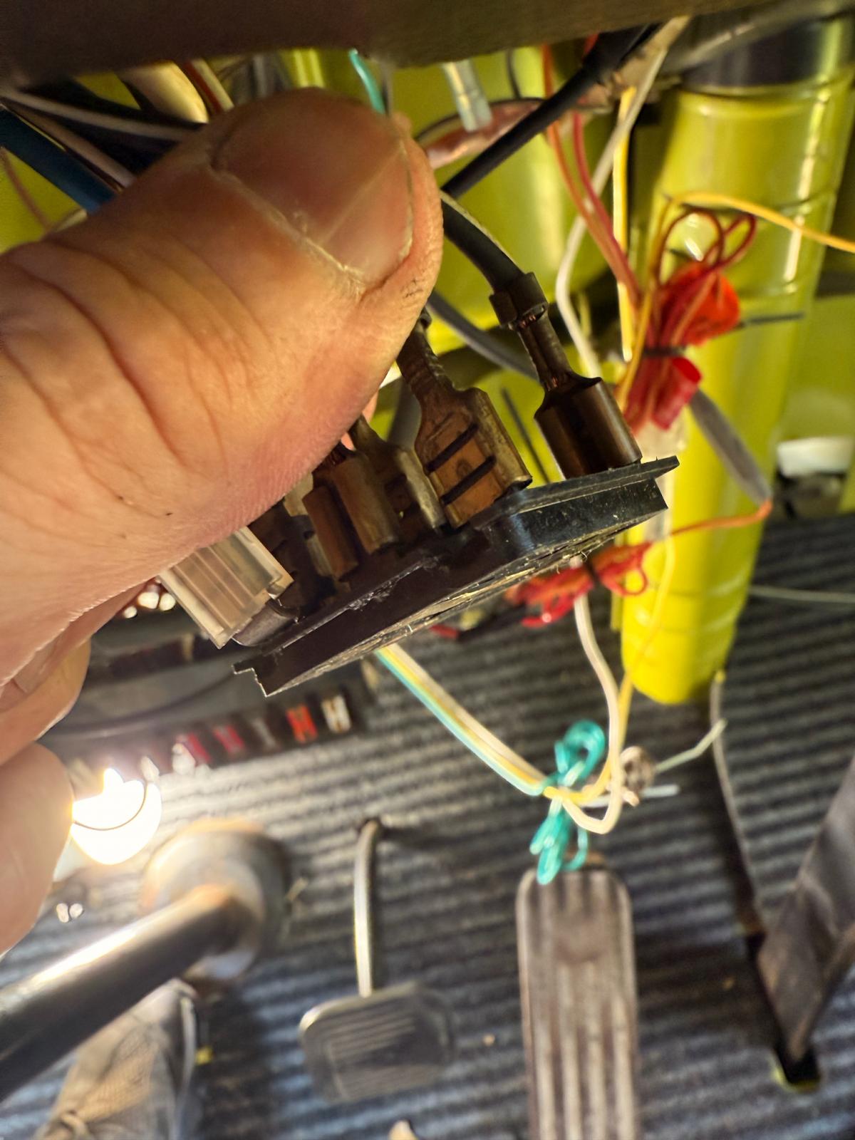

So I checked under the dash and looked where I could zip tip it and that didn't help. (Pic Attached). I found this, don't know th real name for it... But the white lead to the flasher relay on the fuse bus showed no power with the meter. SO I YouTubed some stuff and took a shot in the dark and found power on this little contraption and when I rerouted it to the white lead lo and behold the flashers stared working! Hope I didn't;t screw anything else up! Thanks for the advice or even more advice if I should not have done that!

Contraption not visible, and there's nothing in your gallery, try again please.

Apologies I'm still getting used to picture uploads here.

PostPosted: Fri Jul 11, 2025 6:10 pm    Post subject: Re: 78 VW Bus no Blinkers or Lasers Reply with quote
You did it!, good job!
That contraption is the plastic part of the hazard switch, you got there too late unless both the contacts and thier springs are still stuck in the grease in the switch body.
