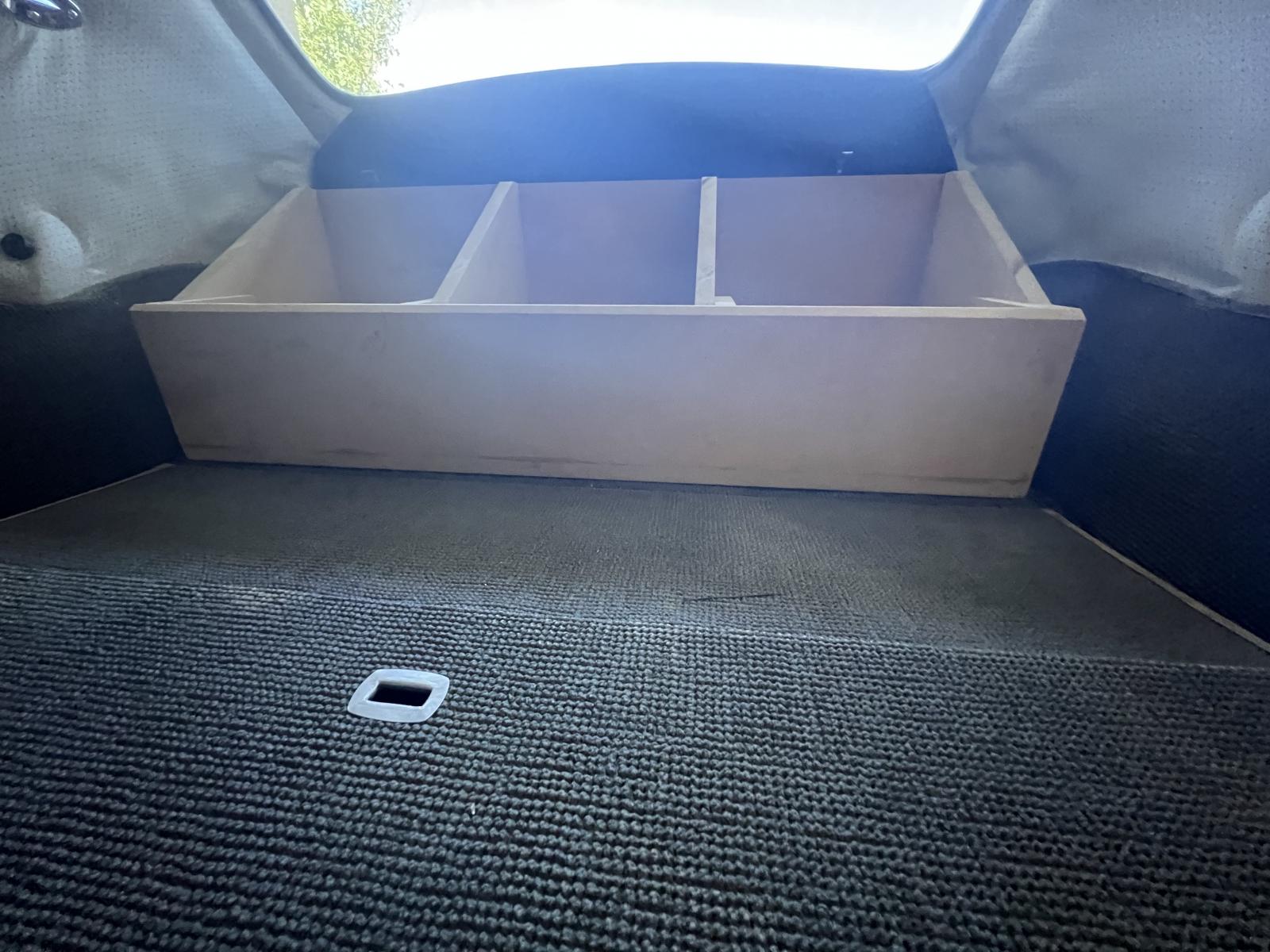

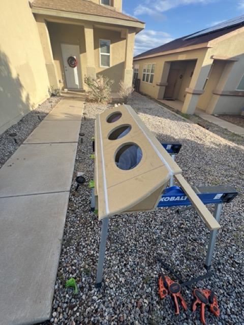

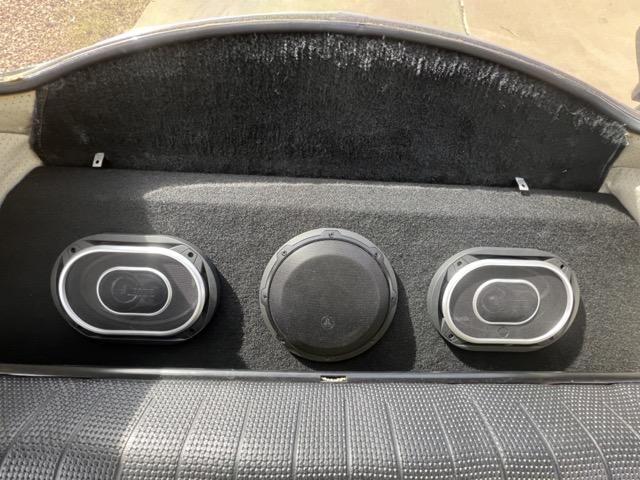

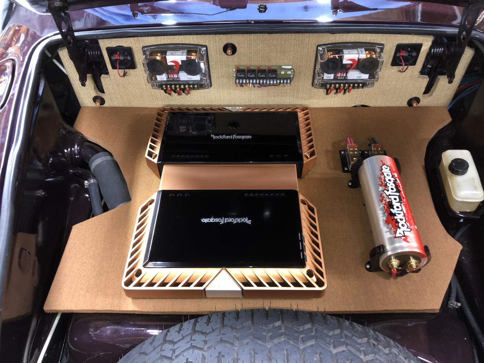

Just got a 1968 VW Beetle and working a rear speaker box for two 6x9 and one 8 inch sub. We have seen a couple builds with a "flat" box across the top, but wanted to try something different.
Hopefully this helps someone with some ideas if your planning on building a box.

Not an automotive audio fife, don't you want some venting?

Dottie, how are you holding the box in? in a bad wreck it could be a missile. A piece of all thread through the bottom of the box and through the body would work.
Great looking though

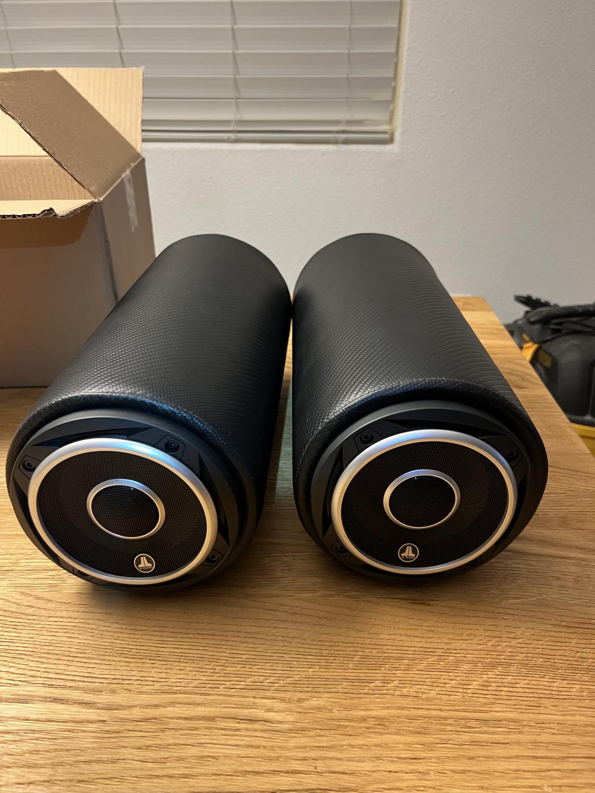

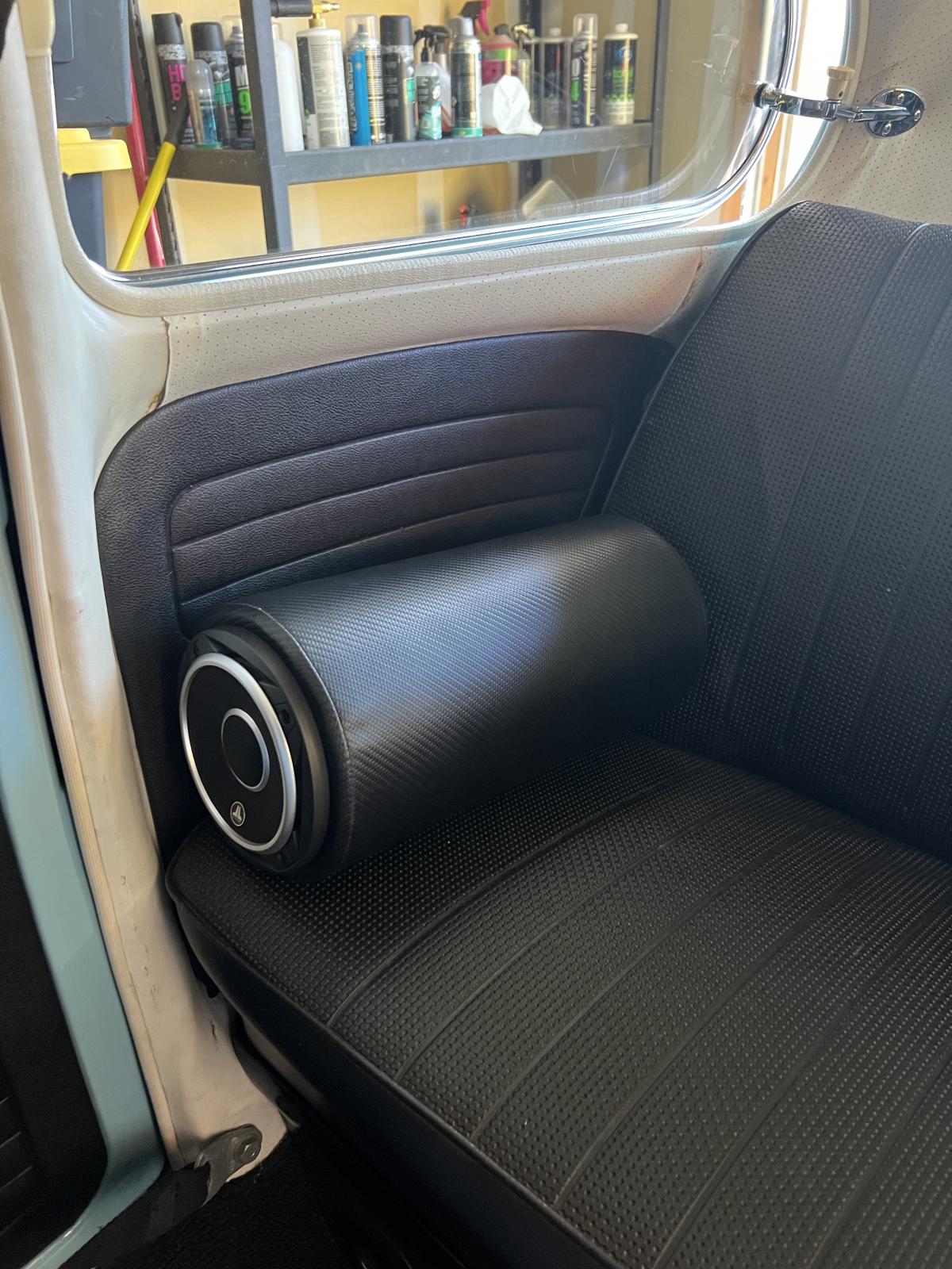

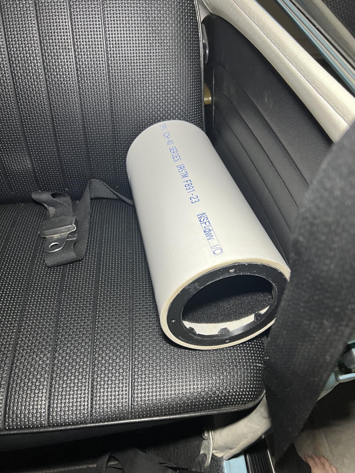

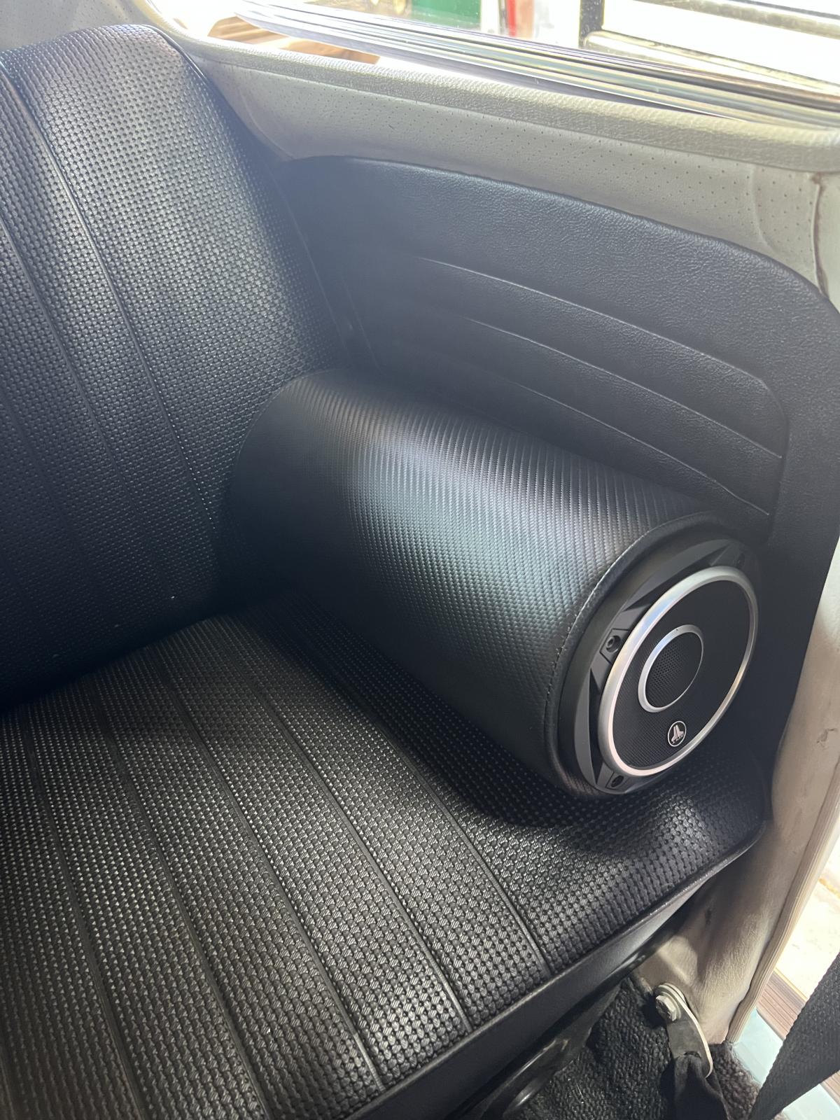

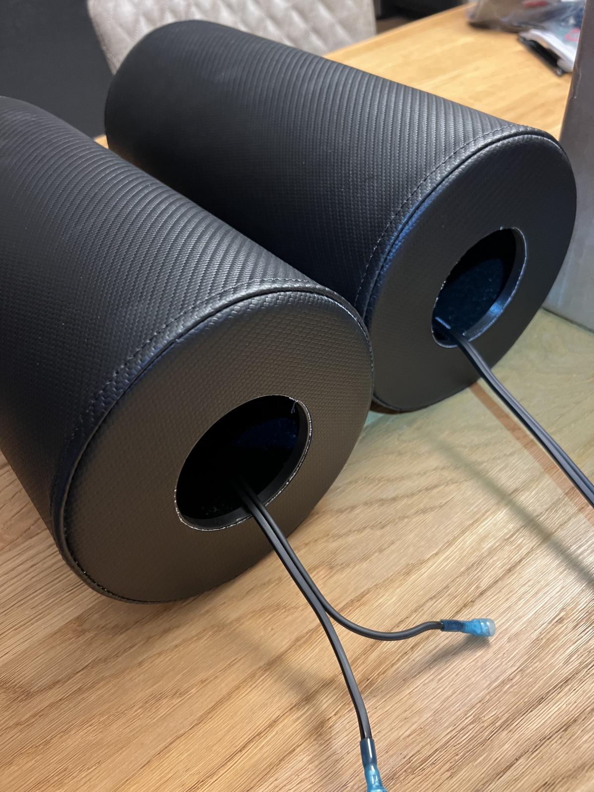

Thanks for the inputs everyone! It sounds really good, and probably over kill in a small bug but its been a fun project. In addition to the rear speaker + subs, I have played with two 5.25 speakers hidden as back seat "pillows".
So far super happy with how these complement the car, it makes everything sound a little fuller - not just like you have your back to the sound.

Yes, I did touch base with a handful of local audio shops with the designs and had them check my work once I was done. Everything does have enough venting or space to prevent things from heating up!
I will be running a connection point to the rear seat belt attachment points - not ideal to link into the rear seatbelt bolt but I am ok with it bc this is not a daily driver + no one will be sitting back there.

Nice work! I love those.
Makes the back seat look like a sofa.

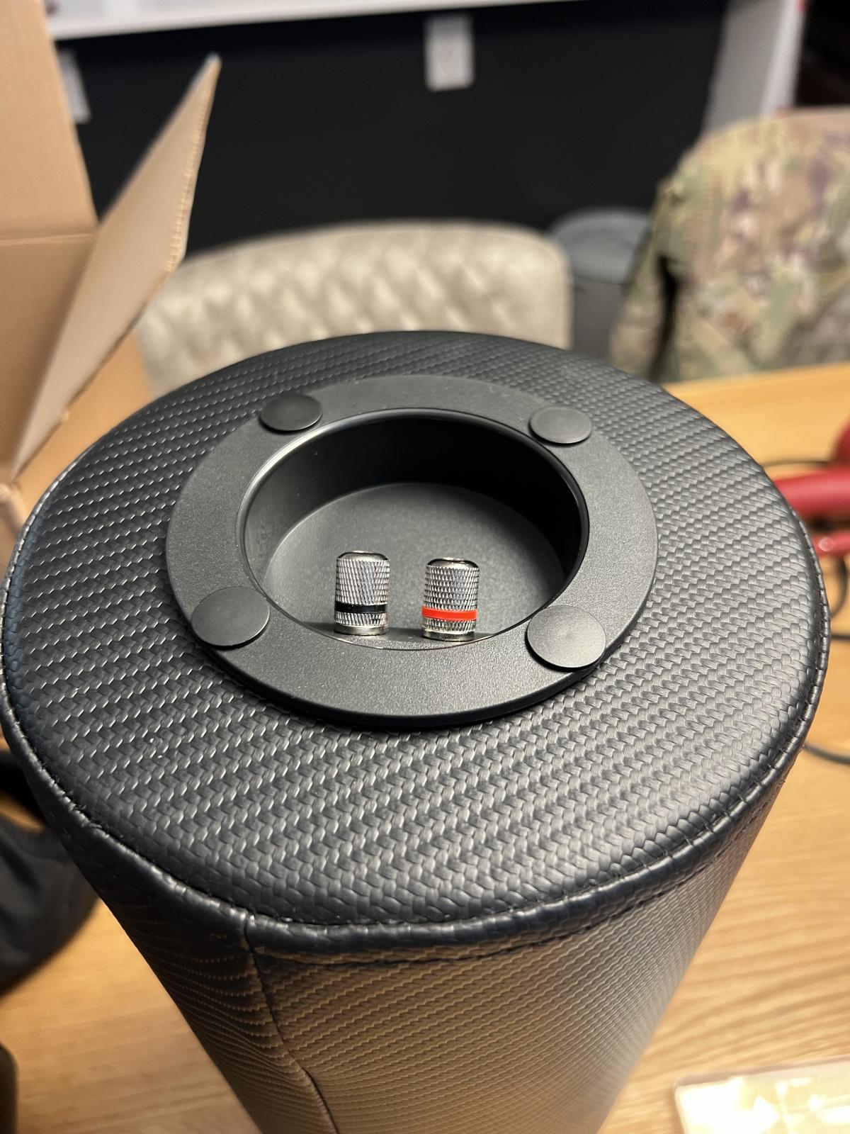

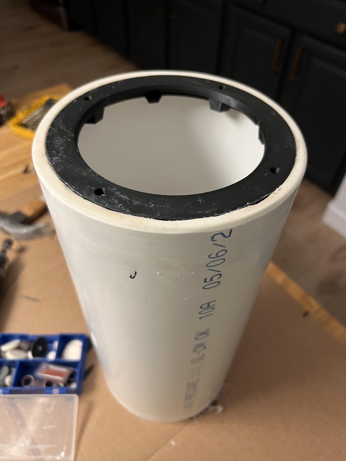

Are the black mounting rings on the ends 3d printed, or ready made off the shelf?
