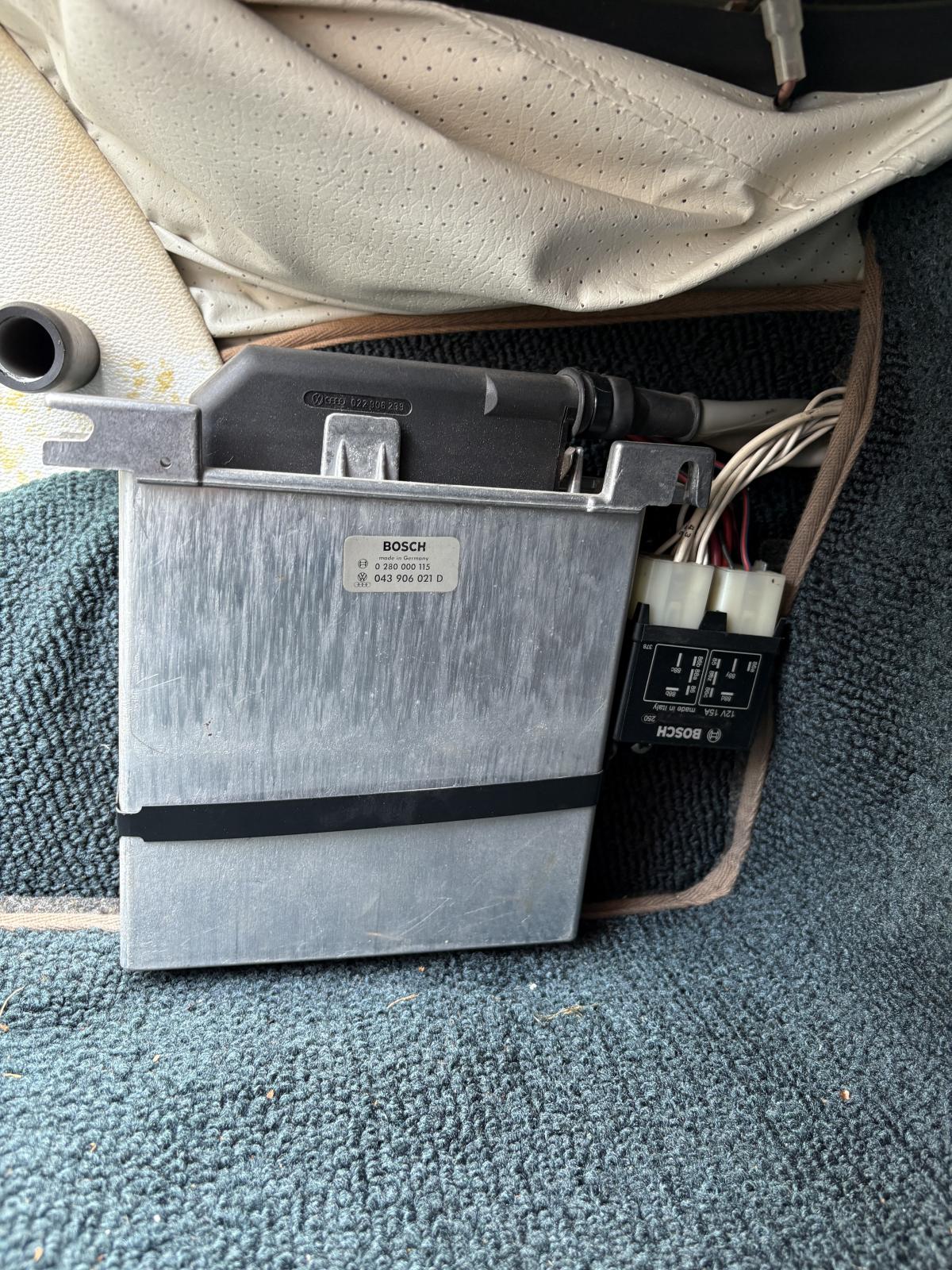

The newest beetle I have ever owned is a 1973 super, so my new to me 1978 convertible has some things I’m not familiar with. I have questions about the things in these pictures?
What is the green dot button?
Is this an amplifier for the stereo?
I suspect this goes in the front trunk somewhere as a cover?
Where do I strap this hook from the rear boot cover? I don’t see an obvious spot.

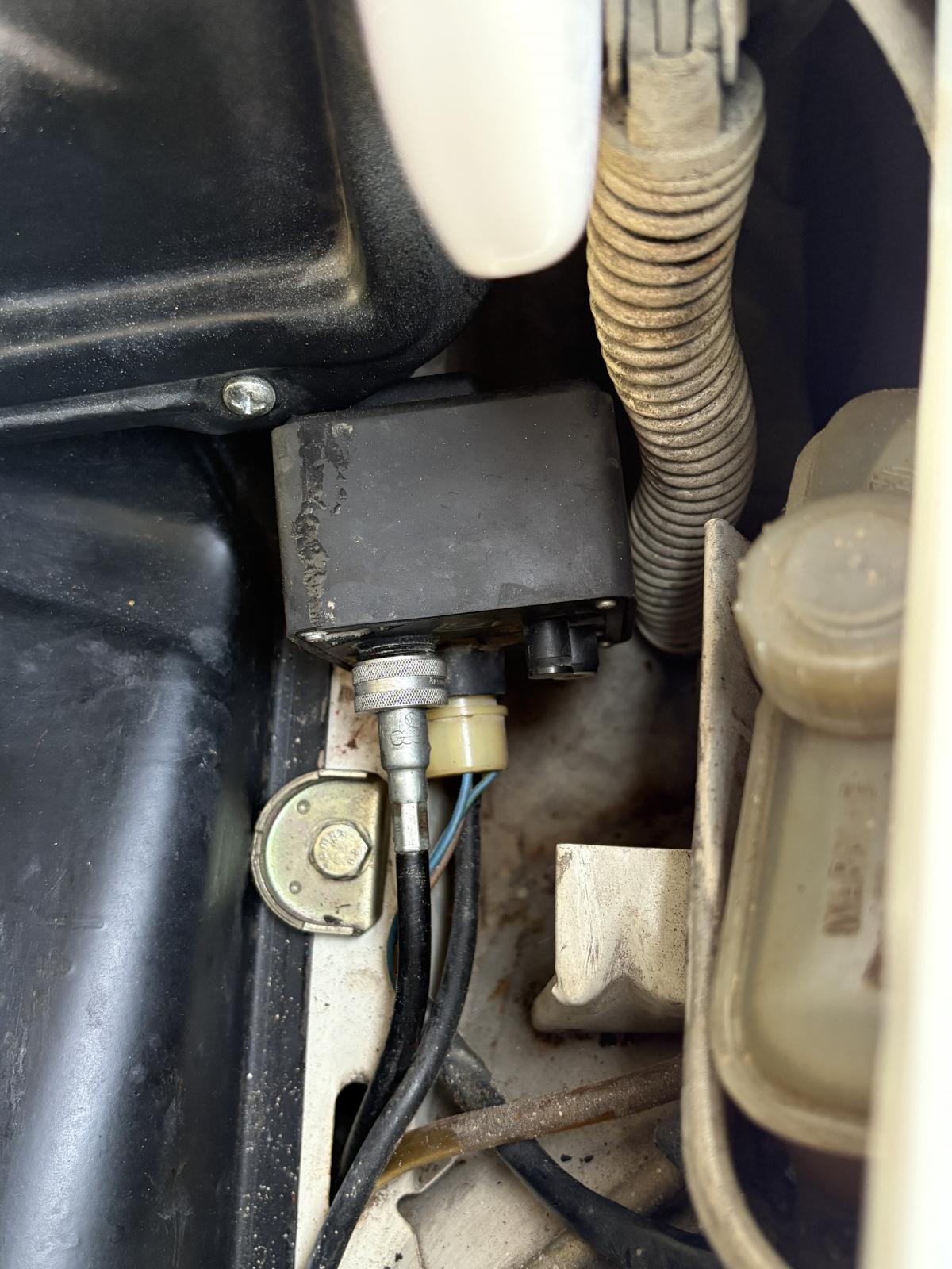

I’m assuming this is part of the speedometer given that the end of that Cable looks familiar, but why is there a box and what is the multi prong plug that is below where the cable goes in? It was unplugged when I got the car.
Thanks in advance for helping a new vert owner

Fuel injection computer
Egr mileage counter om the speedo cable

Is there a gas heater in the trunk?, the mystery switch could be for that.
The cardboard thing is the cover for the fuel injection ECU.
Nice looking car!, let's see the engine compartment.
Learn something every day, when I plugged the EGR mileage counter back in the speedometer started working!
