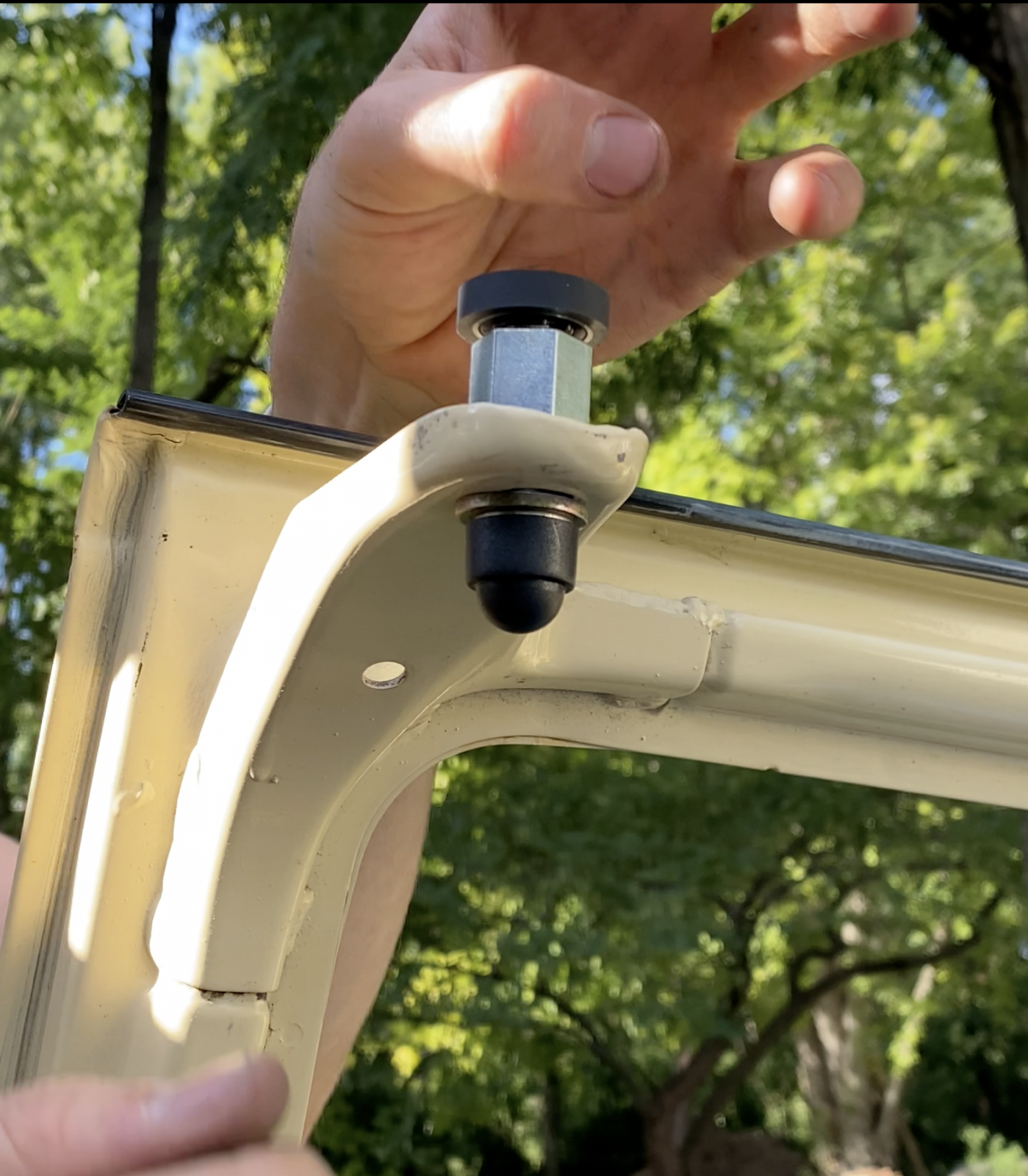

Lower rollers all plastic:

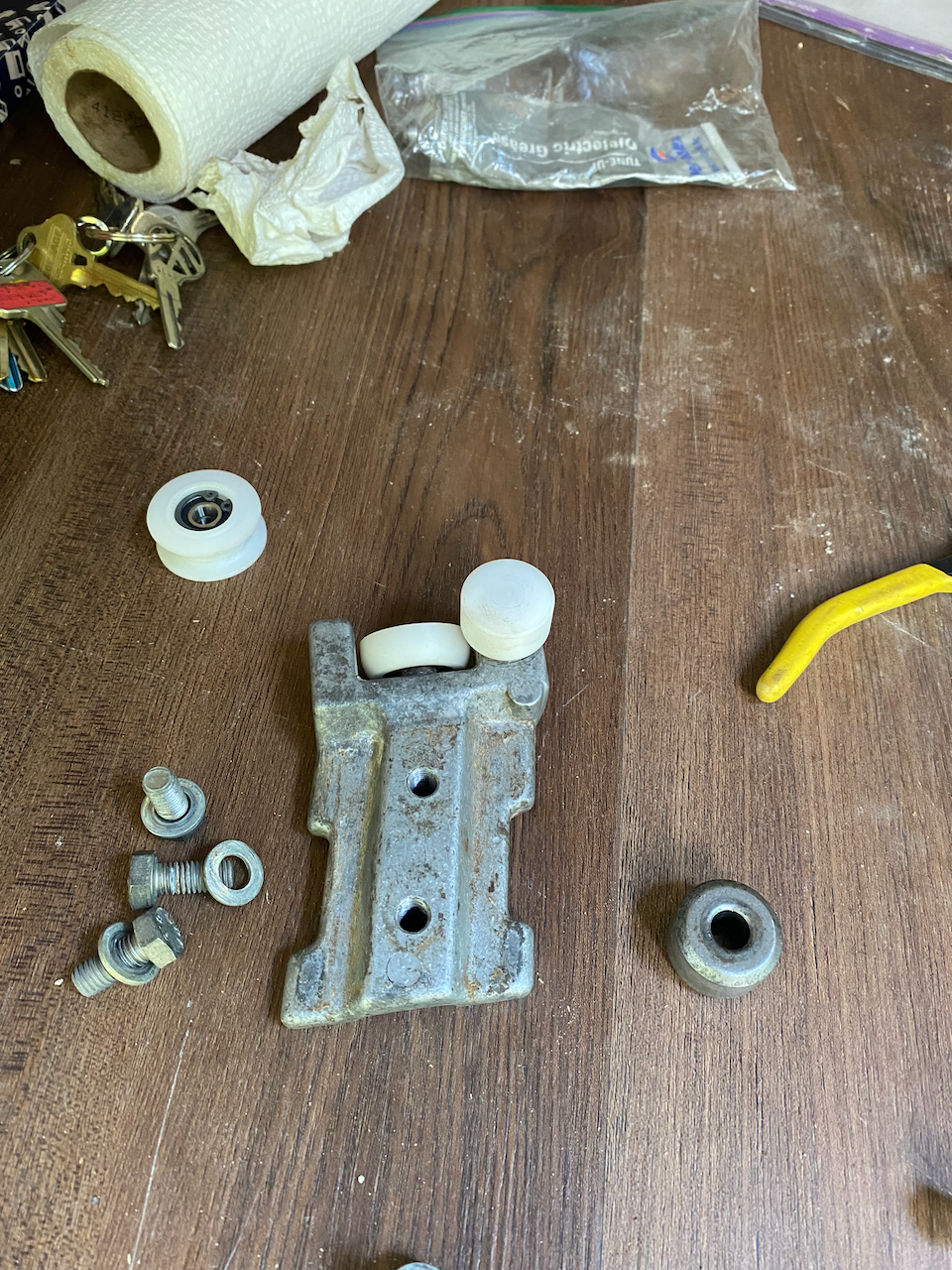

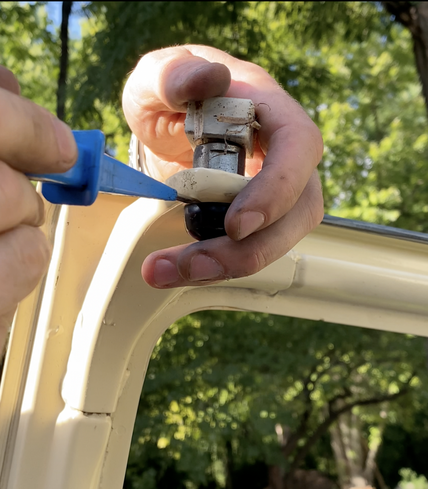

Old upper slider was originally just a plastic block:
New is now an actual roller:

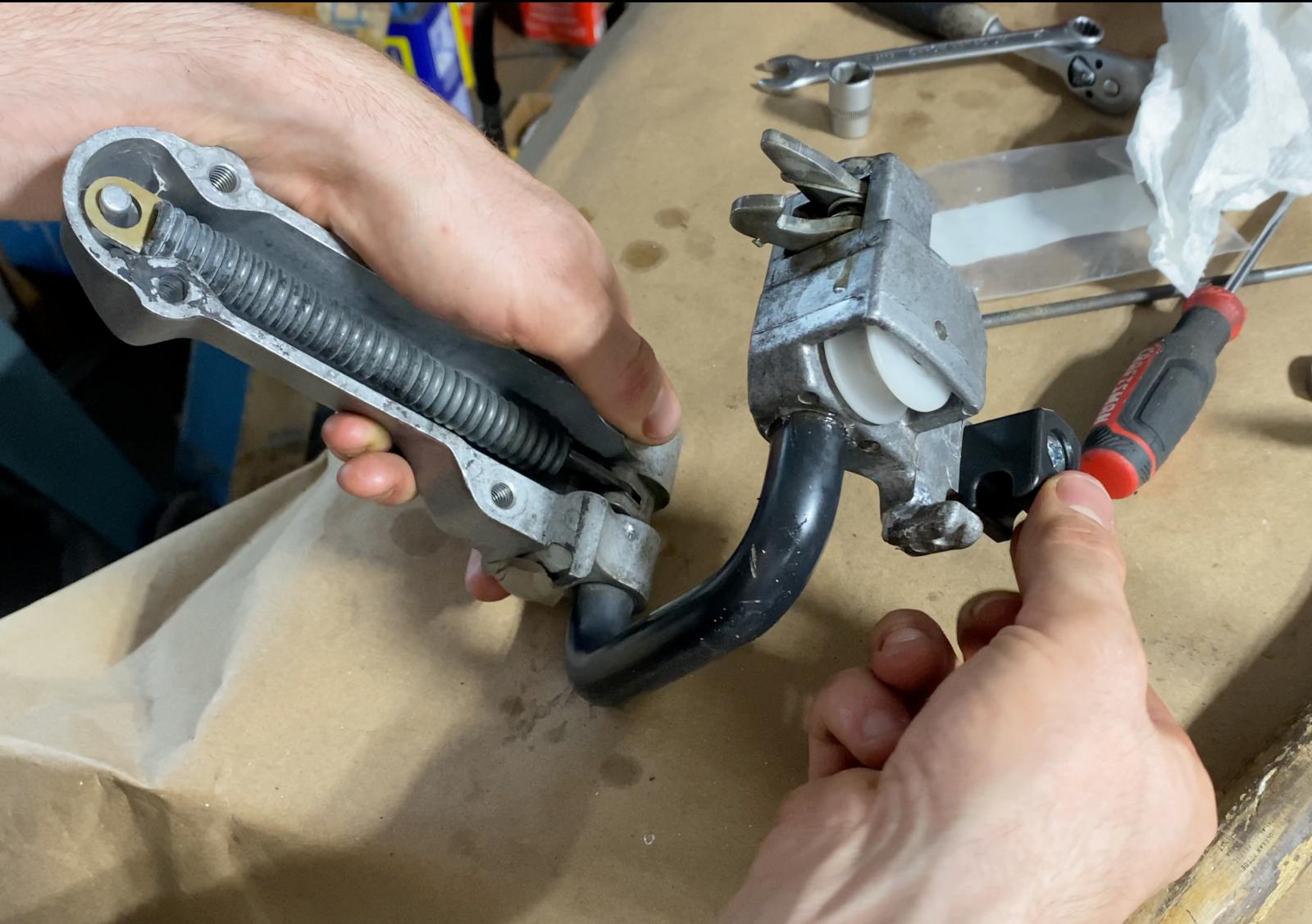

Rear slider and roller with new bearing and new black plastic guide piece:

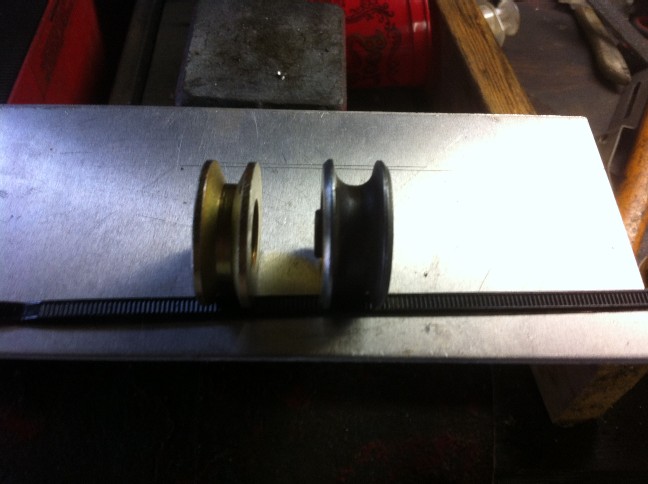

Here is an image I uploaded years ago trying to find a replacement bearing for our 82. The V shaped roller is for a later Van. It was sold to me as what would work. Obviously not.
The U shaped one is original to our 82. It was not available at the time. I cleaned and greased it as best I could and addressed the body channel. My point was that it's nice to see things come to market for the early vans that I did not know are available now. Not how can I quiet my sliding door. Olis Garage has a nack for finding things I have long given up on. I was thanking him.
