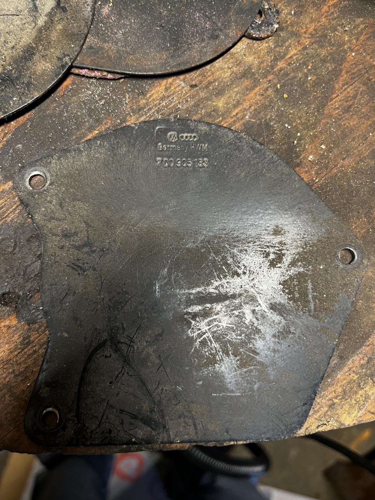

What is this hole in 2003 engine bay?

Located in front of the battery

The diesel models mount their fuel filter there.
This is a gas model, is there a plug for the hole?

That hole is typically covered by a circular piece of sheet metal, and riveted down.
Any idea if this has a PN?

I'd be more concerned about those exposed wires and connectors.

I read the part number as 7D0905133. One is pentagon shaped and the others more circular.
