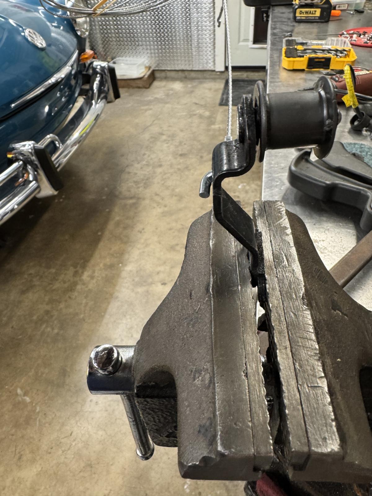

So I've done quite a bit of research on here and Aircooled and had some questions regarding accelerator pedals and attachment of the cable. Aircooled showed a pic of a newer and possibly better Accelerator Cable and the attachment to the pedal. I have been having the same problems as many on here have encountered with the gas pedal sticking or fallen backwards to the rear of the car making it difficult and dangerous while driving. So I had a few questions for those that have made their own or improved on the original designs.
One; Has anyone had any problems by not going with or using the original "Z Bar" design and possibly bolting the cable to the arm? If so, what kind of issues? And can I even do what I am trying to do as far as proper function of a different design? I scrounged around at my local Ace Hardware and found some steel shoulder bolts and was going to try and use what I think would be better than just relying on the the "Z Bar" staying in the acc arm. When I started to take my pedal assembly out of the car I discovered that the Z Bar at the end of the cable was indeed in the arm the incorrect way. As per the Aircooled site. So I switched it the correct way but I'm still not that satisfied with that attachment. So I bought one of the longer cables with the hook on one end and the Z Bar on the other. You're supposed to cut one end off and fish it through the permanent cable tube back to the engine compartment. (All of this was a result to replacing the dual Solex's with dual Webers.) I discovered the SyncLink setup on here that Peter makes and sells but he doesn’t make them for Type 3's unfortunately.
Two; Does anyone see a problem with the setup I'm making by bending the hook all the way around on one end of the new cable and then using the shoulder bolt and washers and nut to secure it all to the acc arm? Has anyone else who has tried this ran into any problems and/or have advice for me? I'll have to cut the Z Bar end of the new cable off to fish it to the engine compartment and don't really like the idea of having nothing on the end that attaches to the Weber linkage in that it will now have the opportunity to fray and someday may cause a problem. Has anyone soldered a barrel nut or something onto the now frayable end of the cable? If so how did you do it and what did you use.
I hope none of this is a repeat of another thread but I did research this for a couple days before I made this post.
So here are the pics of what I'm trying to do. Thanks in advance everyone for your help and/or suggestions. Looking forward to hearing from BobNotch on this and Glutamado especially but anyone's help is always appreciated.
Aircooled site pic of option
This is the shoulder bolt I found to use. It gives the cable loop a secure but loose enough fit so it can rotate.
Last few pics are the original "Z Bar" that I think can be improved on.
I've been using the "Z bar" style set up for over 20 years with both stock Solex carbs, and Dual Webber ICTs. No issues with either one.
I like your shoulder bolt idea, but I wonder if the thick nyloc nut will rub on the carpet or tunnel as space there gets tight. Maybe try it with a low profile nut and trim some off the bolt for clearance.
As for trying to keep the cable from unwinding when you cut the end off, try using an oxy torch to basically ball the end of the cable up. That's what I did when I replaced my throttle cable with a generic cable section. I bought the cable from Mc Master Carr, and got a 100ft roll of it (for 10 bucks), so I can make several cables for the car, and not just the throttle cable. I've used that cable to roto router my fuel lines on my T-34 and a couple of others. It's nice having a section of cable handy. I hope this helps.

By the way, when you were first talking about the "Z bar" I thought you were talking about the bar that connected the pedal to the linkage, where you have the Z bar cable end connected at the linkage. I really didn't care for that set up on my 64 T-34, as I was always worried that one end or the other would come detached in traffic. When I did mine, I used a longer cable and set it up like you did in the pics above. No issues with it, and I drove out to Colorado and back with no problems.

Awesome. I knew you would help me out as I have seen on here how quickly and informative you always are. And yes, I was talking about the Z Bar on the end of the cable. So I’m gonna say if it looks good to run it that way and it’s something you usually do anyways then I’m gonna go ahead and put it in and start driving it again.

Having said that, I would worry about the stock cable to pedal arm connection. I have been using the stock cable in my 66 Squareback for over 20 years and 70,000 miles with zero issues with that connection.
If it ain't broke....don't fix it.
The cable will fray where is goes into the tunnel or through the engine tin long before that z-bend connection is ever a problem.
