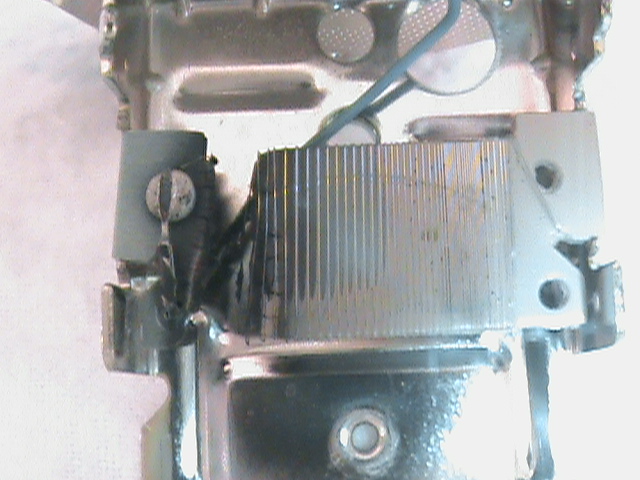

title says it all...
to me a fuel sender is basically a reostat with a contact jumping between wires..
what obvious thing am i missing?

It's not jumping between wires. It's the same wire. Different locations on the same wire.
Kinda like putting both your volt meter leads on the same hot/ground wire. There's no difference in potential.

I'm no electrical engineer, but would venture to guess that it's because the voltage is so low and resistance high in that circuit -- suspect it's nearly impossible to make a spark form/jump in those circumstances. Or perhaps any spark which would form is still too weak and cool to ignite the fuel + air vapor mixture in a gas tank -- ? Those are just SWAGs, though...

Even if it did the atmosphere in the tank is far too rich to ignite:

i get the point, the voltage drop in a single wire turn is too low...or low enough to make absolutely sure it will never create any spark.
Is something that made me wonder always (i did repair fuel senders), thinking that this works in an atmosphere that basically is gasoline fumes...

In any "hazardous location" (as defined by safety regulations) and for every atmosphere (gasoline, propane, etc.) there is a graph of voltage versus current showing the level at which a vapour will ignite. These graphs have been determined in a laboratory and are used as the basis for approving equipment to be used in these locations.
also gasoline will only ignite within a limited range of fuel/oxygen mix. about 1.4% to 7% fuel in the air mixture. again this has all been studied and defined so that limits can be set.

Simply put as busdaddy stated, “the atmosphere in the tank is far too rich to ignite”.
Submerged electric fuel pumps don't cause explosions because gasoline is in a liquid state, and only its vapors can burn. The pump is submerged, which prevents sparks from igniting the fuel. Additionally, the concentration of gasoline vapors in the tank is too high for combustion, as there isn't enough oxygen in the "headspace" above the liquid to create an explosive mixture.

It's more that the spark (if one were to occur) is too weak.
I used to work for a company that fitted data loggers on gas meters. I ran the team that arranged their installation and had to deal with the safety audits.
Their proximity to the gas meter meant they fell within ATEX Zone 0 (the highest rating for explosive atmospheres).
The Meter Operators weren't happy about that. To get permission to attach the loggers to their assets, we had to be able to demonstrate that they were 'intrinsically safe devices' that were certified to be installed in that atmosphere.
That basically meant they had to have been tested to confirm that they couldn't generate a strong enough spark to ignite a gas leak.
Ours were only using a small lithium battery.
I'd guess that a fused 12V vehicle circuit falls below the ignition curves that Finster mentioned above, even given the relatively high current capacity of a car battery.

If you look at a rheostat design, the wiper is larger than the spacing of the winding by a large margin, so there is alway contact between the wiper and wire. The voltages are lower than the threshold for breakdown of air, so thst hazard is comparable to that of a mosquito picking up a hot ember from the grill and flying into the gas tank
