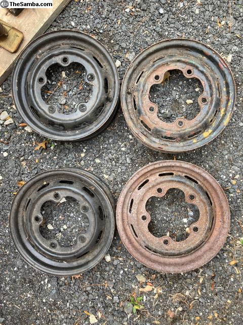

I know that you already have wheels that aren't right for your car, but if you're going for an exact period-correct restoration, you might consider selling those and getting a set of correct '66-'67 wheels that'll take the proper hubcaps.
Swap meets are a good source for stuff like this and they occasionally show up here in the classifieds. You could also put up a wanted-to-buy ad over there.
There's an old ad for a set that's still up...might still be available > Used Wheels
Brand new '66-'67 wheels are available on eBay but they're expensive ($250 ea) > New Wheels
