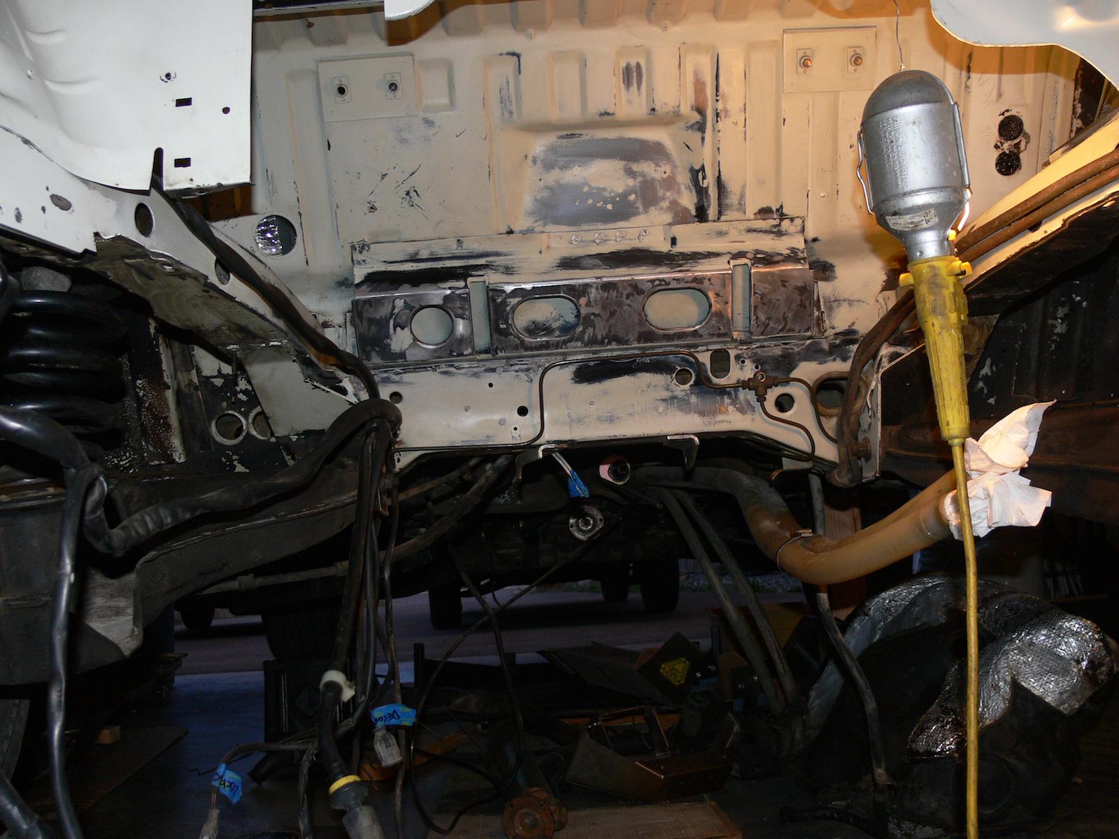

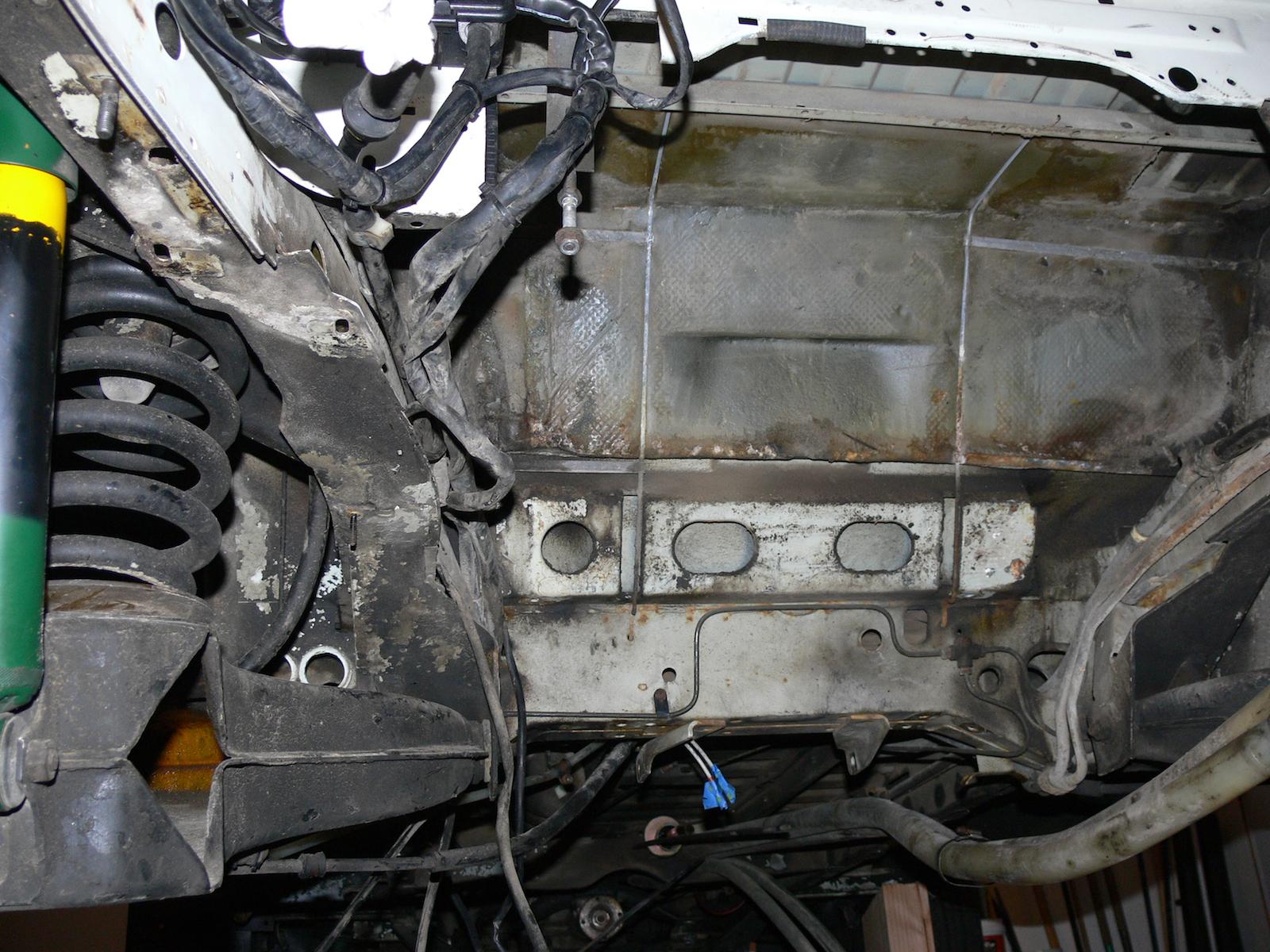

Can't offer any help on replacing that section of brake line in-situ, but here are a couple pics showing the brake lines behind the fuel tank to give you an idea of the layout.
And by the fuel pump:
Before digging too deep a good look at the clutch hardline and it's connections is definitely worth it (along with checking for a bad clutch slave).

Looking at the pics (which are SUPER helpful BTW!) I am thinking I need to drop the engine and trans, and might as well R&R my gas tank as long as I am in that far. This is indeed my syncro westy which has a group 7 Bostig in it.
