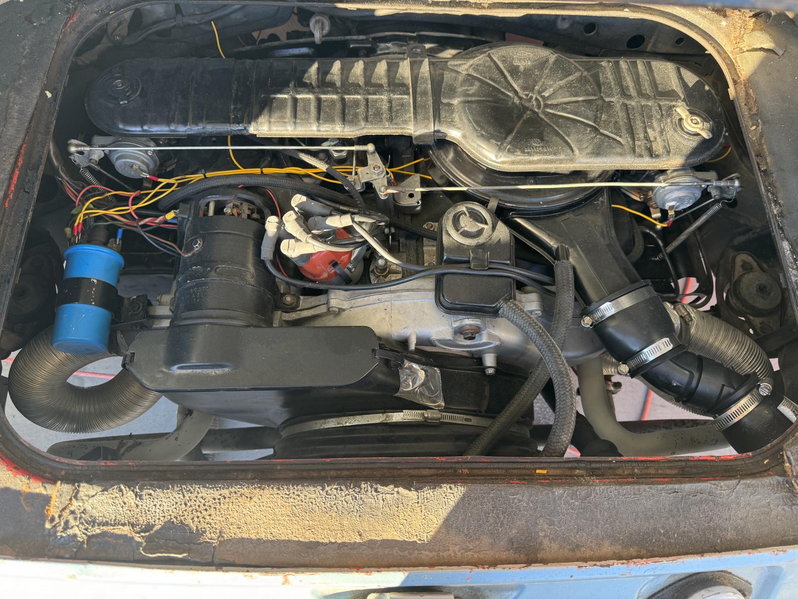

Turns out the bulk of the parasitic draw was coming from one of the brake light switches mounted on the master cylinder. One was completely shot, and the other was shorting out and grounding itself. I’ve replaced one, and the other is temporarily disconnected until I can swap it out.
For quick drivability, I went with a readily available “stock” Solex setup. Eventually, I’ll track down a complete FI system, but this gets me rolling for now.
The Solex setup is paired with a vacuum advance distributor, and I also added a momentary switch to act as a “kickdown” switch—visible in the photo.
I’m aiming for a more stock-style setup with an enclosed air cleaner to help manage engine bay temps, especially in this Arizona heat.

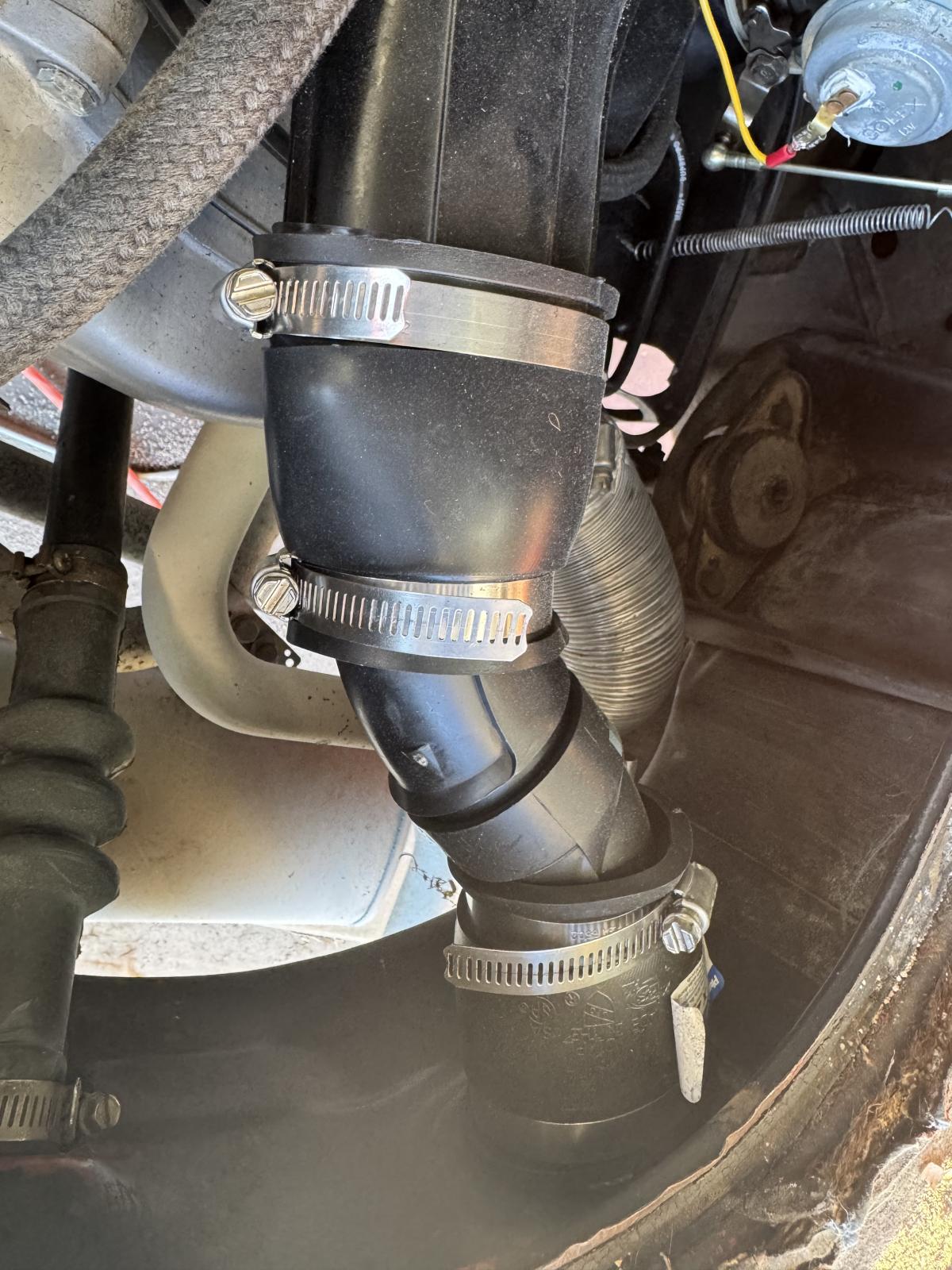

And for a laugh… check out my temporary fix for the fresh air control box. I haven’t ordered a proper replacement yet, but my hardware store solution is holding up surprisingly well. It’s just ABS plumbing—functional and ridiculous!
Here is the before and after of the carbs/dizzy... the ABS Plumbing fix and the Kickdown switch
BEFORE
AFTER
ABS Plumbing "fix' for the missing control box
Kickdown Switch

NerdyGunny wrote:
Thanks for the input—much appreciated!
Kickdown switch
BEFORE
AFTER
Kickdown Switch
As long as it works, is it wrong? I was more worried about you using the ABS elbows on the cooling air shroud to heat exchanger connections. I only say that as when they get warm they could pass gases from the plastic into the car. Not good for the occupants of the car.
On my own car, I have two FI boxes pushed together to make up a longer one. It's been on the car since 2002 when I put the Solex carbs on it after removing the Weber ICTs. While it's not correct, it does work, and the FI parts were easier to find.
Bob 65 Notch S with Sunroof
