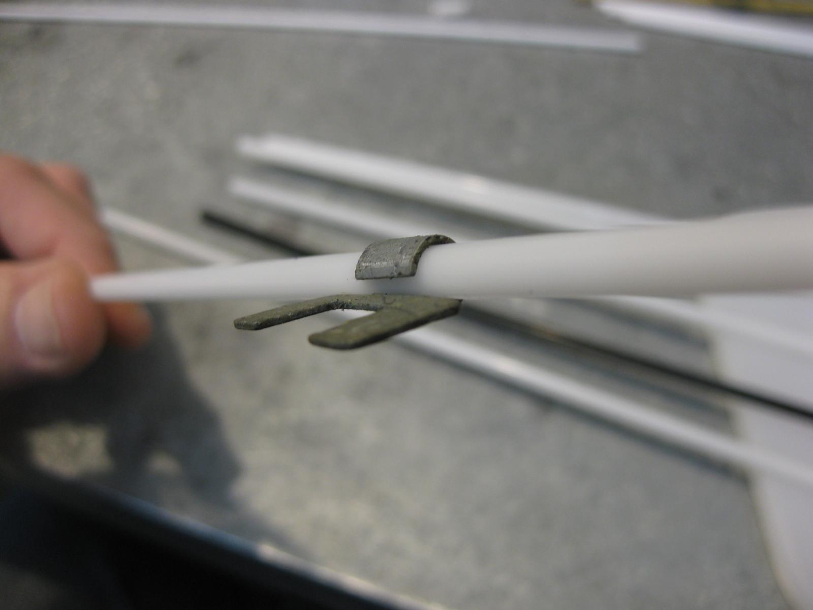

50 years of time causes embrittlement and decay of the cable tube for the rear footwell heat vent. Here is how I repaired them.
[Note: The parts shown are for my 69' squareback and 69' fastback projects.]

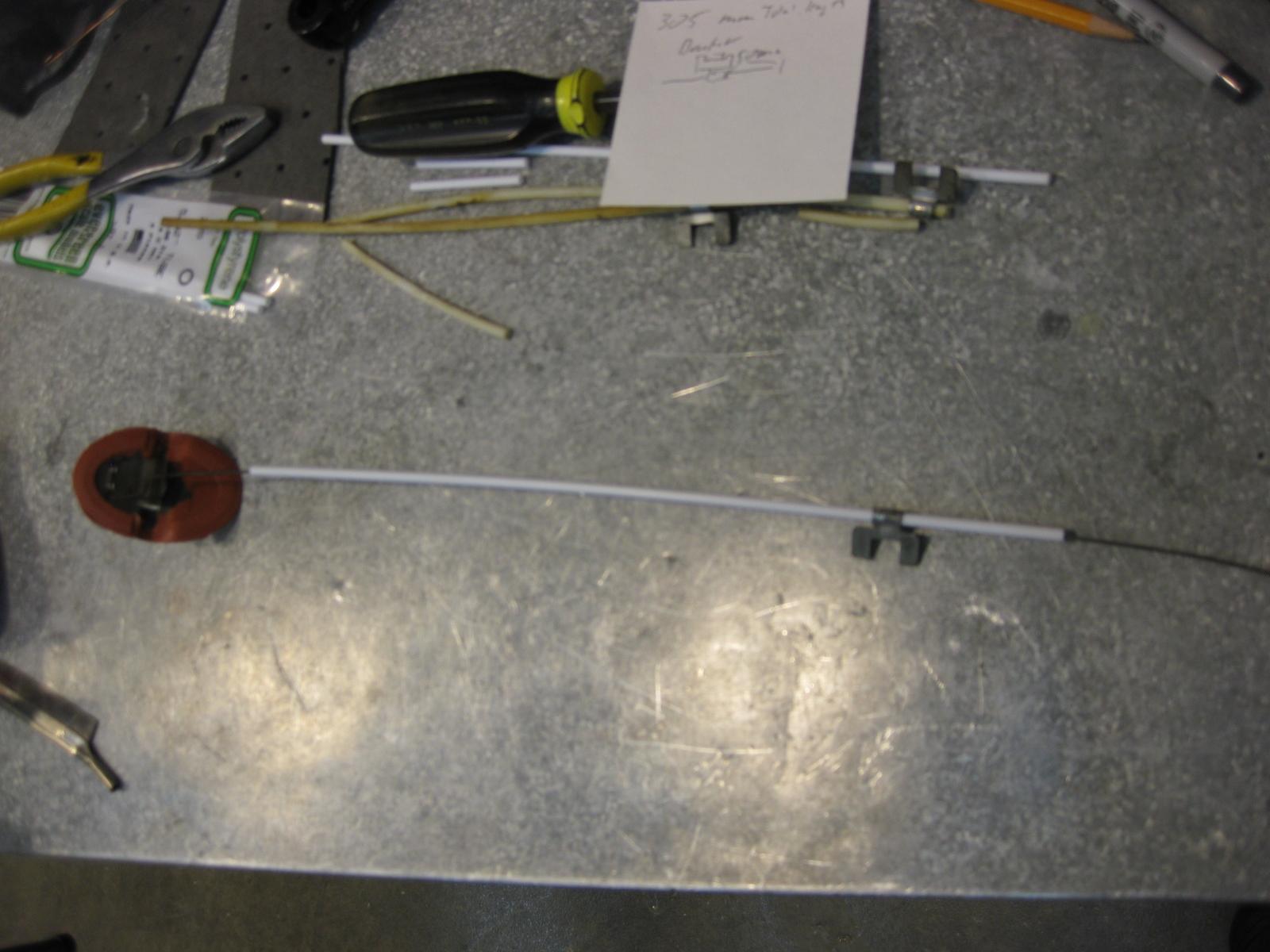

I took a couple measurements of my broken tubes, and then found this at my local hobby shop.
So here we are laid out to do the repair.
First, a good cleaning of the flap and cable. I used Griot's Rubber cleaner and a soft nail brush to clean up the rubber on the flap, and then treated it with Griot's Vinyl & Rubber Dressing.
Then used steel wool to polish off any corrosion on the cable.
(Not advertising for Griot's. Point is to use a cleaner compatible with rubber and then a treatment to keep it good.)
[/img]
For my 69', the tube is 305mm in length. I cut the tubes to length using an xacto knife. Holding the clip in the vise, I was able to use a flat blade screwdriver to gently pry up the clip to release the old tube. Slid the new tube in, leaving 50mm of the tube extended from the clip. And then a set of pliers to gently squeeze the clip back down onto the new tube.
First one all done. Three more to go.

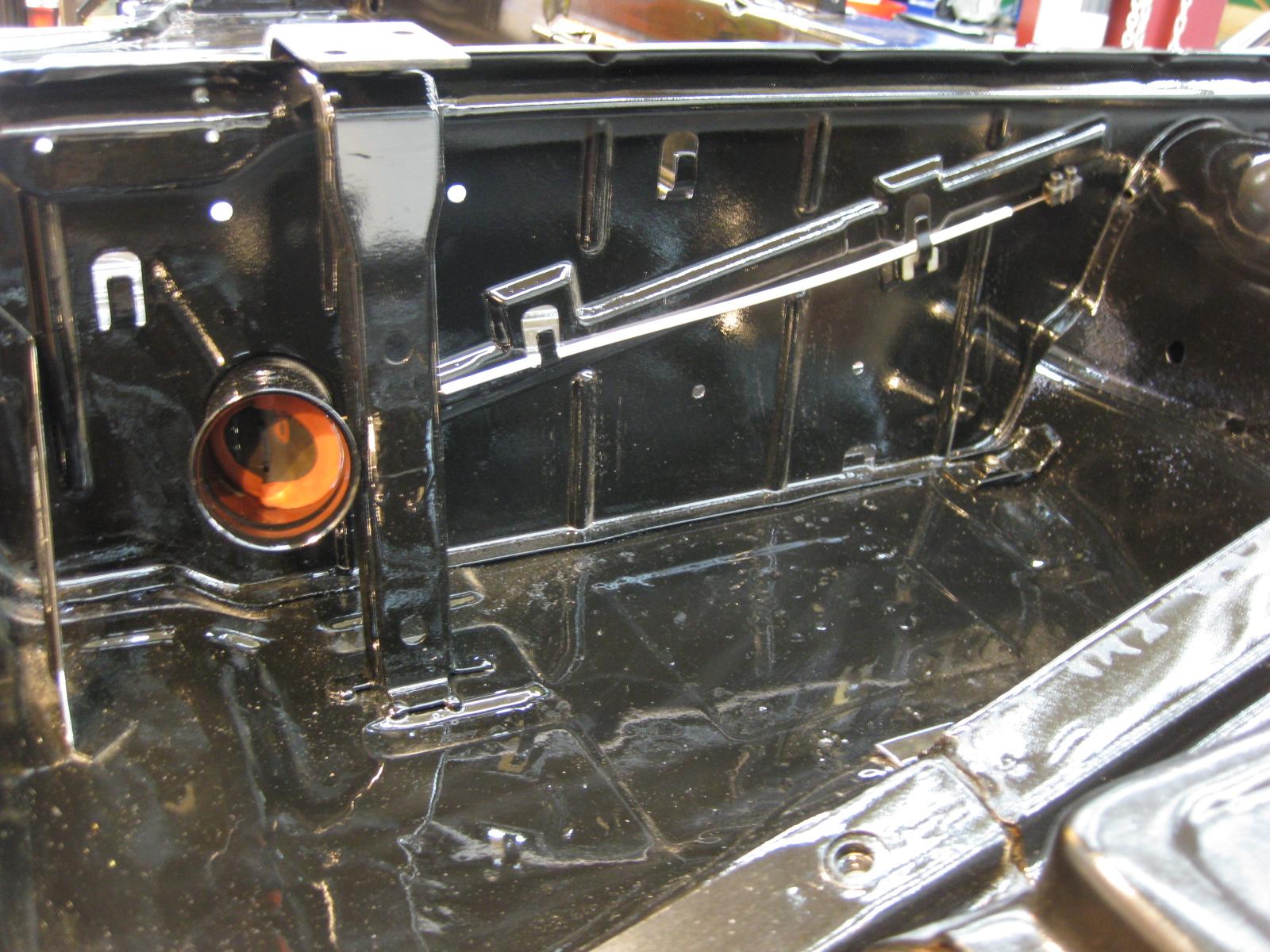

Installed on the squareback pan.

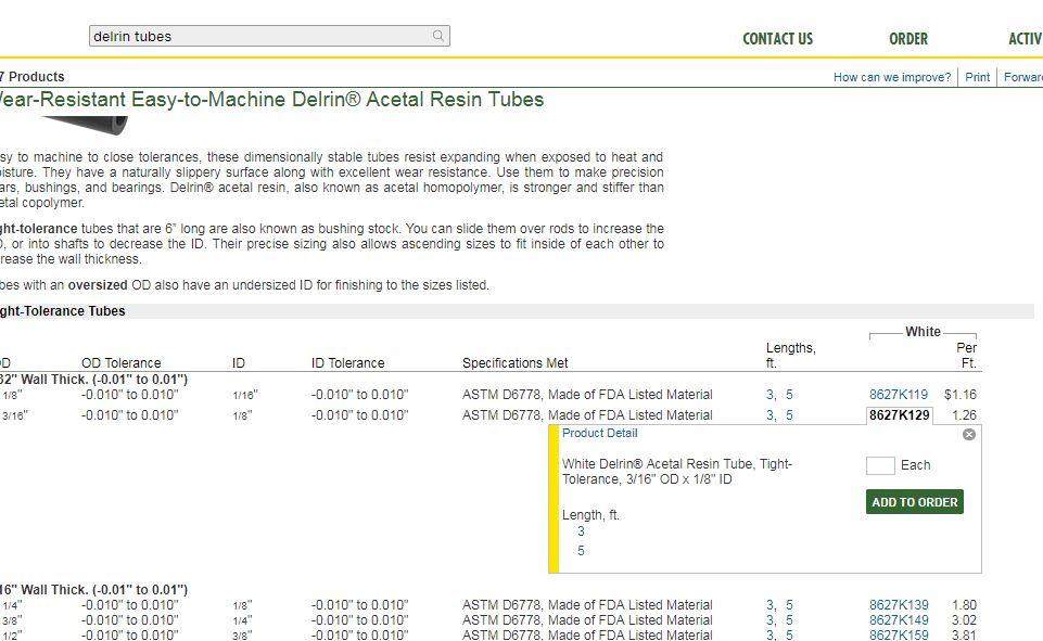

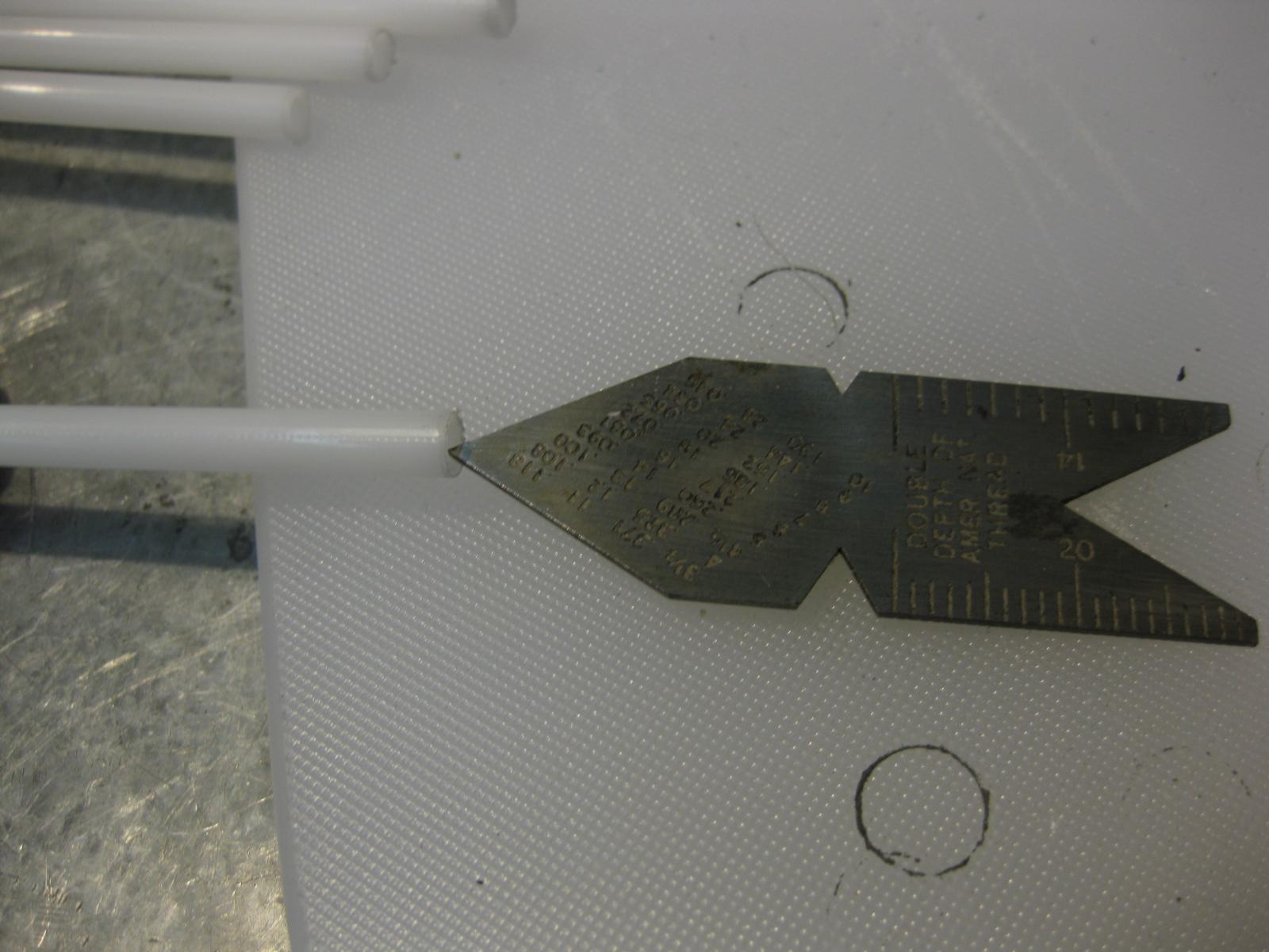

So, here is the update with the correct material. I ordered a 5 foot section of "White Delrin Acetal Resin Tube, Tight-Tolerance, 3/16" OD x 1/8" ID. McMaster-Carr part# 8627K129".

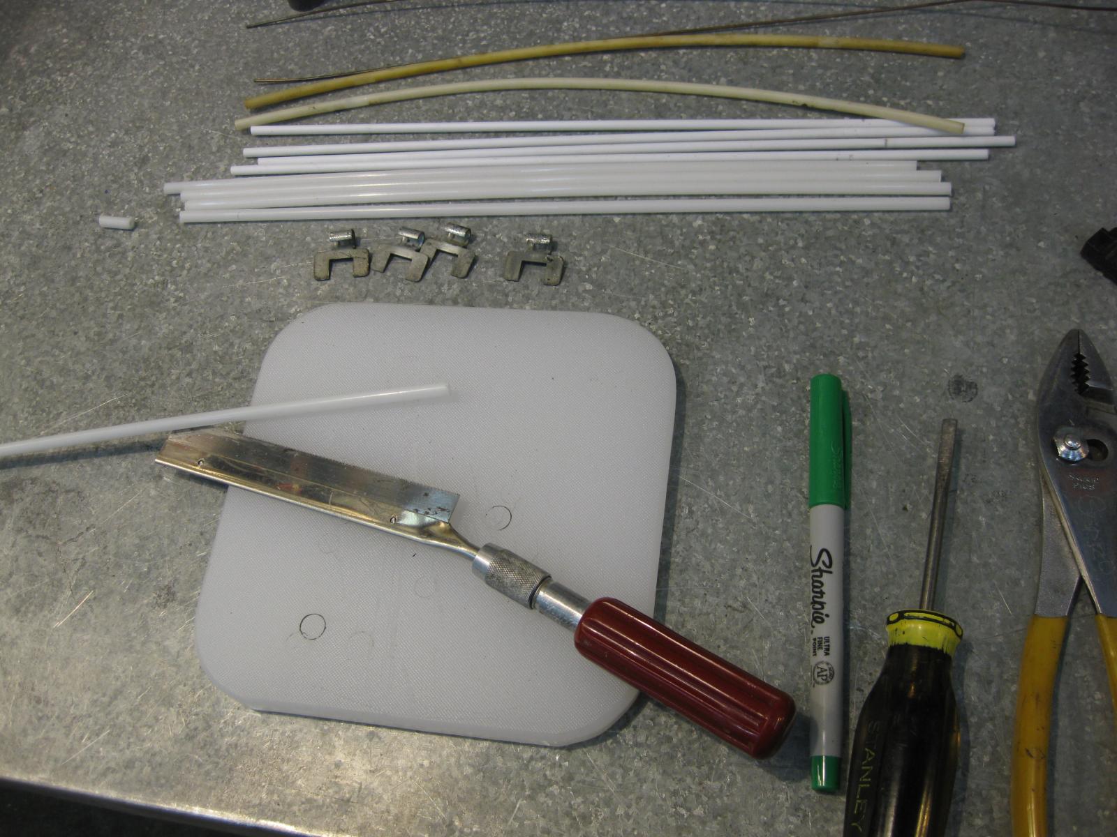

A little tougher material so I used an X-Acto fine tooth saw blade to cut the lengths
and then a tool from the tool box to deburr the ID.

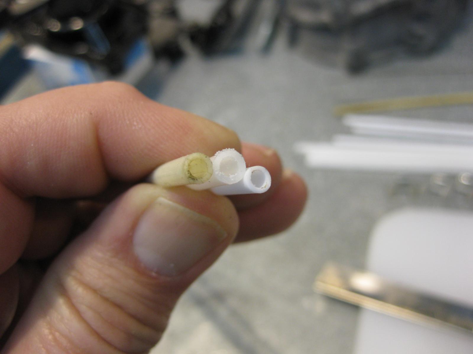

Here is a comparison of the materials:
Original on the left, the Delrin in the middle, and the polystyrene on the right.
The OD of this material is slightly larger than the original so it requires some finessing of the bracket to open it up without bending/damaging the bracket.
But the task was accomplished and the bracket was successfully crimped onto the Delrin material.
I was able to get 5 tubes from the 5' stick.
This picture shows:
4 poly tubes (the wrong stuff).
A 3/8" left over chunk from the 5' delrin stick.
2 original tubes
1 extra Delrin tube
The 2 assembly's using Delrin for the fastback
An assembly from a '73, which is all plastic type material, no metal bracket.
And the two assembly's for the squareback are installed on the squareback pan.
