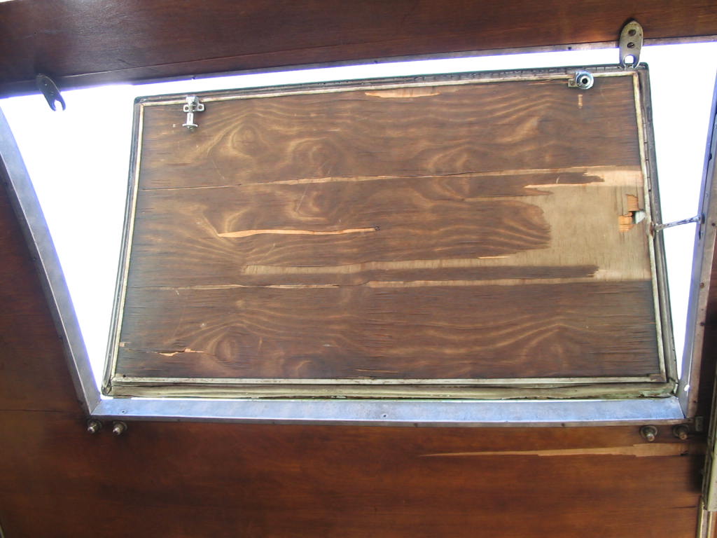

Looks like someone went to town with the dark stain on your interior. Your bus is an SO33 so would only come in a single interior wood color/layout.
Here's a pic of the piece you posted:

No stove and no chemical toilet came with it. Probably long separated from the bus. A piece of awning came with it, but not much and no poles.
The cabinets and panels all appear to be there. Most pieces are in good condition. I may try stripping the finish in an inconspicuous area. If the stain is only in the top layer of finish, it may come off well. If the stain was applied separately first and soaked into the wood pores, it likely won't come off well.
Am I correct that Westfalia used a type of birch veneer/plywood for the wood surfaces that show? Making all new woodwork for it sounds like a big project; if that is the only way to replicate the original finish, it will be tempting to leave the dark finish in place.

I'm still in the thinking stage on what to do with the woodwork; very open to suggestions. In an earlier career, I built furniture and cabinets. Not the ultimate expert, but I do have an idea of the challenge involved in restoring the woodwork to its original appearance.
A search on European pear wood turns up veneer but no sheets of thin plywood. Maybe someone know of a source. It is infinitely easier to work with sheets of plywood than to laminate a thin layer of veneer to a ply wood base.
The European pearwood used in these buses may not be that different in grain from other woods without a strong grain, like Baltic Birch, which is available in various thicknesses of plywood. It may not be all that difficult to stain that wood to something very close to the correct appearance.
Of course, another option is to leave the wood dark, making that change part of the history of the bus.

I would just leave it especially vs. changing it to an incorrect wood/veneer. That would be a shame. Cool bus.

There are a variety of colours in the plaid used in the SO-33 era.
https://www.thesamba.com/vw/forum/viewtopic.php?t=730513&highlight=plaid
I am not 100% sure if certain plaid colours were used with certain paint colours.
If there is original fabric on your bus, it is probably original to the bus. Generally it gets worn and often is replaced, or just covered over.
Not all colors were reproduced, so that can affect what goes on there.
Taking the cabinets apart, carefully scraping, re-finishing is a lot of work. Re-assembly is a lot of work. Cleaning the plastic trim, re-installing it. fitting the doors. fussy. Don't lose the pieces.
The hinges were copper plated, but often the copper gets worn off. Be careful when cleaning them. The copper hinges look beautiful with the lustrous wood.
Scraping is the way to go, not re-veneering.
