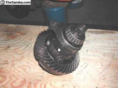

PostPosted: Fri Feb 10, 2006 3:27 pm    Post subject: Reply with quote
Here are two pics I found of the diff...

PostPosted: Fri Feb 10, 2006 6:48 pm    Post subject: Reply with quote
I think the big issue for a lot of people will be cost. Any idea of how much $$$?

PostPosted: Fri Feb 10, 2006 7:35 pm    Post subject: Reply with quote
I think Gary said it would be under $800. However, there were only 1 or 2 people that ever contacted me about it, so it hasn't ever gotten anywhere. Someone could rig it up themselves, if they had some experiece working on trannys, diffs, lockers, etc. To be honest, I'd love to have one for my rail, but $800 would get a lot of other upgrades that would be more rewarding than a locking diff.

PostPosted: Fri Feb 10, 2006 8:42 pm    Post subject: Reply with quote
http://www.richmondgear.com/01pdfs/ptrax.pdf
Lock-Right locker
1310 V.W. IRS Bus or Vanagan 2-Pinion $235.99
1311 V.W. IRS Bus or Vanagan 4-Pinion $260.99
That's a big price difference for a Lock/Unlock button!
And if he's doing a custom adaptation, for god's sake don't use a stock diff! Use an ARB or somehing that can take some power. I wouldn't even consider $800 to use stock parts.
