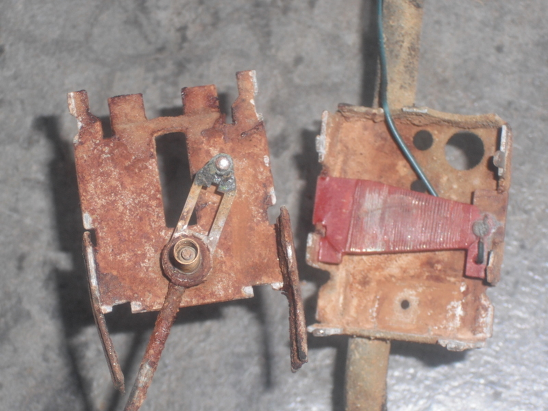

On my Syncro the guage didn't work. It passed the guage wiring test by jumping the sender wires. When I took the sender out, it was covered in "crust".
Most flaked off with a little scraping. I used some 600 grit to sand the button and do a light clean on the reostat wires. I put some down tweek in the button arm. After reassymbly, I tested it for variable resistance and had some, so I thought it was close enough. It works perfectly now and I make sure to keep the tank fuller now. At $150 replacement, I didn't think I had much to lose.
