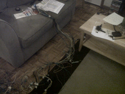

PostPosted: Fri Apr 02, 2010 9:46 am    Post subject: Reply with quote
I started the wiring harness this week. I'm about 5 hours into it and probably half way done. Really easy work. I read lots of horror stories on here and the subaru vanagon list about this part of the job, but I'm finding it to be pretty painless... just time consuming. hopefully i don't eat those words at startup time... but I'm pretty confident in my harness work, assuming everything in smallcars wiring "kit" is correct.
I've also decided to sell the complete auto KEP kit and buy the KEP manual kit with the funds. I'll actually be saving money doing it that way, and I won't have to deal with sealing the notch on the bottom of the auto adapter.

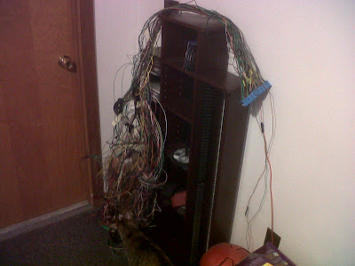

PostPosted: Sat Apr 03, 2010 8:20 pm    Post subject: Reply with quote
Finished the harness last night. Not bad at all. It only took two Celtics games (one OT).
this is all the excess wiring.
