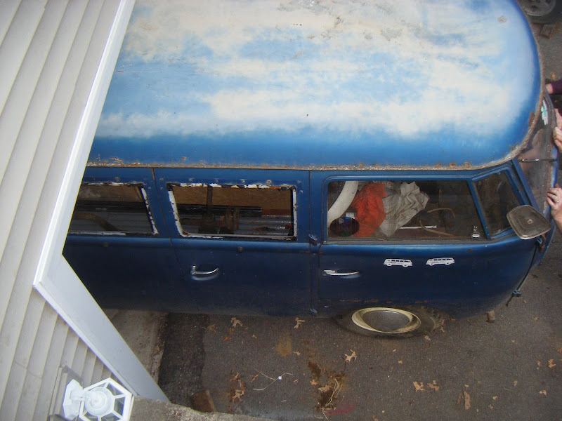

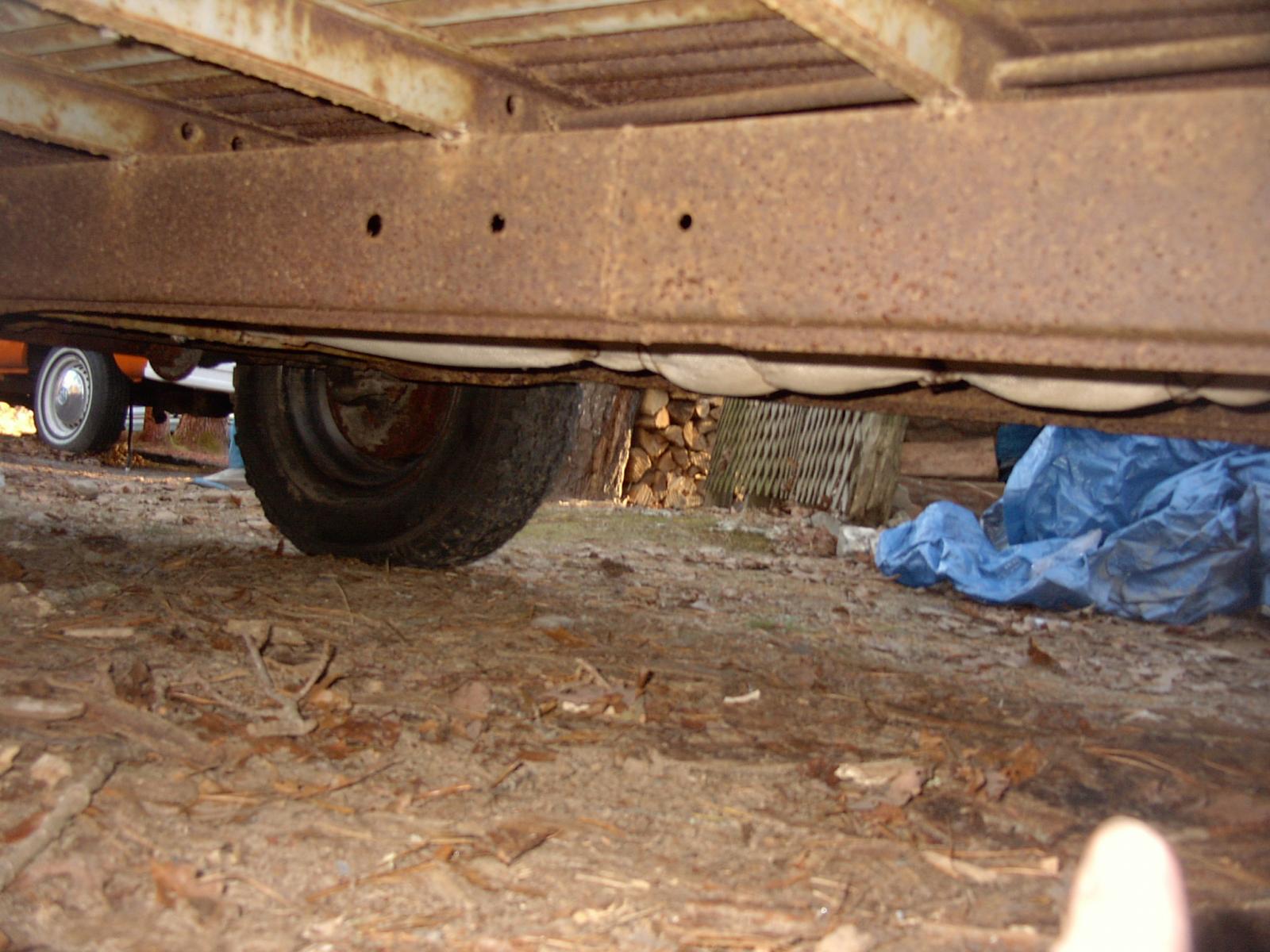

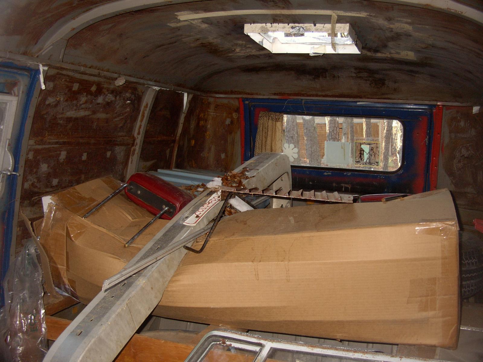

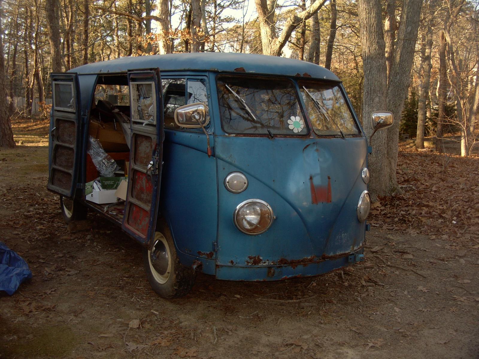

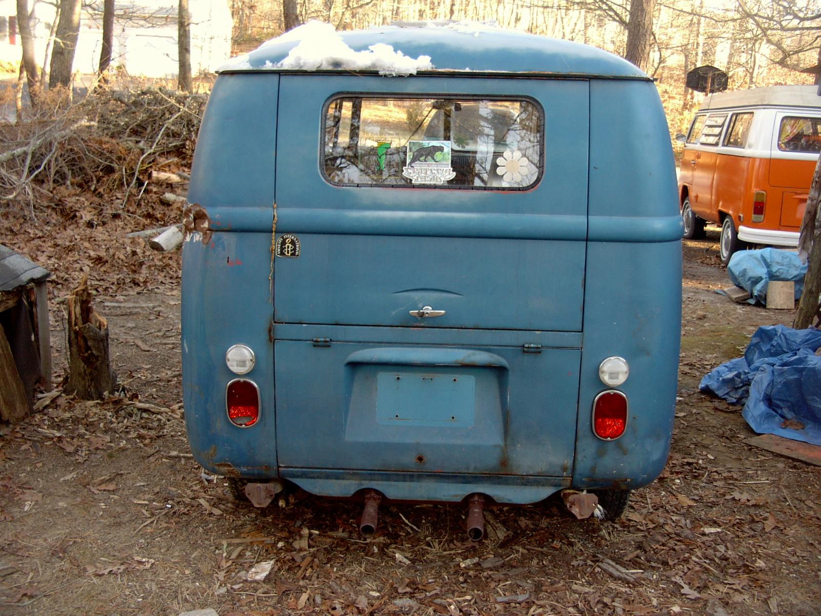

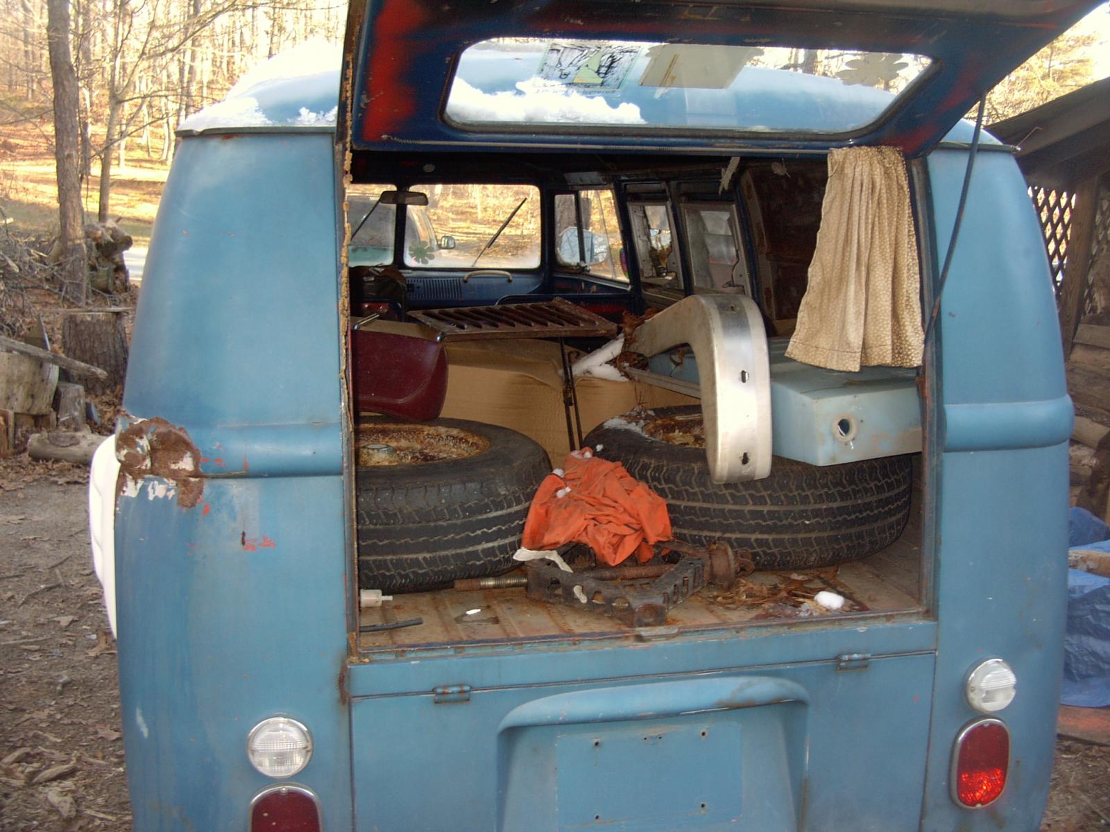

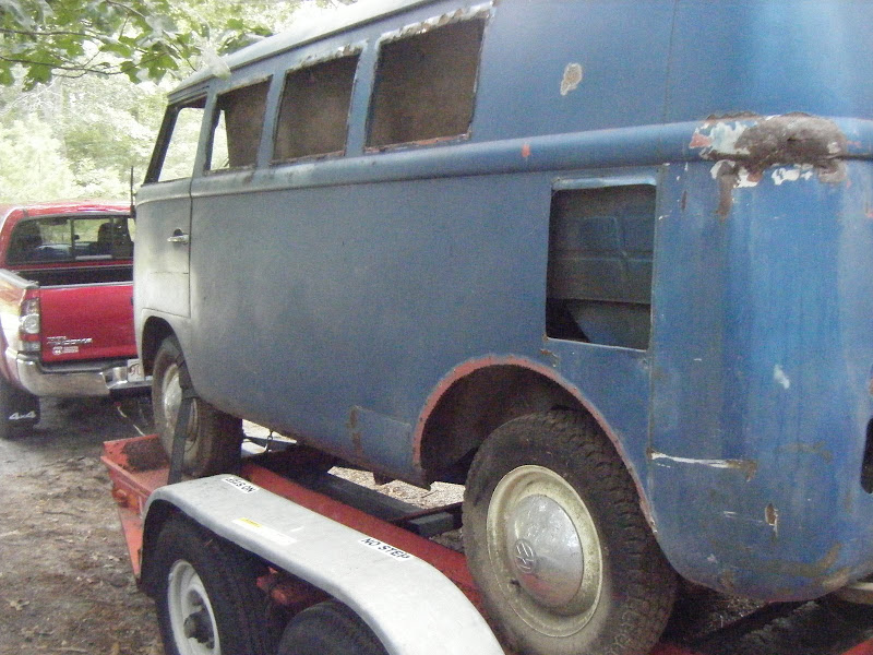

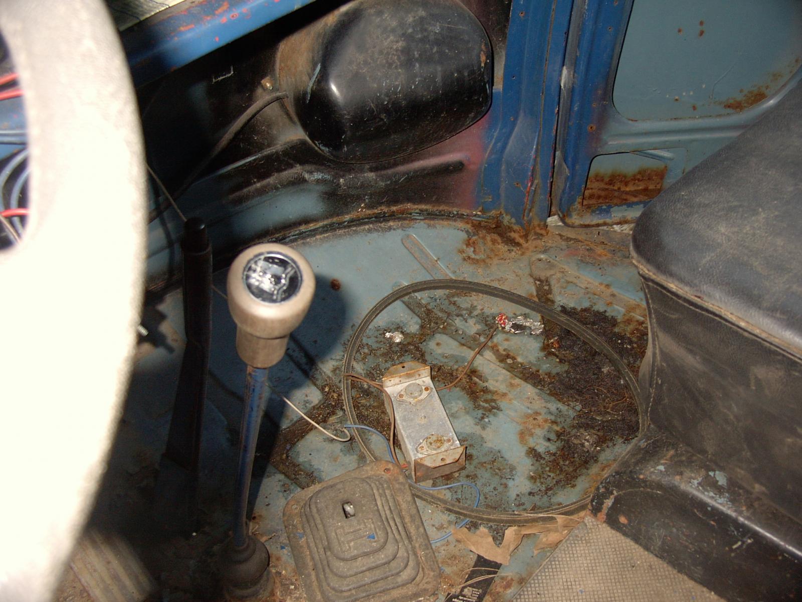

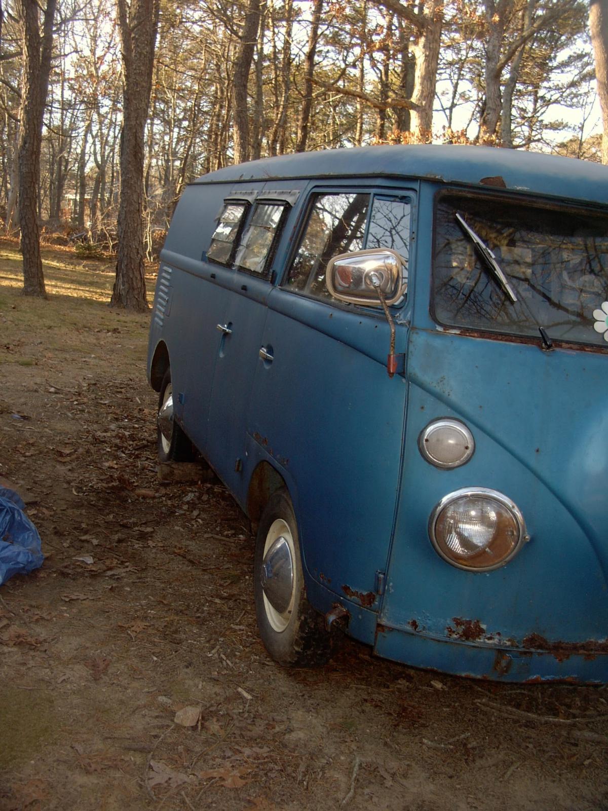

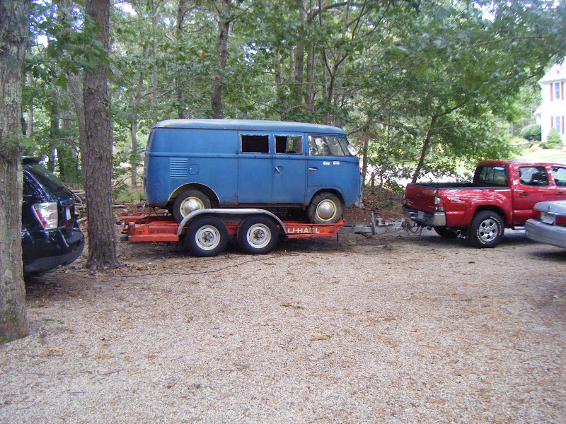

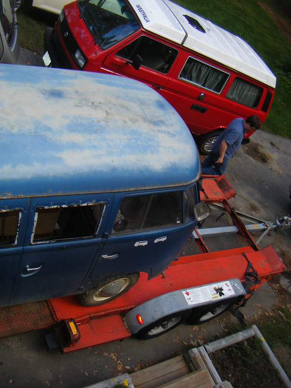

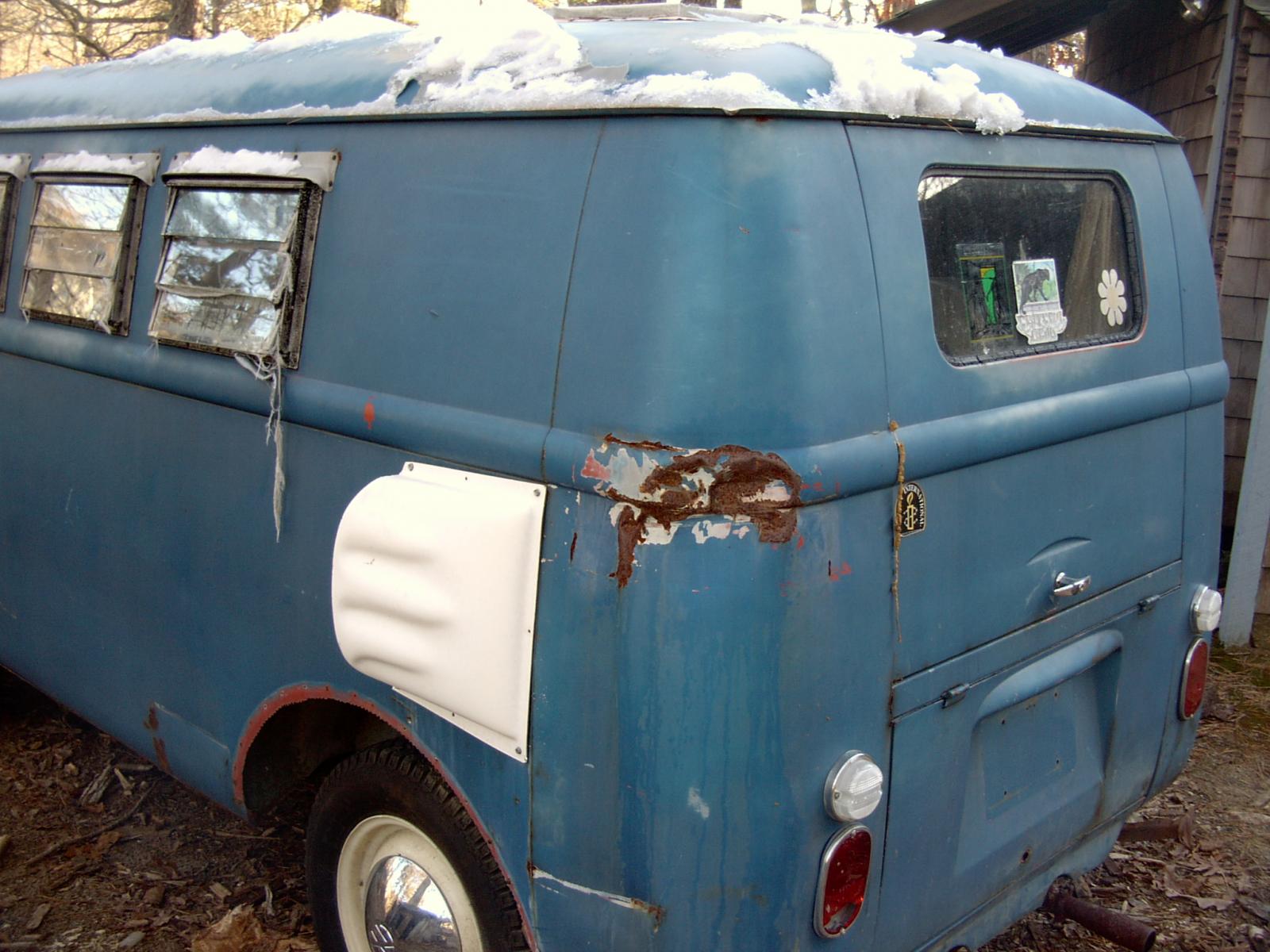

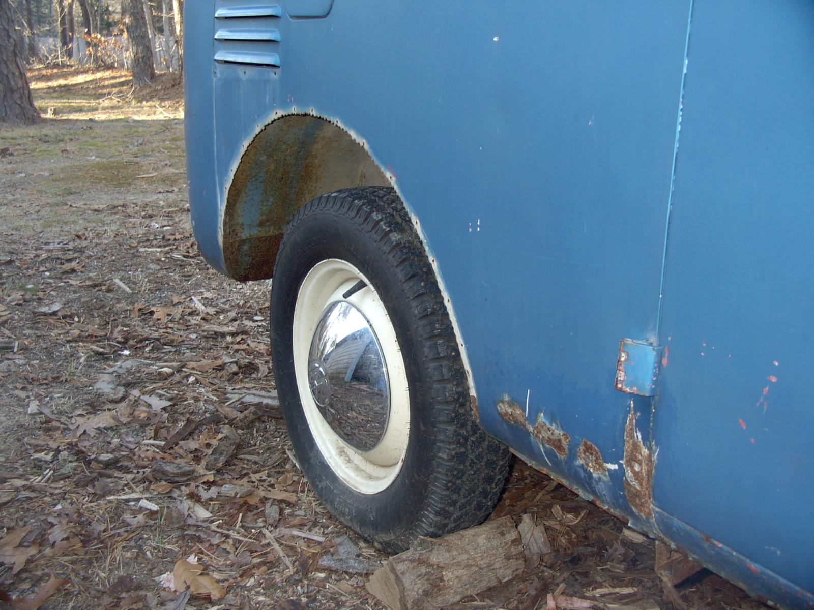

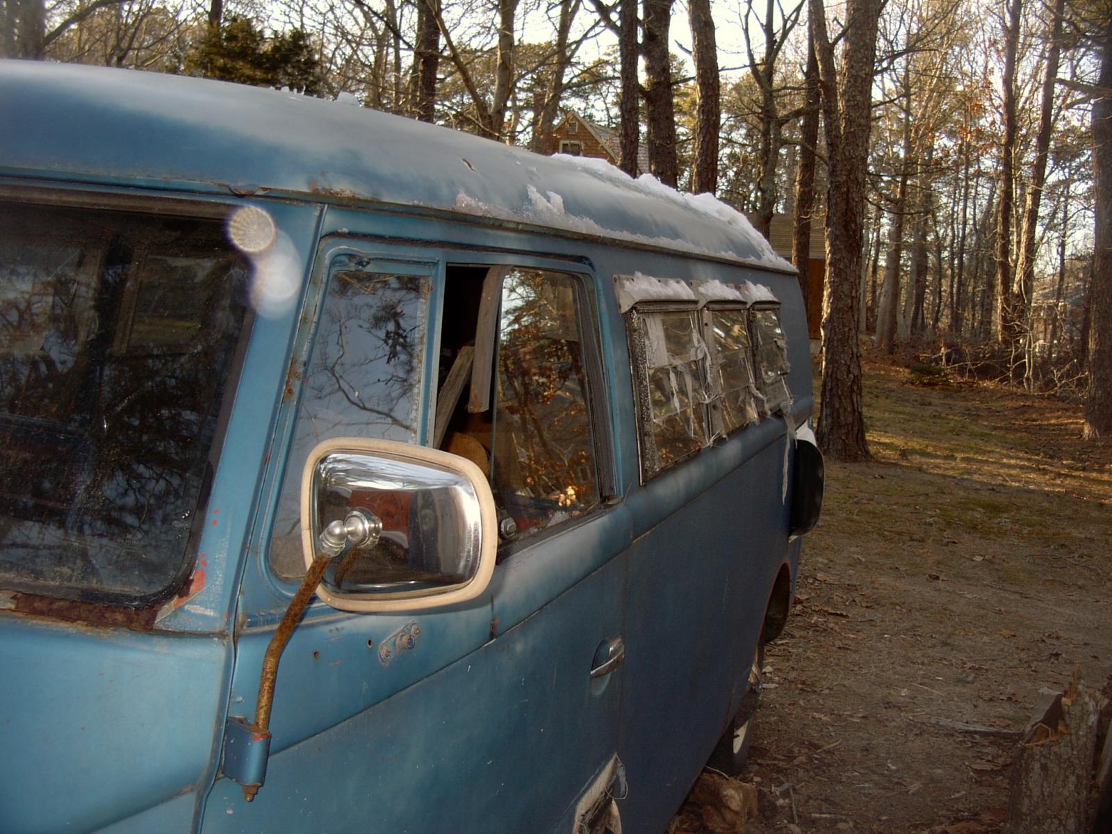

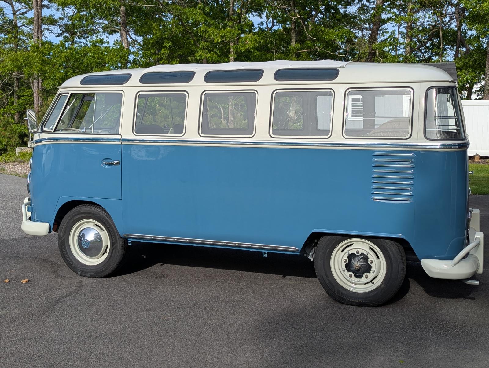

I've been sitting on this bus for 4 years. I have finally completed all the other bus and vanagon projects ahead of it and can start the restoration.
It was a factory '63 walk through panel. When I got it there were a few hacked up pieces of a sundial interior that was used to make a work bench and storage inside it. I don't know if this van was one of the sundial conversions or not, the window holes look kinda hackish, but I still refer to it as a sundial conversion.
When I first bought it 4 years ago I cut off some of the rusted panels. This thing is SOLID, especially for New England. The only rust was the nose, the lower part of the drivers door, which I cut off and welded, and small holes on both rockers. Battery tray has a small 1" hole. All floors are solid, wheel wells are solid. The most work will be fixing the hacks, the wheel wells have been cut.... one side vent (??), a hole i the roof, and little holes all around. It has been in a garage tent at my parents house for 3 years.
The bus was delivered new to Los Angeles and I found several receipts inside it from Arizona. It was repainted to metallic blue in the 70's. It changed hands a few times in Massachusetts in the 90's before I got it.
I've been collecting parts over the past 4 years and I think I have just about everything I need to finish it. well over $5000 in parts waiting Shocked I plan to restore it to mostly stock, but keeping the sundial-esque cut-in windows and a camper interior. It will get repainted the original dove blue. It should be a pretty easy resto considering how solid it is. Hands down the most solid original split window bus I've ever seen in all New England and I've been looking for them a long time.
The engine is a 1500cc from the looks of it... will verify when I open it up. definitely not original though, its really clean.
there are lots of neat little things about it. On the inside of the engine door there are compression test numbers and mileage penciled in for a five year span of 1979-1984. It says 30,000 miles in 1980 but who knows what that means.

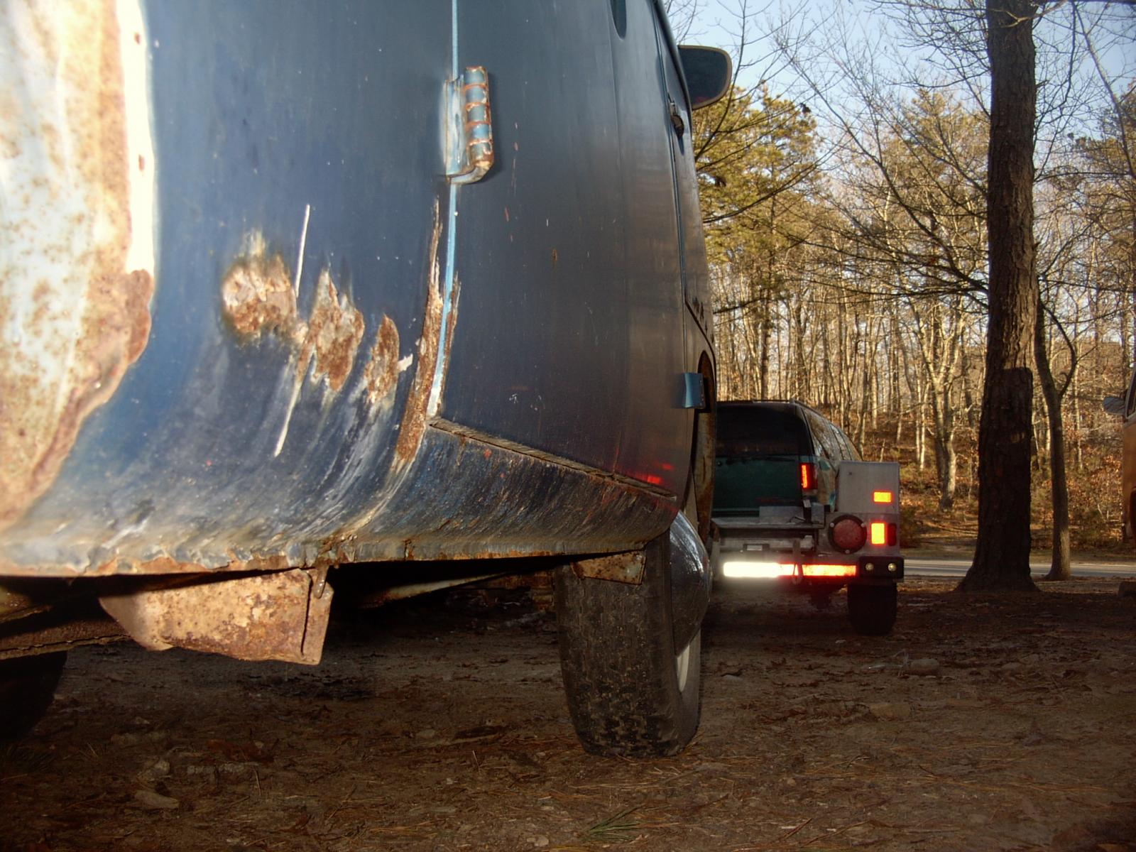

I hauled it to my garage yesterday. Heres some pics of the adventure:

The windows that were in it when I got it were the Sundial/EZ-Camper style windows that have the sharp corners. They're in tough shape and need lots of glass panels replaced. I have all the trim with them.
They look just like these ones:
I also have a set of pristine westfalia louvered windows with all the trim and hardware. They would not fit the current holes as they are taller and more narrow. They are really designed to be put in the place of kombi windows and would look a little weird if I just cut holes and put them in. Plus I'd have to weld patches on to make them fit and If I'm gonna do that I ought to just make it back into a panel.
The sundial/ez-camper windows are similar in style. I may sell the westy windows (unbelievable what they go for in the classifieds) and restore the sundial "cut-in" windows.

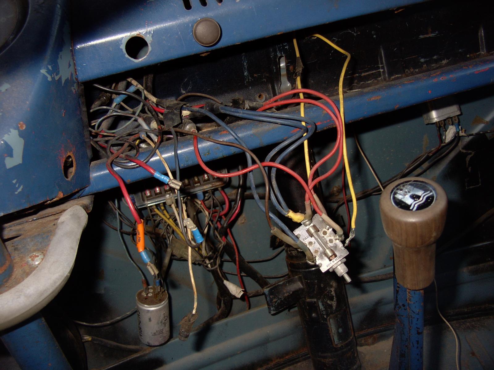

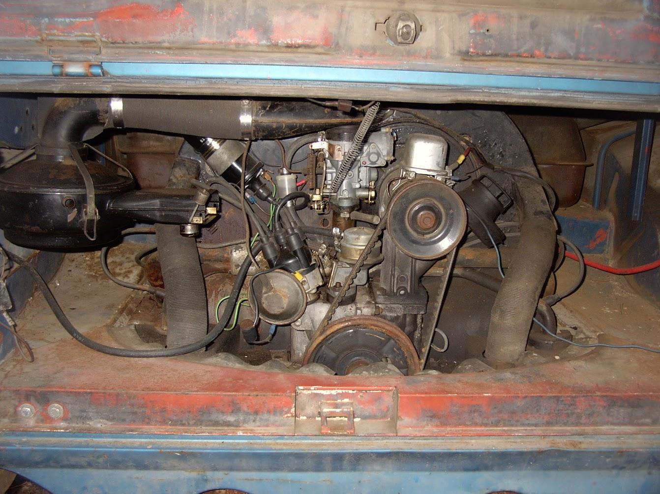

Finally got around to working on the '63 this week. I've been doing house upgrades over the past few months, getting ready for the baby who is due next month. A little time off from VWs was probably good for me.
Cleaned everything up inside, sorted through all the parts. Pulled the engine yesterday morning:
Got a late Christmas present:
Looks like a freshly rebuilt transmission. Hopefully whoever put it in was smart and built it up right. I never took the time to look at it, but the whole thing is painted black and the paint looks fresh, and its been in storage for at least 6 years. The bellhousing is stock 12V. The reduction boxes are still small nut so who knows.
Although still set up for 6V the clutch, pressure plate and throwout bearing look brand new.
I'm going to convert the motor over to 12V, and upgrade it to a dual port 1641 with some new parts I had laying around:

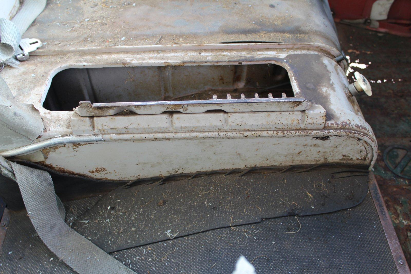

Today I pulled the gas tank out and spent the rest of the day sanding the interior...man what a pain. Someone had glued carpet all over the interior at some point and that glue has dried and is nasty stuff... what a ton of work.
The gas tank was an enigma. I drained it and it was just slowly dripping out of the spigot, but the tank weighed a ton. It felt like it was full of concrete. When I pulled it out i could hear a lot of gas sloshing in there, but there is something really heavy in it...blocking? the gas. No idea what it could be, but whatever is in there it weighs a LOT. I have a few good tanks to put in...I might even put a later tank in there. I might cut this one open just to see what the hell it is....not sure if I really want to know...
Battery tray will be replaced. This is the only in tact bracket bolt and latch I've ever seen.
Other side is good:

Don't trash the fuel tank; remove the sending unit and look inside with a flashlight. There s a baffle near each end of the tank.

anyways, after a baby, two moves and several other vanagon projects the '63 is now my focus so heres an update.
Replaced the battery tray.:
Pulled the tranny. The gears look like a 4.375 R+P with a .89 4th.
I think I'm going to replace the center section with a 3.88 (or maybe 3.44) and an .82 4th gear, keeping the small nut RGBs. This one is geared too low for me.
Lots of crap:
Cleaned. The horns and everything in between is factory paint preserved from 50 years of grease and road grime:
Up next is more cleaning of the trans bay. then prepping and painting the trans and engine bays.
