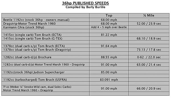

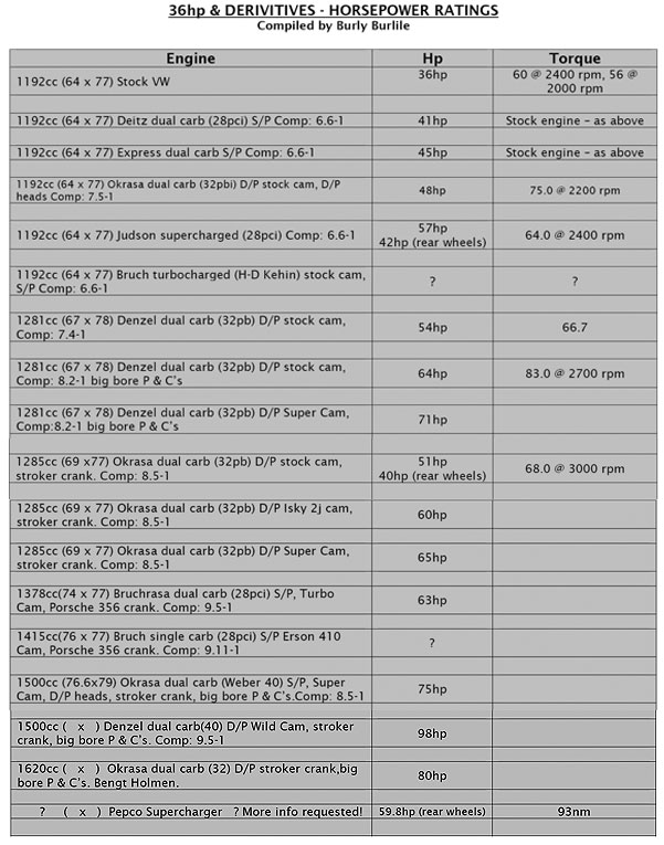

More 36hp Data supplied by Burly Burlile...thanks Burly.
There are some gaps that Burly would like filled so if you think you can add to the charts below just add them to this "Sticky" and it will be consolidated into the charts as and when.
John.

so to complete the list a bit, here my datas:
- 36hp engine 1433ccm
- 78,5mm (third oversize) pistons kolbenschmidt/ machined
- 74mm porsche 356 crank
- 356 rods (poished, custom bushings for 20mm bolt)
- flywheel porsche 356 8 dowel 4,25kg after machining
- cam aircooled research stage II bolt on gear
- valfes 36/28mm
- carbs 34PCI dual (venturi 26mm, 138,5/180)
- manifolds riechert welded and ported
- heads 36hp, some porting and welding
- compressionratio 8,8:1
- spacers 11mm
- headvolume 39cc / ball shaped
- exhaust stock, TDE pipes
- ignition Bosch BR25
Datas:
- corrected din power engine 70PS (nearly same as HP), @ 4223
- 50ps on wheels
- torque 126Nm @3282 upm
www.oval56.com

1192cc (64x77) pepco supercharged (28 pci) comp: 6.6-1
Hp: 59,8 hp (rear wheels)
Torque: 93 nm
