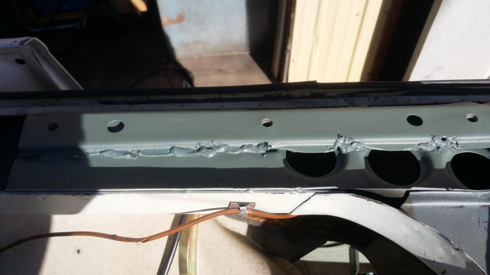

My 1986 syncro was a tin top that I converted to pop-top. I did not use the method requiring removal of the entire roof. Instead, the donor was used to supply a clip that overlapped the existing sheet metal right under the place where the Westfalia aluminum strips that hold the tent in place are fastened. This has the bonus effect of covering any imperfections in the lap area whether you choose to bond the metal together (I did), or to weld the lap area and grind smooth.
It is not complicated to get a good structural join on the westfalia top beam at the "C" pillar. You just need to leave enough extra material in that area when you remove the tin-top "C" pillar beam and then apply your Origami skills to fold the extra material into a box section and flanges to accept the Westfalia beam.
One very important thing to note: If you have to add metal at any point for strengthening, the mild steel sheet metal you get from a metal supplier is nowhere near as strong as the automotive grade steel used in the Vanagon and Westfalia. Try to use metal cuts from your donor in such cases.
There are a couple things I might do differently on a re-do, but they are minor. The icing on the cake is that you only need to refinish and re-paint the portions of the roof that are visible when the pop-top is open. There is no need to refinish and repaint all the way from the windshield to the rear window.
One important lesson learned: CAREFULLY cover all glass from welding spit. It permanently marks the glass.
If my approach interests you, PM me. Sadly, I have very few photos.

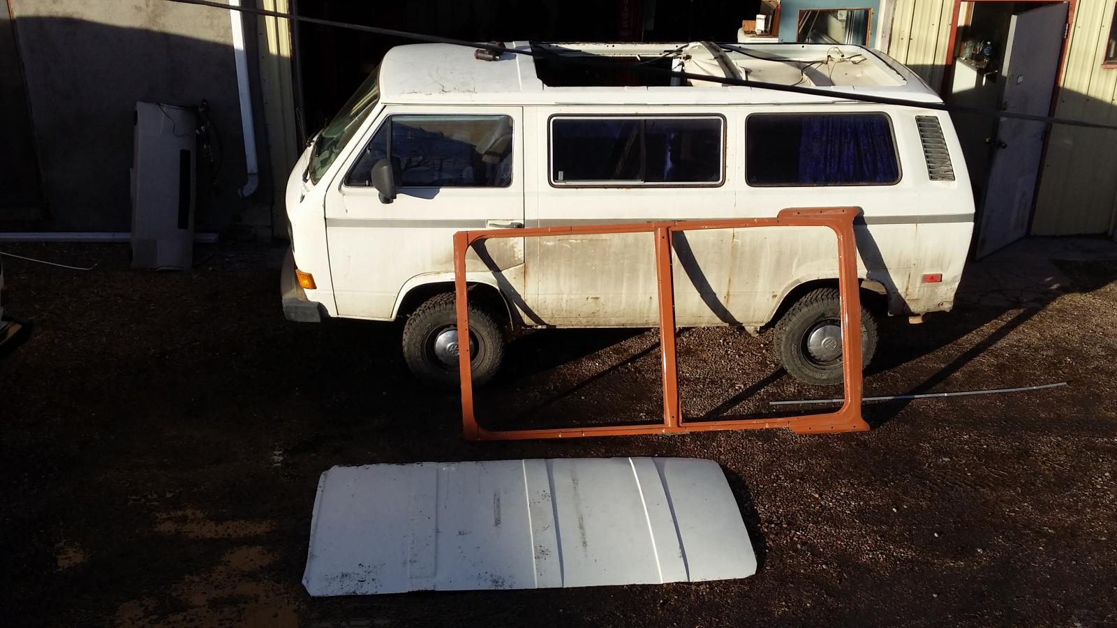

I did a rough clean up on the donor today (it was a horrible mess) and was looking at the roof on it, but is there really much difference in the actual skin assuming the hole on the tin top was cut exactly like the Westy?
It seems almost like the curve of the roof is the same, the only major differences being the pillar beam being flat and of course the center section being build for the pop top. Other than that the roof line really does seem the same to me., but of course I'm just eye balling it.
How did you do the rear hinges?

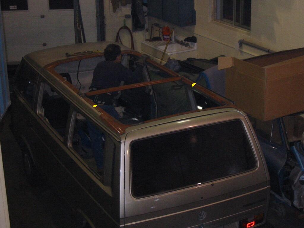

I think I get the idea of how this is done, but I'd have to see a picture to know for certain. I guess the remaining question for that method, would how are the rear hindges bolted into place. Are they just bolted from inside the van and if so is there anything done to strengthen the mounting point?
I'm assuming the graft is something like this one from the "My westfalia pop top transplant" thread.. Looks like the cut section is welded on top of the existing tin top roof as described.

I just did a swap exactly like that photo. I ended up cutting the roof almost exactly the same way as below. You need to go outside the portion that is covered by the trim holding down the tent to accommodate the sub roof mounted plate for the hinges. I would have done the entire graft process but there was rust in the rail of my donor. I used both panel adhesive and welds. It is sturdy. This job is a lot to tackle no matter how you cut it, pun intended. This is not for every rookie out there. I have now done the entire swap at the rails. Entire roof at the spot welds. Now this modified swap. I hate drilling spot welds. The roof rail method is the easiest. For maintaining an original crash/crumple zone, I will not do the rails again.

Hope this is helpful. I snapped a few photos to show a buddy what I was up too.
Make sure the wood is installed in the top and lines up. I heard a story a dude welded it in and had the roof ring compressed then the wood didn't fit. Oops!
MarkWard
Joined: February 09, 2005
Posts: 19095
MarkWard is offline
PostPosted: Fri Mar 13, 2015 11:07 am    Post subject: Reply with quote
So at least the hinge base area is seam welded and the of the outer frame is glued forward of the hinges? I ask because I am interested in doing the minimal amount of welding. Welding sounds simple, but with warpage, contamination, burn through, later chances of rusting etc, I can see the value in a quality adhesive for this project.
