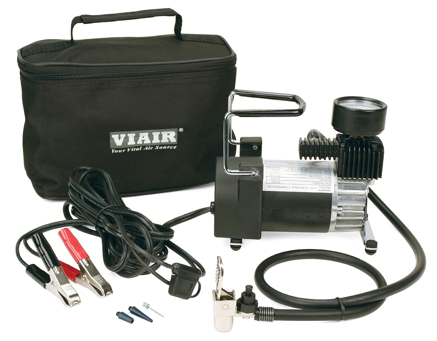

If you dont already have an airpump, here is one I recommend, Viair 90P
http://www.amazon.com/Viair-93-VIAIR-Portable-Comp...ords=viair

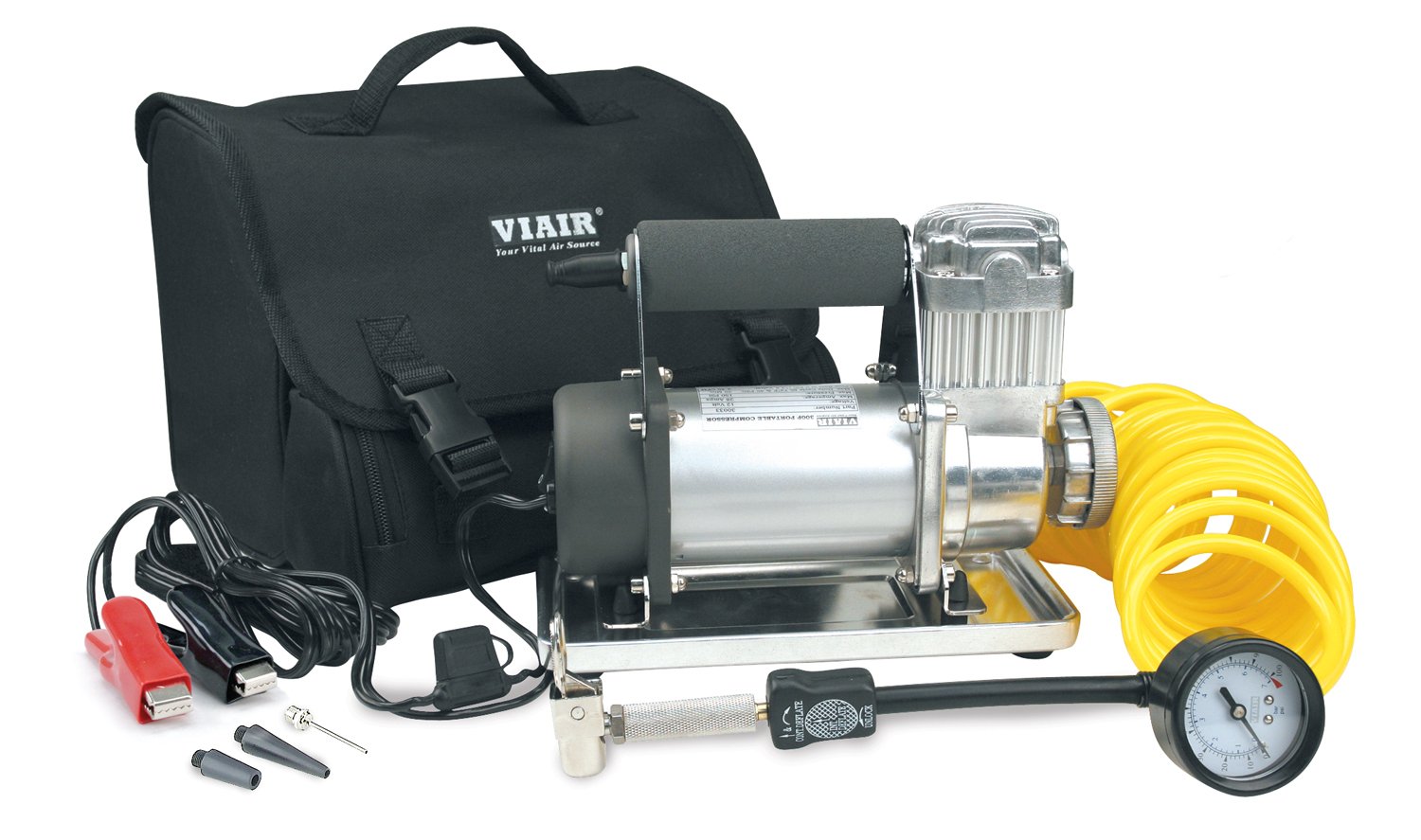

or the next step up, Viair 300P
http://www.amazon.com/Viair-30033-VIAIR-Portable-C...ords=viair
