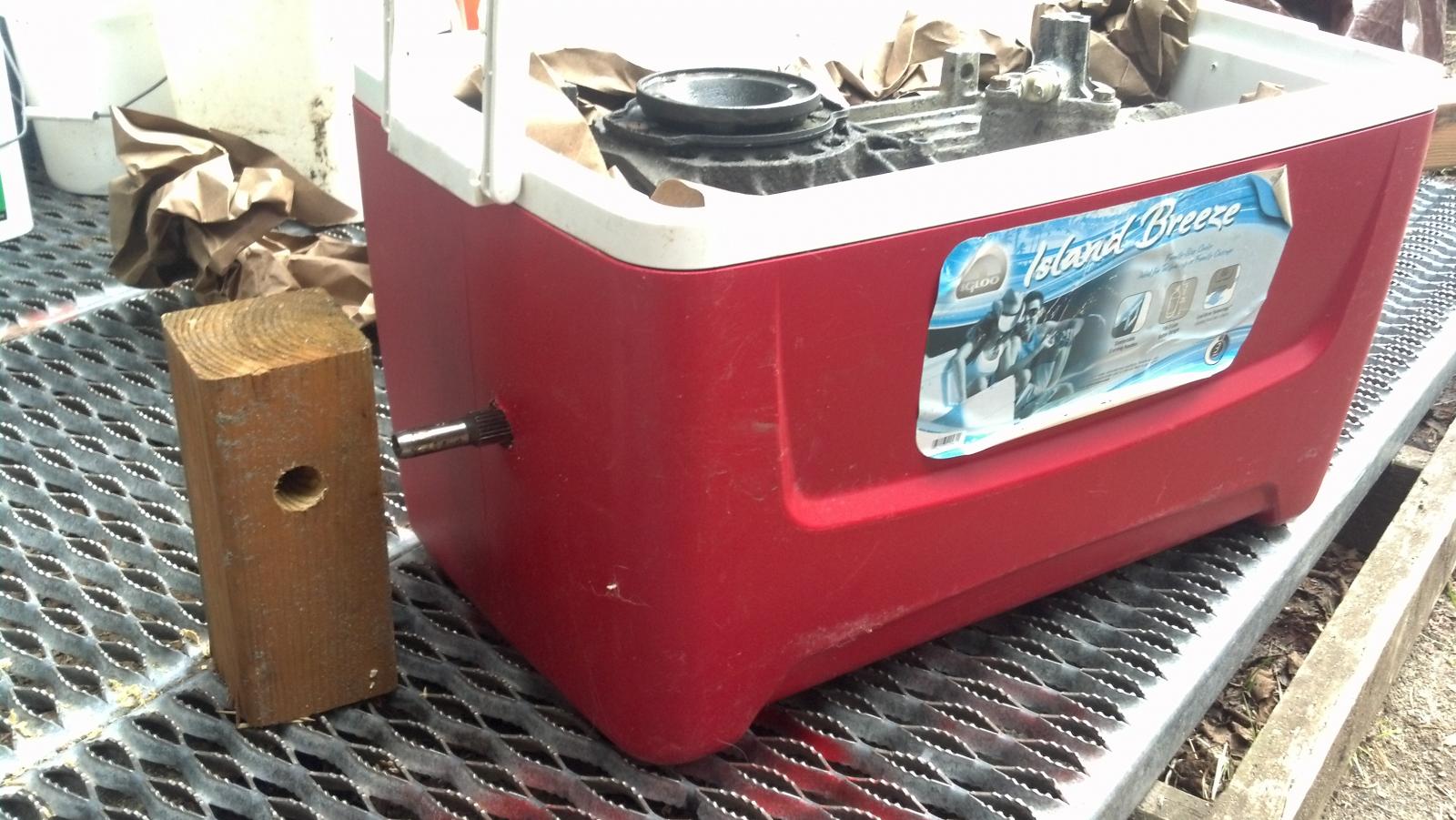

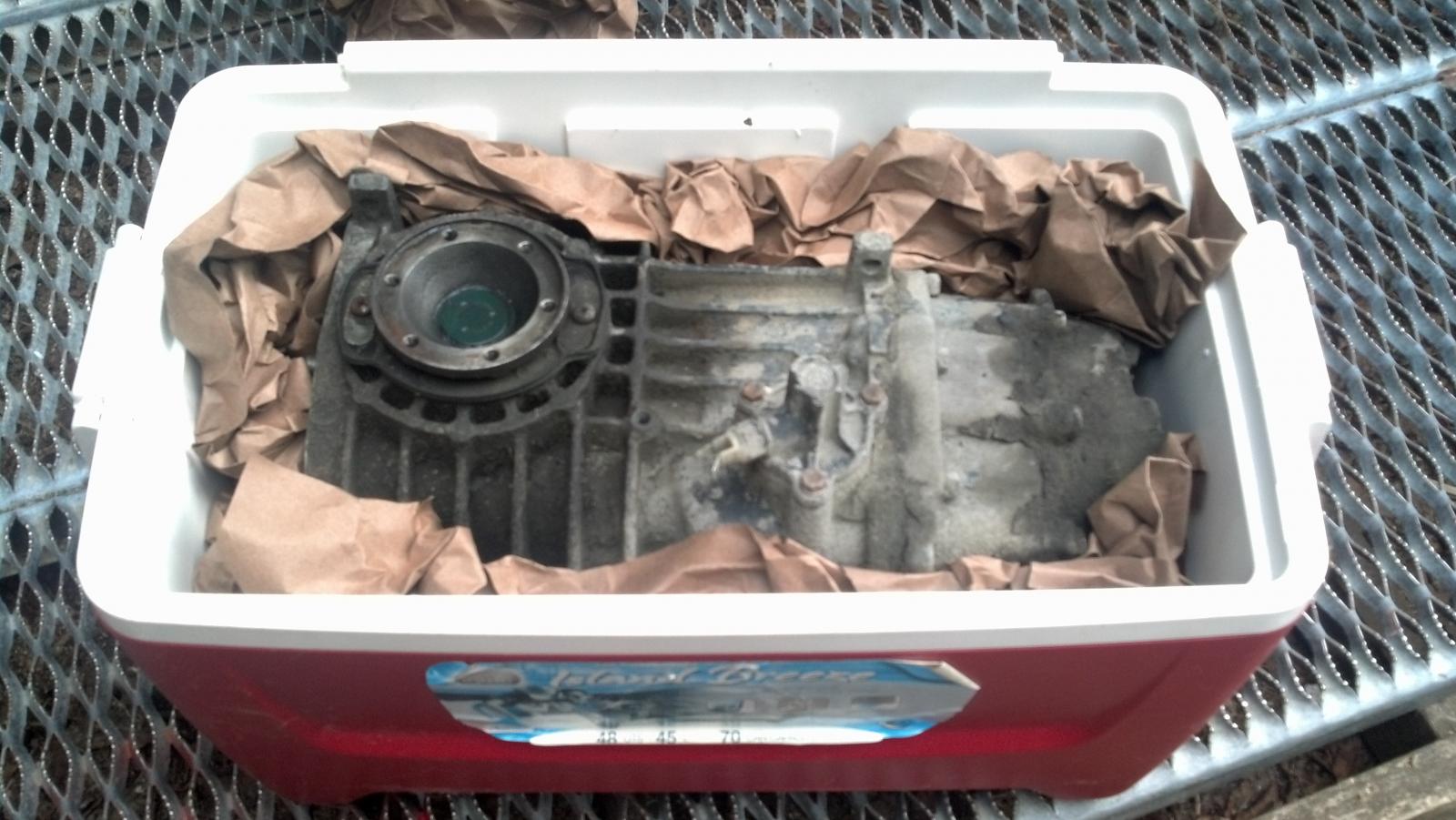

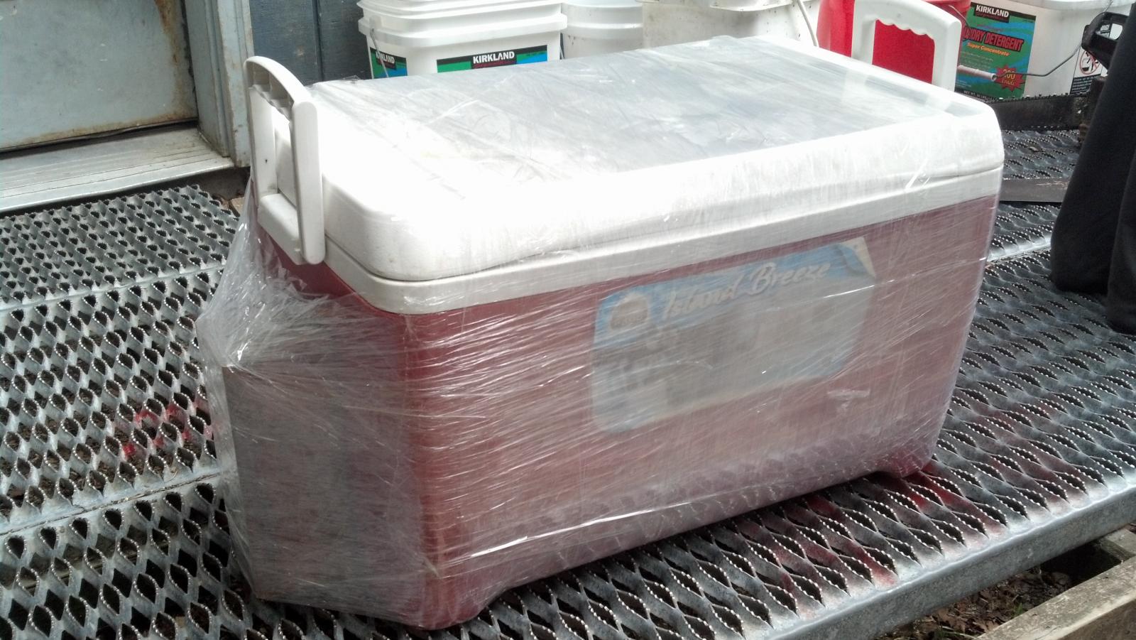

Talked to Erica at AA today. Looks like they are 6 weeks out right now. I packed up my transaxle today to ship it down to them. $2600 for a rebuild and Peloquin. I did talk to German and GW about their transaxles also for comparison. All seem to back their rebuilds and Peloquin install with great warranties. I decided to go with Matt at AA.
This will get strapped to a pallet and barged from Haines down to WA where it will freight to their shop. No UPS or FEDex here.

That's one of the most awesome field packing jobs I've ever seen, above..
Applause Applause Applause

That is indeed an excellent packing job. Points for ingenuity and a gold star for thinking outside the....er...box. Cough.... Laughing
