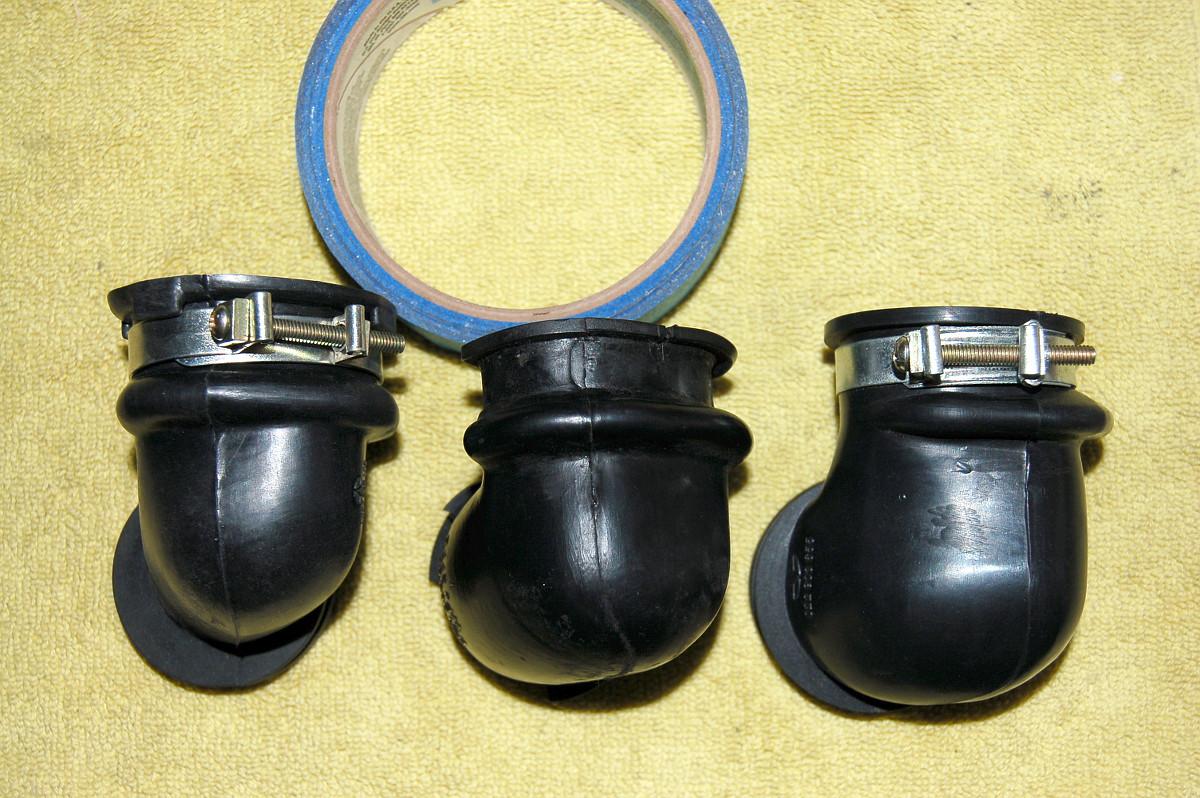

The type 4 Alternator came in two varieties, 55A & 70A.
The Elbows came in three versions #42.
55A Elbow 021 903 655 B small hole in fan housing 72-74
55A Elbow 021 903 655 D big hole in fan housing 75-79
70A Elbow 022 903 655 option 70A 75-79
It is hard to tell from the picture, but the round part of the Elbow on the left, that goes into the fan housing. Is smaller than the Elbow in the middle.
<Left 021 903 655 B small hole - Middle 021 903 655 D big hole - Right 022 903 655 option 70A>
70A Elbow 022 903 655 optional 75-79
Note: 70A connection built into the Alt. housing, is bigger and round.
