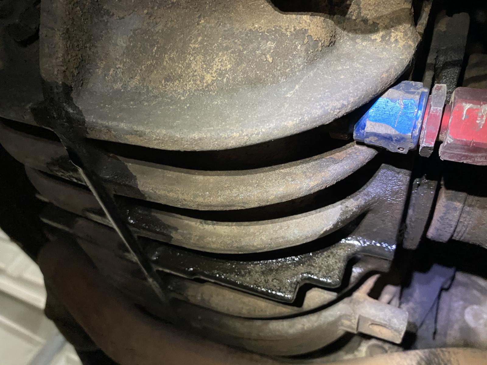

PostPosted: Thu Dec 24, 2020 5:43 pm    Post subject: Re: Transmission axle seal leak? Reply with quote
Pulled the axles this evening. Merry Christmas eve!
This is what I have. Comments?
I'll pull the axle flanges this weekend. Anyone have a good link to the procedure (otherwise I'll have to pull out the Bentley... Wink )

To really know you’ll need to pull the cv flanges and the plastic retainers. It’s either the lip seals or the o rings. I’d be doing both if you don’t know the age of the cover O rings. Fairly straightforward if you have a tool for spinning the collars out. Do one side at a time and if you remove the collar, center punch reference marks and measure the depth. You can also count the revolutions.
I’d expect to see more residue on the cv flanges from CG force if it were the lip seals, but they could be weeping just enough to run down behind the plastic retainers.

The flanges are totally dry from what I can see. I’ll take pics of what I find.

Clean up the old grease and pries out the cap hidden under it, take those duck nosed snap ring pliers you bought and remove the snap ring making sure it doesn't fly around the room and pull the flange off the shaft.
You will need to remove the plastic lock ring to access the seal, the seal can be removed with a seal pulling tool. As mentioned don't turn the adjusting nuts unless you have punch marked their position.

I bet it’s the o-rings. Thought mine was the flange seal and replaced but still seeps. Talked to very knowledgeable tranny builder and he said it’s more common for the o-ring to leak than the flange seal.

From VAG .... a picture is worth 1000 words........

Plan on replacing the o-ring. There is also a seal that covers the clip ring that is usually siliconed into place. The housing that the o-ring seals is how the pre-load is set on the differential, pay attention to its clocking. Otherwise it is a pretty easy job and highly satisfying to stop that particular leak Smile
