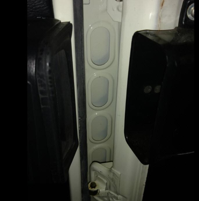

The air vents at the base of each of my front doors ('77 Campmobile) do not seem to be fed by any air source. What is the purpose of sliding these open or closed?
On the earlier bays, the vents in the doors seem to be fed by the fresh air coming through the grill.

The air vents in the door panel [not the channels ON the door panel] are fed air from the front edge of the door. Look for square slots in the front edge. 68 to 71 doors did not have them. Flo-thru ventilation started with the 72 year model.

So, Karl, you are saying that the air comes from the holes in the door by the hinges where it meets the body? It seems like there will be little if any air flowing through there even while the bus is in motion. Is this vent then to air out the inside of the door so that moisture has a chance to evaporate?

I believe it works the other way round...the low air pressure at the corners of the van sucks air out of the slots in the door front (and out of the vents). The vents suck, rather than blow.
Useful for drying the interior of the door out as well (it needs it).

they keep your butt cool. The air is pulled in through the front of the door. Helps to keep the inside of the doors dry too.

the door vents work in conjunction with the inside front of the door to allow more cooling air thru the bus in summer.

no. They have nothing to do with the armrest vent. There are four oval openings in that photo above on the door that I posted. There are actually total of ten but they weren't in that first photo. See the photo below for all the vent openings on the front. They allow venting between them and the slider vent. You have to open the door to see them. They also help dry out the inside of the door and help preserve the door cards.
