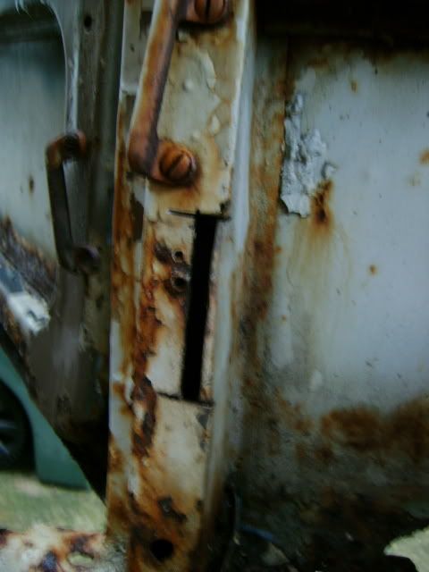

Here is where I cut my 15 window to get in for the nut plate. Was missing both lowers

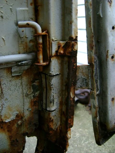

Here's the plate on a new Gerson Lower B.
