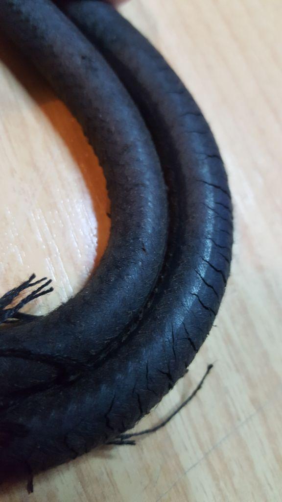

so just found a puddle of fuel under the front of the panelvan today and after looking under ther found the fuel line dripping between where it comes out of the tank and goes to the hard line through the body.
there is a bit of a curve in it to get there and thats where the leak was.
here are a couple of pics showing the offending item after the cloth covering was removed
and then a new piece thats never had fuel in it compared to the used bit.
this fuel line was replaced when the car was restored 2 and a half years ago.
the markings on it are cohline 2122 5.5 x 10.5 73379
have also just read some horror stories about this particular fuel line on a porsche 911 site.
someone said its that crappy they wouldnt even use it for windscreen washer hose.
http://www.early911sregistry.org/forums/showthread.php?125074-Cohline-Fuel-Hose-Issues
anyone here had similar issues ????????

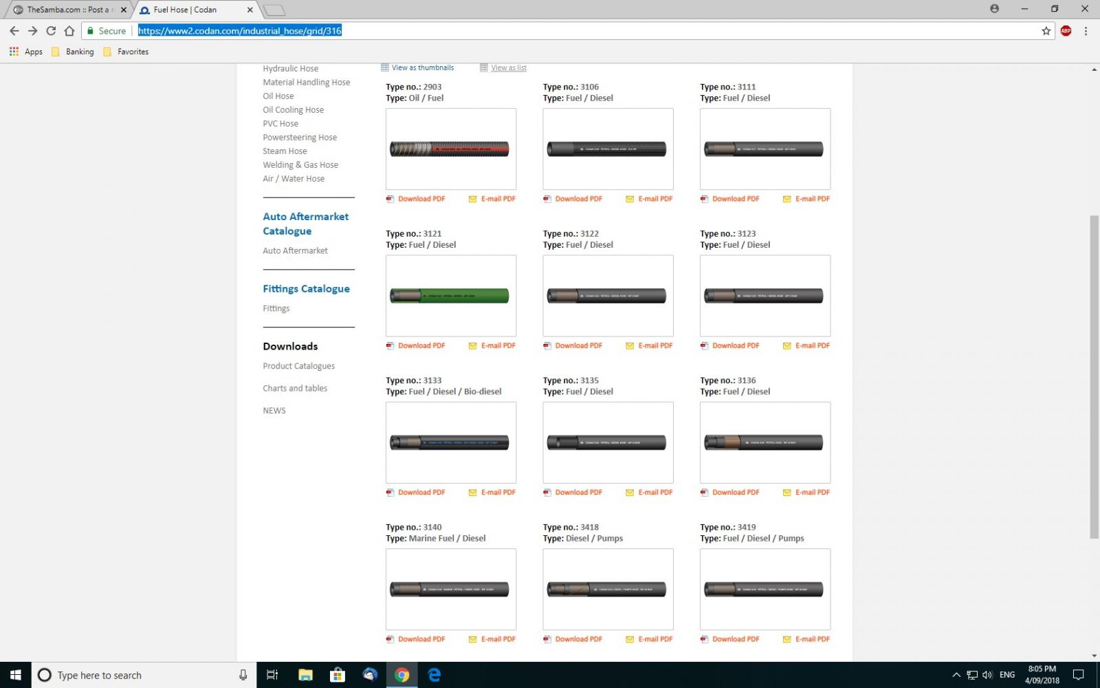

found out my local auto spares store has access to order from Codan.
https://www2.codan.com/industrial_hose/grid/316
one of these should be suitable i hope

A lot of us carb guys are using 30R7 hose with the most current date. That's what I'm using.
But you can always step up to FI hose in the same size. The thought behind going to the FI hose being it's more compatible with today's fuels, and since it has a higher burst pressure, doesn't need to be changed as often.
Russ showed us years ago to NOT use the external braided stuff, as it would burst at 60 psi in an FI application. But the bigger problem was that it would crack and leak without being seen until you saw the fuel on the engine or floor, or saw a wet spot on the outer braid.
You would think...but sadly...no. The fuel injection hoses have been having nothing but problems.
The current Gates barricade SAE J30R14T2 spec hose is about as good as readily available fuel line gets...and still I am reading about sporadic cracking and failures under normal pressures in the 2 year and less range. So its not perfect.
https://ww2.gates.com/europe/brochure.cfm?brochure=12647&location_id=19079
To be honest...I typically had replace hoses in the every 2.5-3.0 years range even un the 90's....but I would do that because my VW was a daily driver that went an average of 1500 miles per week 52 weeks of the year working in a high heat region.
I replaced it when I felt it getting noticeably stiffer...and/or when I noted cracking exposed edges near clamped ends. So I was overly proactive....the thought being that any given week I could be 1000 miles from home and did not need to wait to change hoses...until I ground to a halt with an empty fuel tank in teh middle of nowhere.
I do not consider it the correct time to replace fuel hoses only AFTER they crack to shit and leak fuel. The correct time comes long before they fail.
But its much different now......back then when I replaced lines they were not rock hard and cracking/leaking at 2 years when I replaced them....like some of what is going on now. Now...you can put brand new fuel injection rated lines on...and a year+ later...its rock hard and cracking on the outside.
All I used back through the early 2000's was Wurth stock cotton braided fuel hose and sometimes Continental.
This fuel line issue is the prime reason the vast majority of vehicles have gone to 95% nylon and steel with rubber only at flex joints. When I finally get mine on the road again I am going that route.
Ray
Yup, when I lived in the TexOhma area, fuel hoses got changed fairly often due to getting hard as a stone. But it seemed like they took years to crack, unless they were under the hood (water cooled stuff). The funny thing was hoses under the car (by the rear mounted fuel tank) were always supple, and lasted for years. So, was it the quality of the hose? Or was it being out of the sun? Or was it a case of having fuel sit inside it?
Its the heat. The lines inside of the engine compartment of water cooled cars take a lot of radiant engine heat.
It was the same problem on my 411 and 412's in Texas and Oklahoma heat. The engine compartment on a type 4 is fully sealed. Ambient temps can be in the 185 to 225 F range under the hood during extended highway driving in 100 F weather.
The fuel lines inside the engine compartment were always the ones I noticed getting stiff and cracking. I had to replace them every two years. Anything forward of the fire wall could stay supple for a couple more years but usually if I was buying fuel line to do the engine compartment...I would buy the whole cars worth as it was cheaper in larger quantities where I was buying it.
That...and if I was pressed for time....or pressed fro funds...it was plenty safe to redo the engine compartment lines and wait a month to do everything up to the tank. Ray
Oh, I know about the heat in that area. 100 straight days of 100+ degree heat really took it out of you without AC. This is the Burkburnett area (between Wichita Falls and Lawton).
But I still wonder if it was in some part the quality of the rubber. Just asking, as some of the older made stuff still looks good (under a car/truck) while the newer stuff is already degrading. Another example is what did GM do differently on their FI hoses, that have screw on ends to/at metal line fittings? I'm just asking, as my 30 year old Chevy truck has them, and they don't leak or aren't cracked. Same applies to the lines and hoses at the fuel tank. Was it better rubber? Different compounds? Or what? A year later GM went to braided stainless hoses to replace the rubber ones.
Yes....it IS partly the rubber. I wrote a lot about this here and on the STF a few years back.
Its partly the ethanol. Others...especially loud people from California Wink ...will tell you its the ozone and pollution....and that is actually very, very minor so partially correct.
Taking the ozone issue first....there is no such animal as ground level ozone in a "free" state. I work around equipment that makes a VAST amount of ozone. Ozone is lighter than air. It rises. It ALWAYS dissipates from its source within about 10 feet of travel...UNLESS...it recombines electrochemically with various VOC's and/or free water vapor (high humidity)....which will then allow it to combine with micro particulates.
Yes...it creates smog. But smog does not eat our rubber hoses. So...its not the ozone.
Rubber hoses that are in sealed engine and equipment compartments with lots of arcing equipment (alternators, electric motors etc.) or used around high voltage UV curing lamp equipment (my industry)...yes...can have ozone damage.
I lived in Dallas for 6 years. They have the 2nd worst ozone problem in the country...meaning smog inversions when it hits 100F. Ozone causes the smog. Smog dos not cause ozone.
The rubber formulation issue:
Back in about 2009-2010 I think.....I made a note and did considerable research into the rubber issue..because it was affecting my end of the industry.
What I found is that stating from about 2000 on...there has been a moderate world shortage of ....Butadiene....used in high rubber for tires, hoses, molded parts, thermoset and extruded/molded plastics (my end of the industry) etc.
A big part of this...was the HUGE up-tick of the molding of plastic around the world for consumer products...especially nylons...which use butadiene.
Nylons are not just in demand for hard plastic versions of nylon. You are looking at nylon fiber for insulating and strengthening cloth for automotive sound damping, carpet, strengthening fibers in tires, molded rubber parts, packaging...and...automotive wise....the use of nylons are huge....fuel lines , suspension bushings and parts, carpet, seats, sound damping, electronics, wear bushings....the list goes on.
And....back to the rubber fuel lines and tires. Costs were rising. Demand was rising.
The Killer:
When the recession hit and GM nearly folded and needed to be bailed out....they owned a whole slew of tier 3 companies that supplied raw materials to their suppliers.
Some of these had one sole client chain....GM....but their over capacity supplied thousands of companies. One or two of these were chemical plants that made ...Butadiene as a secondary product...and nylons as their main product....about 25% of the world supply of it.
And while they could...in the long term ...probably have made a healthy living supplying all of the other people other than GM who needed chemicals and nylon....they did not have the instant connections...nor did all of these other companies want to buy from them (think Chinese).
So....without thinking...GM shed these companies and they instantly went out of business.
So now we have a full on shortage of one of the prime chemicals to make the best nylons and fluoroelastomers from.
And....with the recent investment in nylon usage by the transportation industries (not to mention medical, industrial cloth, appliances and electronics)....most of the Butadiene trade was pushing to supply the plastics makers.
So....the rubber makers....starting using the "other" recipes to make rubber.
You do not HAVE to use Butadiene. There are other catalysts and pre-cursor chemical recipes to make high end synthetic rubber.......but they are harder to control and do not always have the same attributes.....as we are seeing.
Also...a lot of the rubber manufacturers that have stepped in to fill gaps...are in China. And not only are they using alternate recipes...they are using crappier raw materials.
Butadiene and other chemicals...maybe no longer a shortage...but its still expensive because its in high demand for the nylon and plastic industry.
Back in the 2012-2014 range...there was a big rush to build nylon plants. An industry mag noted that in 2012 alone there were at least 4 new start up nylon plants on the Gulf coast.
Ray

sourced some codan fuel line, new filter and some clamps today.
good weekend project.

PostPosted: Thu Sep 06, 2018 10:25 am    Post subject: Re: fuel line help Reply with quote
I'm keen to hear how this turns out...(both of them) although it doesn't appear that Codan products are available in the US so I'll be using Gates Barricade fuel line or teflon in the future.
