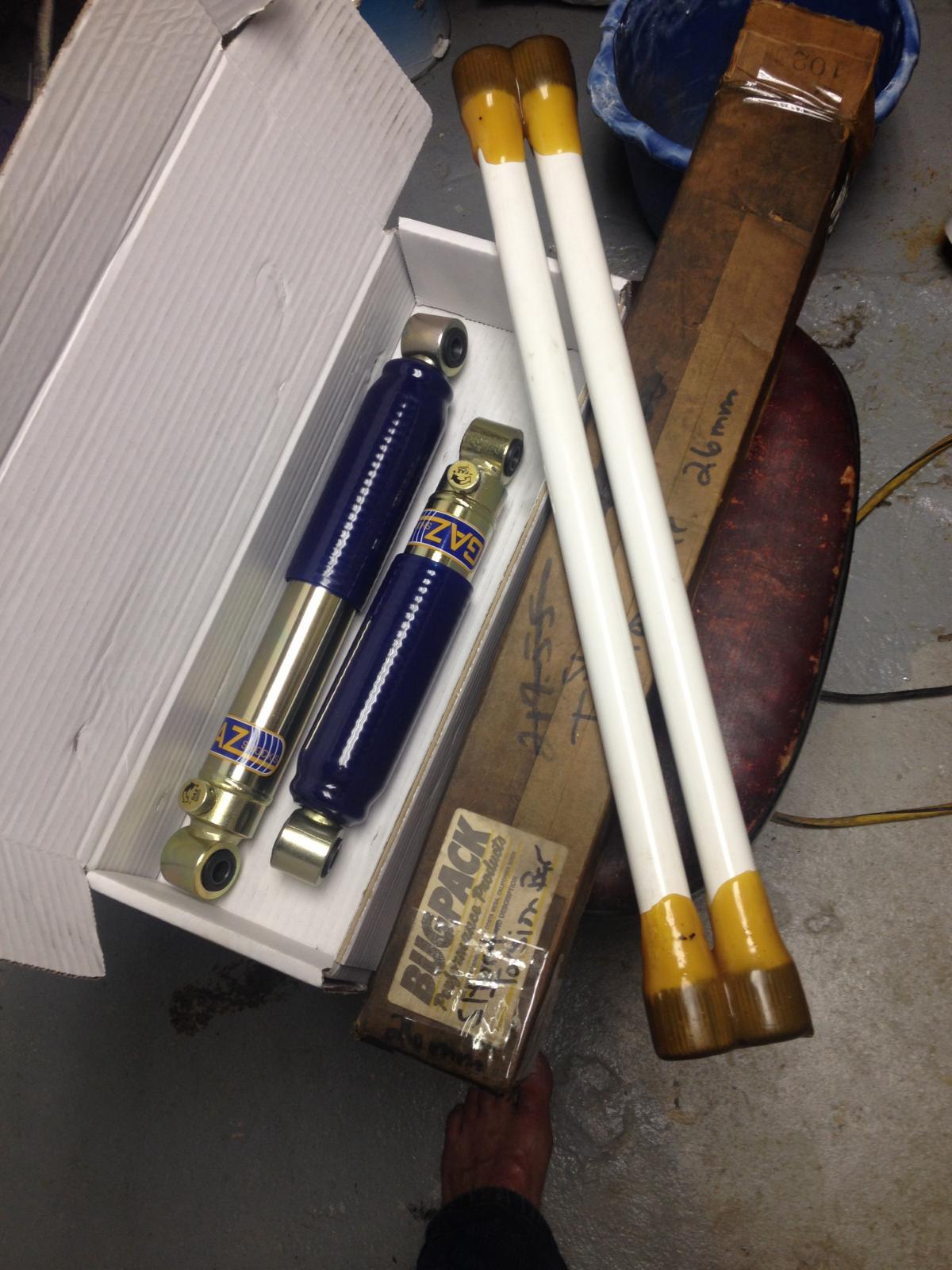

After trying oil Boge, KYB GR2, KYB gas adjust, and then testing a friends Koni reds on the rear of my 62, it was clear that I wanted adjustable oil shocks for the rear. I just couldn't bear jacking the car and disconnecting the bottom of the shock to make an adjustment every time, plus waiting for the header to cool down was a drag. So I wanted a shock with an external knob adjustment. I searched and the Spax are nice, but came in at almost $400 for the pair by the time shipping and customs were paid, no way thanks. Found these GAZ brand, made in the UK, landed to me for $235 total. They seem very well made, and these are 22 position from softest to firmest. We'll see how they fit and ride. I intend to fit the shocks first ,and then maybe these old 26mm sway away torsions if need be

Best pair of shocks I've ever put on a beetle. Now have several friends running them, no complaints at all. They will make them adjustable for compression and rebound also.

FYI: I ordered from a place in Florida, Brunton Performance.
[email protected]
GT5-2301 is for the rear 1953 to July 1965
I did try them with the 26mm torsion bars. With the stiffer bars, I had the shocks on maybe the second or third click, and it was still VERY stiff. So, I am back to stock short torsion bars, and have the shocks adjusted somewhere in the middle of the range. I had been told to was better to have a soft spring and adjust it with shocks, than start off with too stiff a spring. Turns out everyone was right Wink
My buddy is running an IRS beetle with the longer torsion bars. Those cars have a notoriously soft torsion bar, and I think along with the GAZ rear shocks he also upgraded to stiffer torsion bars. No complaints from him, and he actually drives his car hard, all of the time. Mine is just an occasional toy, and I've been busy working on my new workshop, so it's not been driven much lately..
Really, the thing I like the most is the ease of adjustment. When using the Koni reds, disconnecting the shock to spin the body and adjust it is easy in the front.. but in the rear.. many of use have oil lines/ truss bars/ sway bars that are sort of in the way. Not exactly the sort of roadside adjustment you want to do. With these I don't even get dirty.

What are you running on the front? I need new for the rear, and I have a set of used Bilstiens on the front, this just has me wondering.
Koni reds, on the front of every VW I drive.

Just curious, do Koni reds have resistance on downward motion? Vws have no weight up front, and being low already makes shock selection really important.

Yes, they have what I'd call average compression valving for an oil shock, and adjustable rebound. I keep the rebound on the bus tighter than the beetle, as A. it weighs more, and B. it's tall and sways more when bouncing.
But yes, they do have some stiffness to compress, but nothing like a KYB GR2 or (gulp) Gas-adjust. The gas charged shocks might be fine in a modern car with modern seats. On what essentially amounts to a folding chair with a horse hair pad over shitty springs, my old bones need a little less of a jarring ride.

Good info. Yes i had the white empi gas shocks up front and it added to the jarring effect. The cheap empi oil filleds i put on and its abit better.
Thanks for the updates on the GAZ shocks

How do you think the GAZ shocks would work on the front? I like the idea(as you stated about the rears) of being able to adjust with the dial.

I've considered buying a set for the front of my beetle, but too many other projects needing the wallet. I have no reason to think they wouldn't be just as good as the rear

Been there and went front shock crazy, the bug front end is so light, I and a lot of guys found the KYB GR2 to be the best. Kind of like the 3 Bears-- Just right.

Looks good,(rake is perfect) those are really 15's? My 185's with 2.5" drop spindles were about 1" from fender and rubbed on lift throttle decel. No way I could fit a 195 anything with the offset my wheels have. And not sure I'd want to go to a 175 width tire. I really like my wheel, but it is only a 5.5 wide and being on a 4X130 pattern, options are limited.
I'd have to go look and see if the Bilstiens are sport or HD's, and it's snowing right now. So I'm not. The good thing about these GAZ shocks is they are adjustable and seem to have a wide adjustment range. They should easily adjust softer than what I have now and should also adjust to firmer than what I have.
