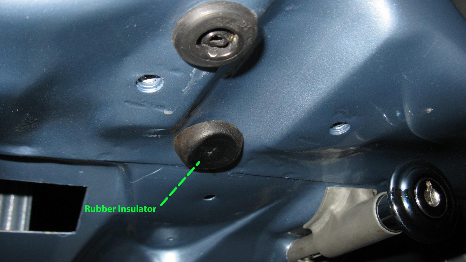

So, first check the column is mounted correctly. At the firewall the column is supported with a rubber insulator shown in the picture below. The outer column must not touch the inner shaft throughout the rotation of the steering wheel, if otherwise the circuit may find a ground connection and cause random horn soundings when steering around corners. The steering shaft must be straight. This is not usually a problem for the early single piece shafts but later shafts made with a safety collapsible/shear section may have become slightly curved and cause the issue. The shaft might need straightening but exercise caution around the structural integrity of this safety feature. Get a good replacement if required. The position of the steering box also has influence on the shaft centreline within the column. You might have to loosen the steering box to reposition it to the optimal position. This will further require a re-centring of the steering mechanism. Be careful with the steering mechanism, your safety depends on it. Also marked on the picture is the other end of the brown wire from terminal 85. It must go on the small spade lug at the end of the column. Make sure there is no dirt or paint that would prevent a connection.
Underneath the dash is a rubber pad that stops the column rubbing thorough the paint and inadvertently making an unwanted connection.
The top of the column is held with a bracket that envelops a rubber ring. The bracket squeezes the rubber which grips the column and maintains electrical isolation to earth. I don't have a better picture of this but trust me, it is insulated in there.

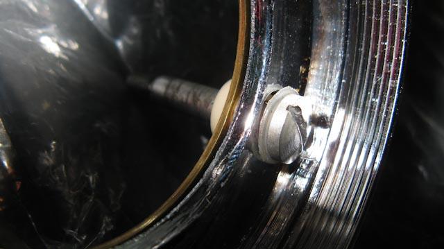

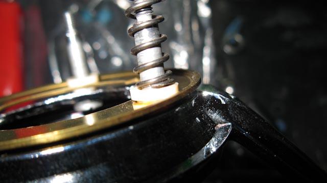

Part Seven: The Horn Button.
The horn button is a stack of springs, insulated washers and contact rings. It is best show in photographs
Below is a view of the Horn ring, contact ring, insulated washer and machine screw in the correct order.
This is the same thing but from the under side with the spring added.
And the view before it is all screwed in to the steering wheel
Finally we see the Horn ring, contact ring, insulated washer, spring and machine screws in place on the steering wheel with the wire attached to its terminal on the horn ring.
