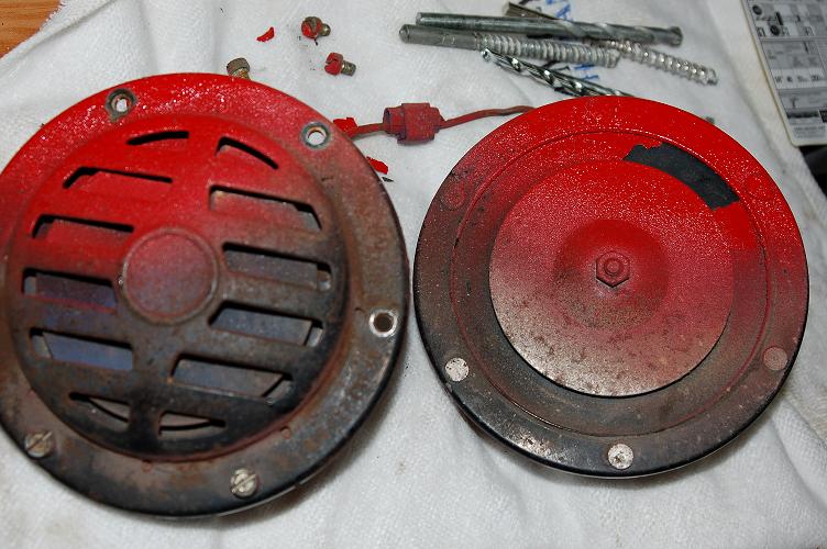

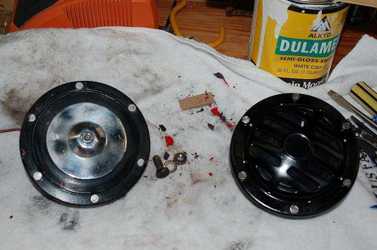

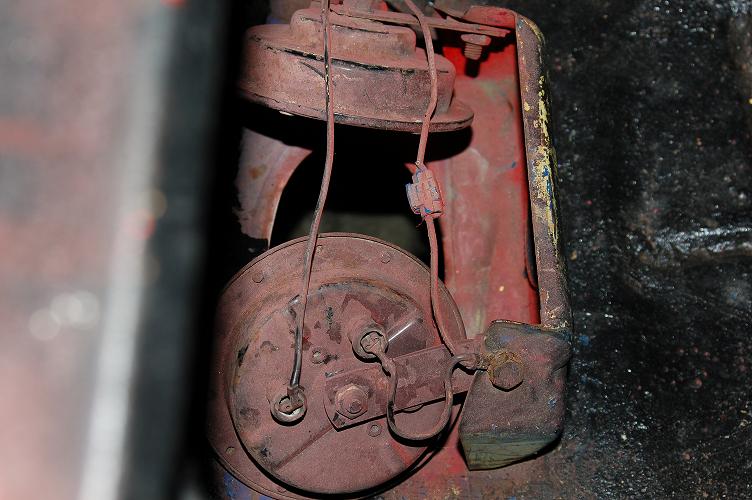

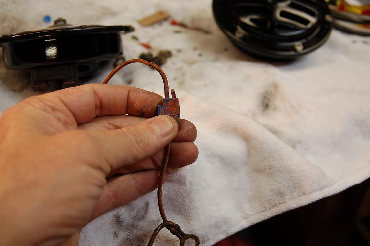

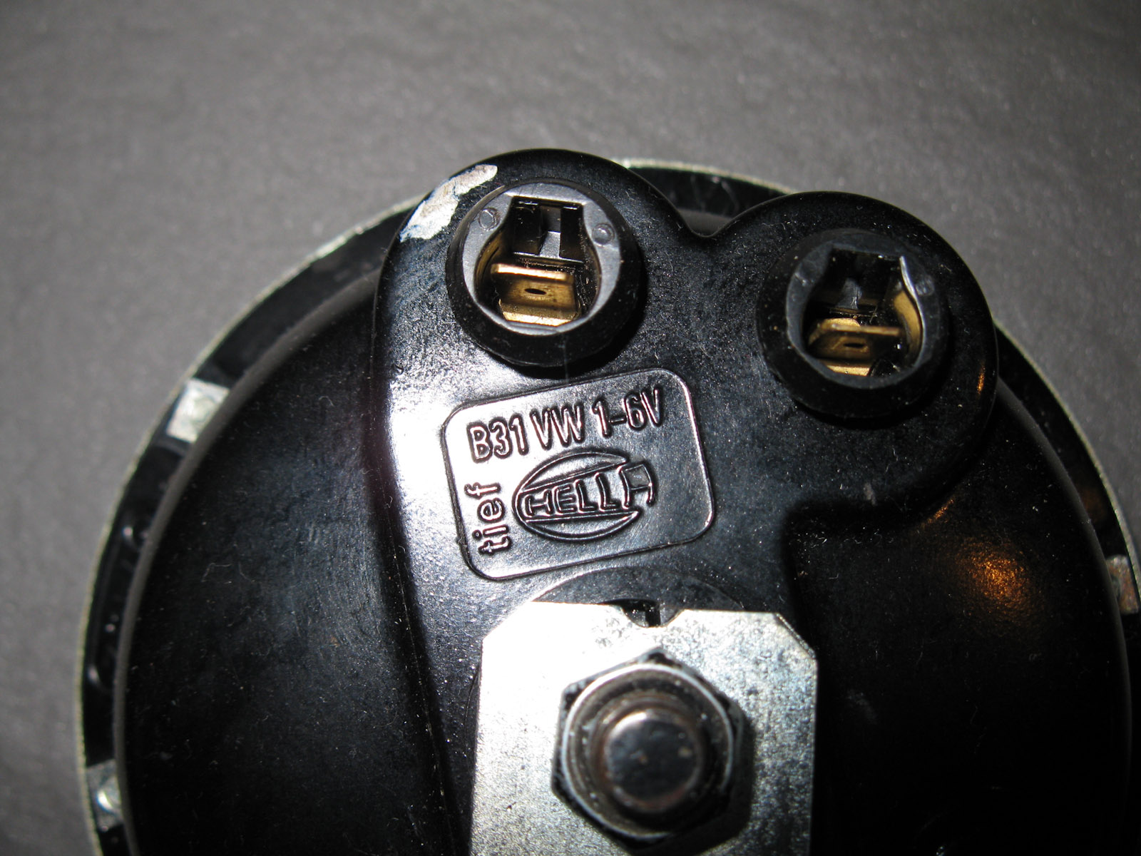

I thought some of you might like to see the clean up I did on my horns today. They were covered in dirt and overspray, and the PO had been running without a horn boot for some time, so the spare tire well was filthy and the dash leaked like a screen door. I thought I would fit a boot, and from what I can tell, it is easier with the horns out. Of course, I had to clean up the assembly before I put it back. It was not too tough to fit the boot with the horns loose (have not put it back in the car yet, though).
One question - in the bottom pic, there is a snipped wire - any idea where that goes? Horns seemed to be working OK.
thanks

what the heck is the splice connector on there for?
Nice job and how does it sound?

Good question! I assume it is not meant to be there, so having the wire snipped is a non-event?
I do not have these back in the car yet (I live near DC, and we just got 2.5 feet of snow, so we have been busy).

two horn grounds go together, two positives go together. see your bently manuel, or go to on line karmann ghia resource.

Did you dismantle, clean, and then paint them? A step-by-step set of photographs of that would have been nice. They look good.

I did not do a step-by-step, but that would have been a good idea.
I do have a couple extra pictures, including the horns in situ and from the front.

Ghia horns do have a healthy "bark" to them, don't they? Wink
Also that plastic splicer is called a scotch-lock or something similar.
A quick and nasty way to tap into an existing wire. No, they don't
belong anywhere on a Karmann Ghia or any other car for that matter.
The poor connection it provides degrades quickly and you will be
chasing intermittent electrical gremlins.

Thanks for that. I did look at the wiring diagram, and was going cross-eyed trying to figure out what that thing was doing there.

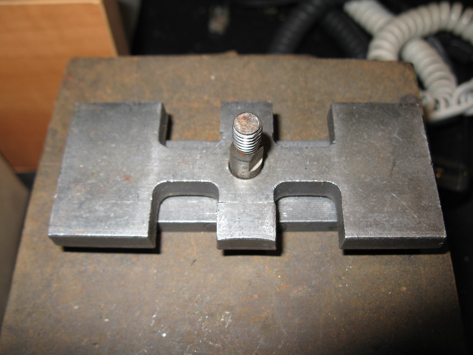

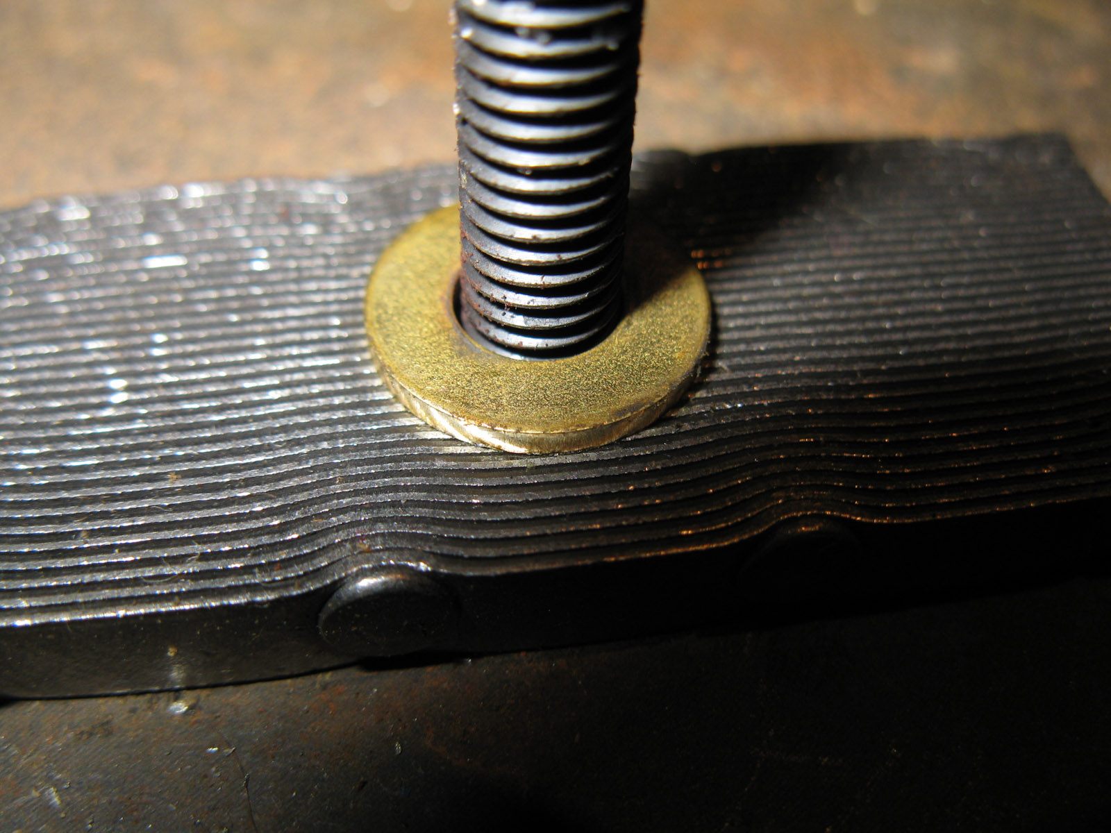

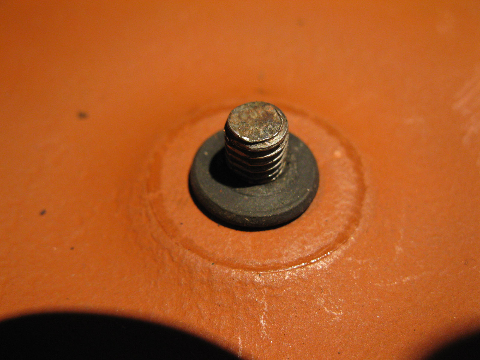

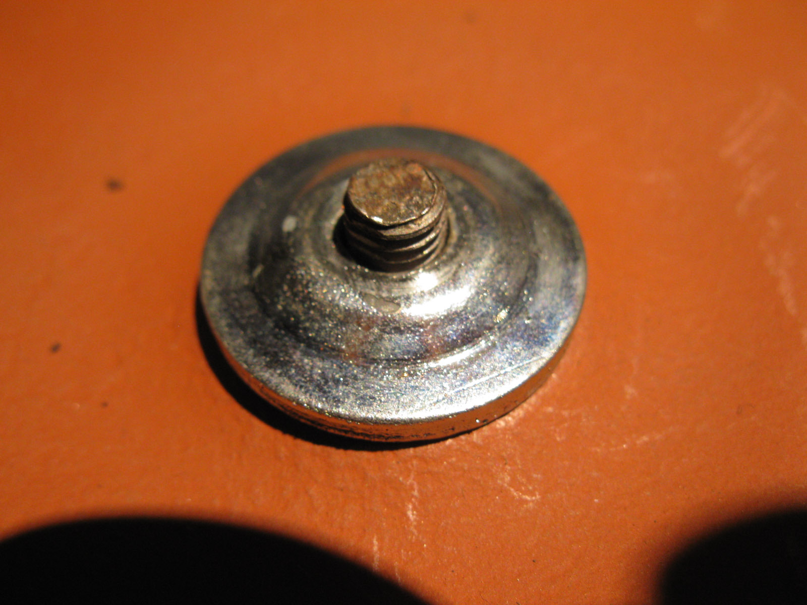

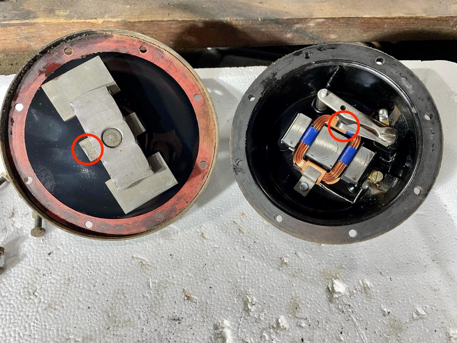

Here goes a Photo essay of a horn refurbishment.
First I'll point out a few identifying details.

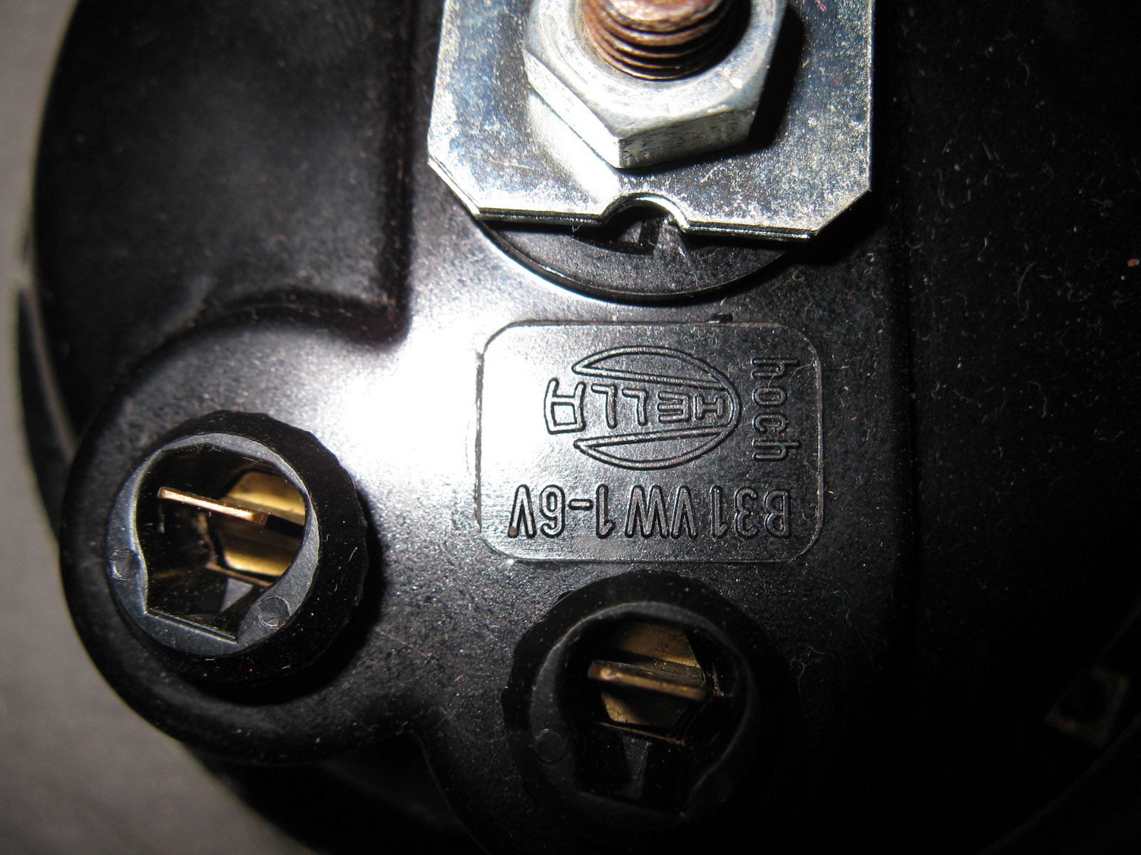

The horns are designed to run as a pair. One has a higher tone than the other. Look for the words "hoch" or "tief" on the back of the horn. You want one of each, not both the same.
This one is a cleaned up "tief" which is the lower pitched horn
This one is its sister a "hoch" and is the higher pitched horn
There is only one adjustment in the horn that is set once and sealed over with wax or glue. You have to dig it out with an Exacto knife or similar
....and you reveal the adjusting screw mentioned in earlier posts.
The stamp on the back verifies if it is a 6volt or 12 volt and if it is a high (hoch) or low (tief). The stamping on the edge is somewhat meaningless since it says 6v-12v hoch-teif along with part numbers.

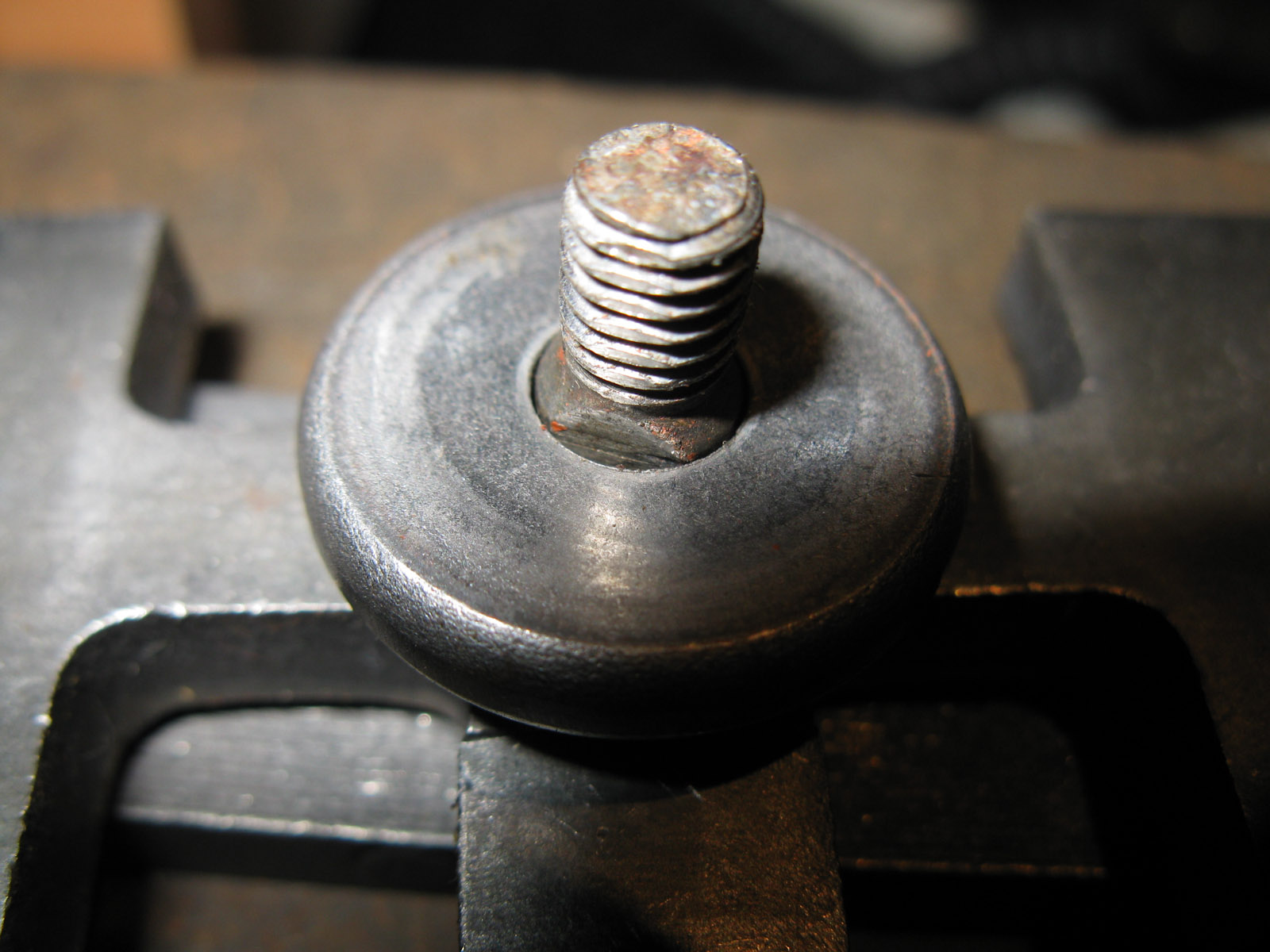

Remove the 8 screws and nuts on the lip of the horn. If there is a lot of crud, soak the nuts in oil to release them.
The metal front will lift off to reveal the diaphragm underneath. Lift the diaphragm off the back part and take care to not damage the gasket. There might be two gaskets depending on the particular batch your horn is from.
If the coil inside is damaged there is nothing you can do to fix the unit. Use a multimeter (ohms range) to verify low resistance at the screw terminals circled in red. If you have an open circuit you're out of luck.
In this photo you can see how the adjusting screw controls the tension of a spring that positions the actuator. Next to the coil you can see the contact points. The adjusting screw can be rotated so the contacts are closed and then the multi-meter will read a low resistance. If you have contact and still a high resistance then running a narrow strip of 1200 grit emery can effectively be used to clean the contacts. Just push them apart, slip the emery in, pull it back and forth for a few strokes then turn the emery over it over and repeat. Don't take too much off. If the multi-meter still reads high then the coil is probably no good.
This is a view edgewise of the diaphragm with the armature assembly on its inside.
To disassemble the diaphragm remove the nut in the centre. Once again you might best use some oil to soak the crud loose
Lift out the Cup washer beneath that.
Remove the rubber washer noting there is a lip on the top. Take care you don't damage this washer. Later you should clean it in soapy water.
Lift off the diaphragm
Lift off the two brass washers

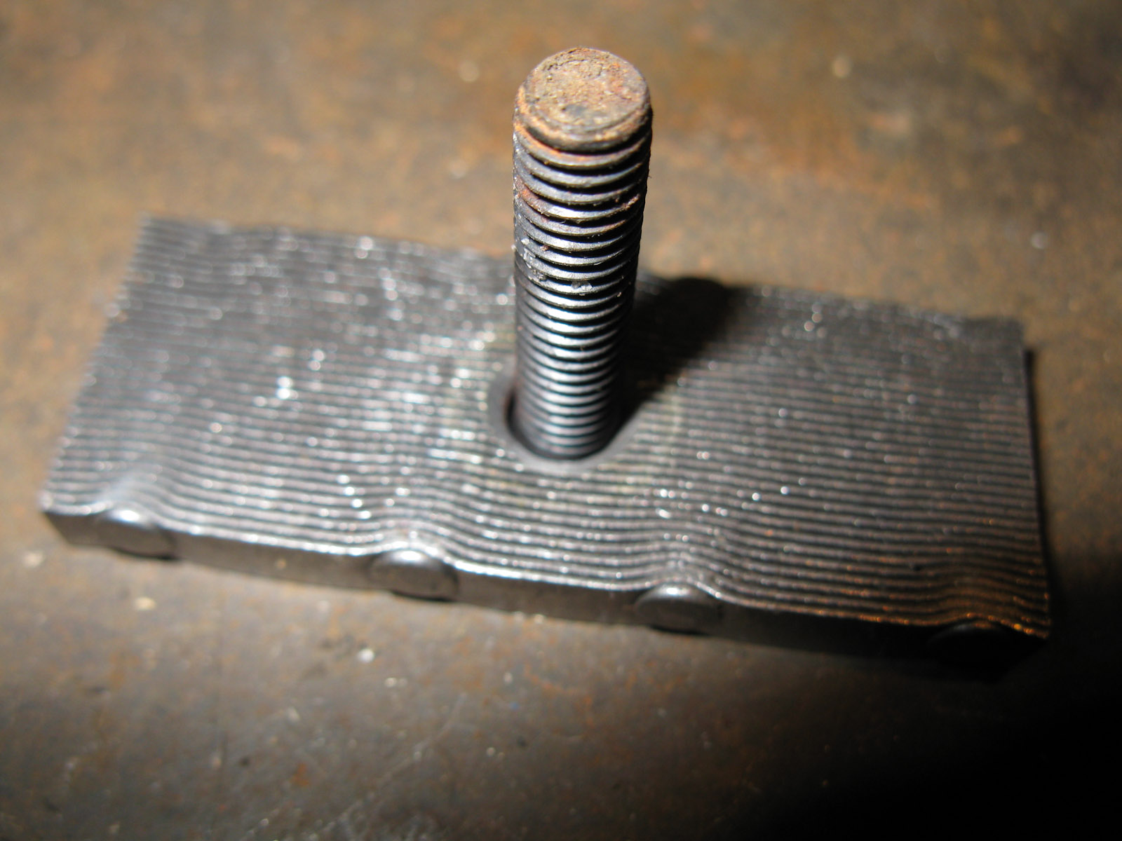

Lift off the first armature piece
Lift off the thick brass washer
Lift off the last armature piece
All that remains is the centre screw.
This is the exploded view of all that...
Thoroughly clean all the parts. If you wish have the front cover electroplated with nickel. The cup washer could also benefit with that.
Use a wire brush to remove the plaque and then use some paint stripper to get rid of the old paint. A rattle can of rust preventative paint is fine for diaphragm. Use several coats on the outer face. The paint on my '66 ghia horns was a mid orange , but I've seen them in brown. Usually it is a semi gloss paint.
The next set of photos are reassembling a horn from my '66 ghia. You will see slight differences in the parts compared with the disassembly photos. Don't worry about that too much. Its the same design and they go back in the same order.
Start with the centre bolt

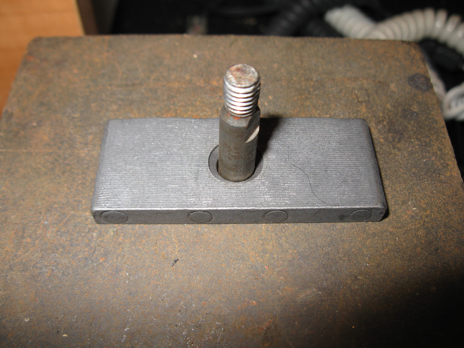

Lay the first armature piece over it
Find the thick brass washers
... and lay it on the armature piece
Place the second armature
Find the two thin brass washers
... and lay them on top.
find the cup washer and lay that down on top
Get the diaphragm and lay it on next. Pay attention to getting around the right way. The centre around the bolt should cup upwards or face the outside of the horn.
Next is the rubber bush..
... and the outer cup washer
The nut goes on next but before you tighten it make sure the holes line up properly with the armature... at the 12 o'clock and 6 o'clock positions.. like so...
After tightening the diaphragm assembly , get the horn cover ready. this one has been nickel plated for looks and durability. If you wanted to paint it, do so in a black semi gloss that is rich in zinc and rust inhibitors.
Lay the diaphragm on the front piece, aligning the holes.
Lay the paper gasket, also aligning the holes.
The alignment is somewhat critical and it will line up without effort if you have diaphragm and armature properly aligned per the earlier step. Nonetheless this next photo of a 6 volt unit (photo acknowledgment to Trylon) shows where the armature will push against the contact lever and open the electrical circuit. These have to line up or the horn won't work.
Another thing to note is the location of the contacts that sometimes foul up and may need to be cleaned with bit of emery paper rubbing between the contact faces. Those contacts are next to the red circle on the right side of the photo where the coil part of the magnetic circuit is. The contact arms can be pushed apart to make the required gap to slip the emery piece between. The spring tension will likely provide sufficient force to pinch the emery so a few strokes are enough to get the desired result.
Lay the back section next and feed the screws in from the front.
Secure the nuts first and then tighten the whole lot up.If you want use some Locktite to hold all the nuts in place.
This is what a fully refurbished unit looks like...
Now go forth and sound your Klaxons!!

Nice detailed info on how to fully take the horns apart and reassemble.
THANKS, nice job!!!

PostPosted: Mon Sep 06, 2010 9:33 am    Post subject: horn refurbishment/ wire question Reply with quote
to answer bunkingtons question about splice connector, the wire goes nowhere. would guess og wire was cut in the past and connector was expedient way to join 2 pieces of wire. I would either make up new wire joining the 2 horns and ground or solder connect where the connector is now as those kind of connectors aren't too reliable in the long run
