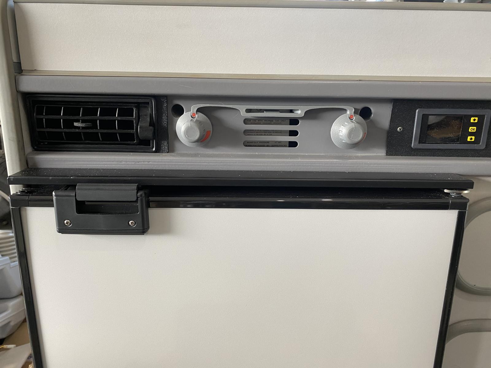

PostPosted: Tue May 12, 2020 4:42 pm    Post subject: Re: Building a bus for travel in Europe Reply with quote

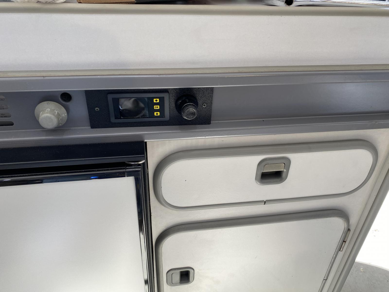

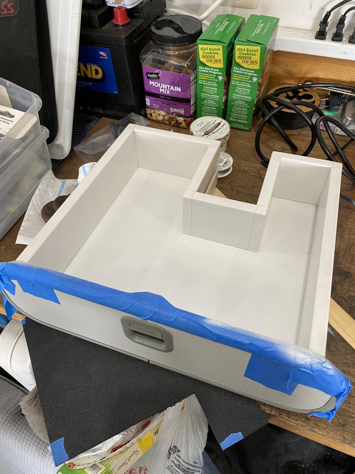

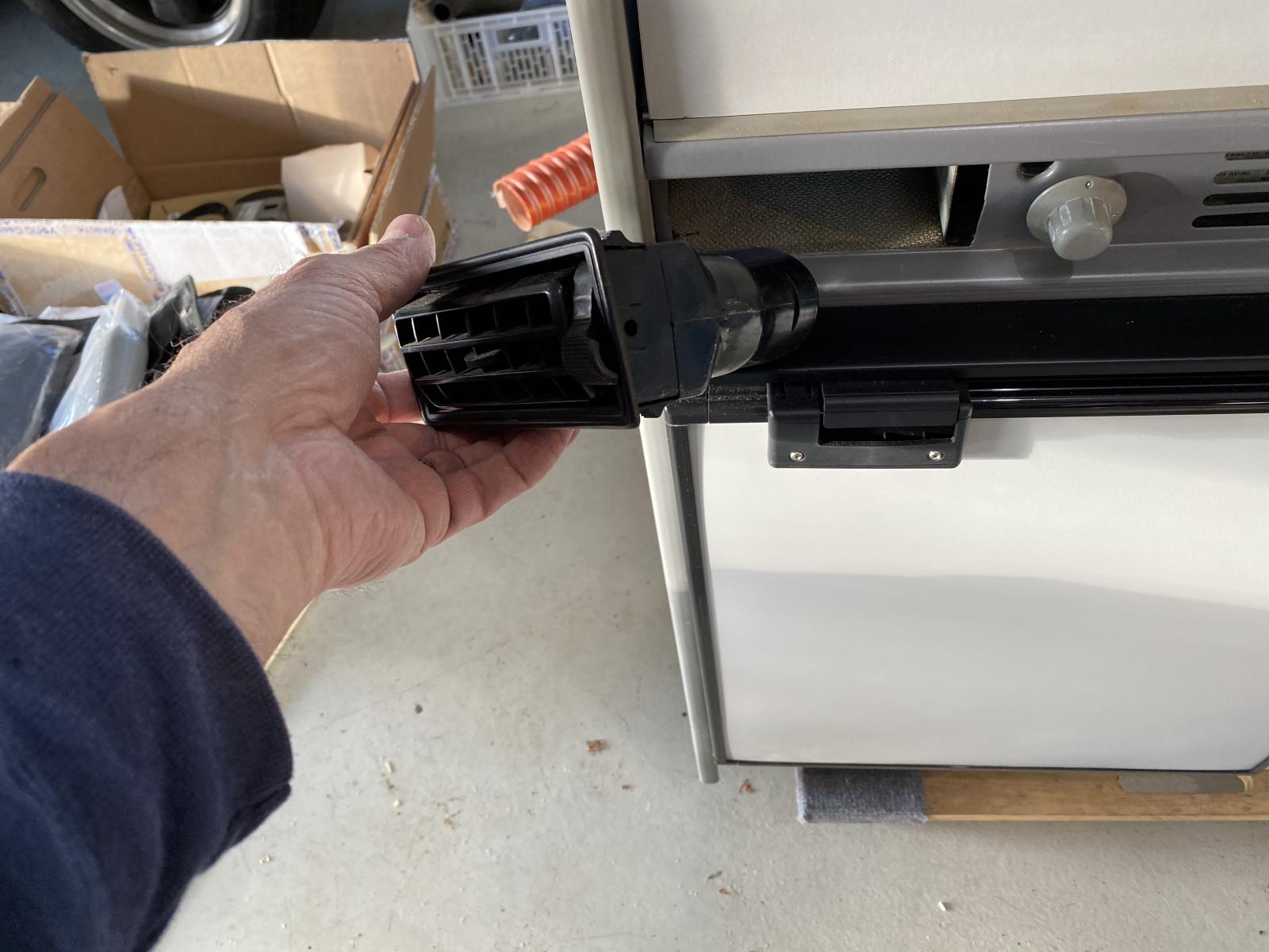

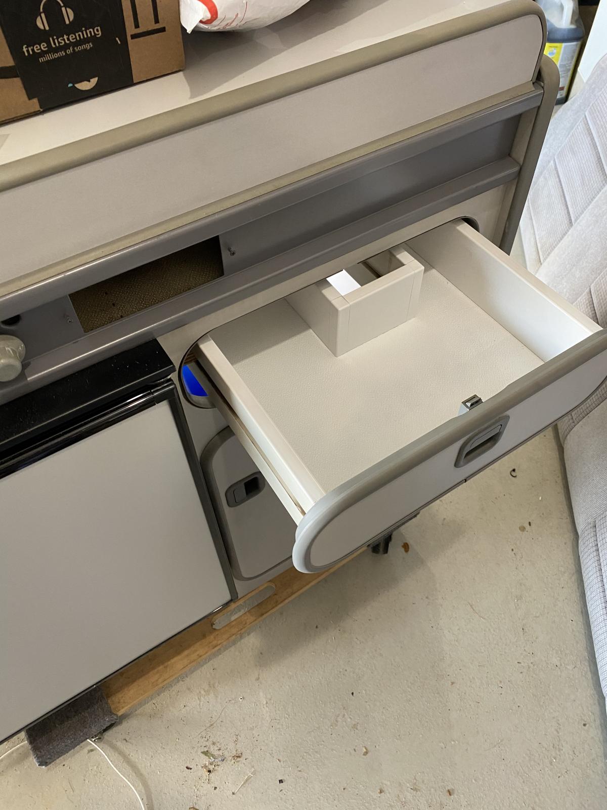

Still working on the kitchen unit.

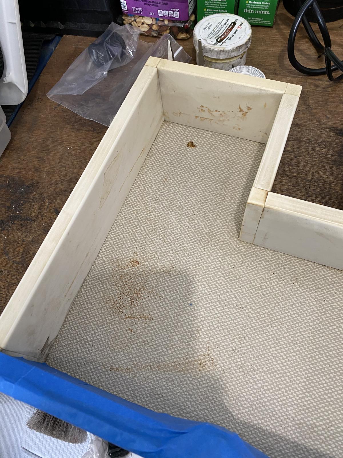

Used some of the SEM Vinyl paint I bought to redo the headliner on the drawer to freshen it up.
Made a black plastic plate so I could install the burner piezo ignitor and a battery monitor system.
Installed the heater vent and ducting into the kitchen face plate.
Dave O

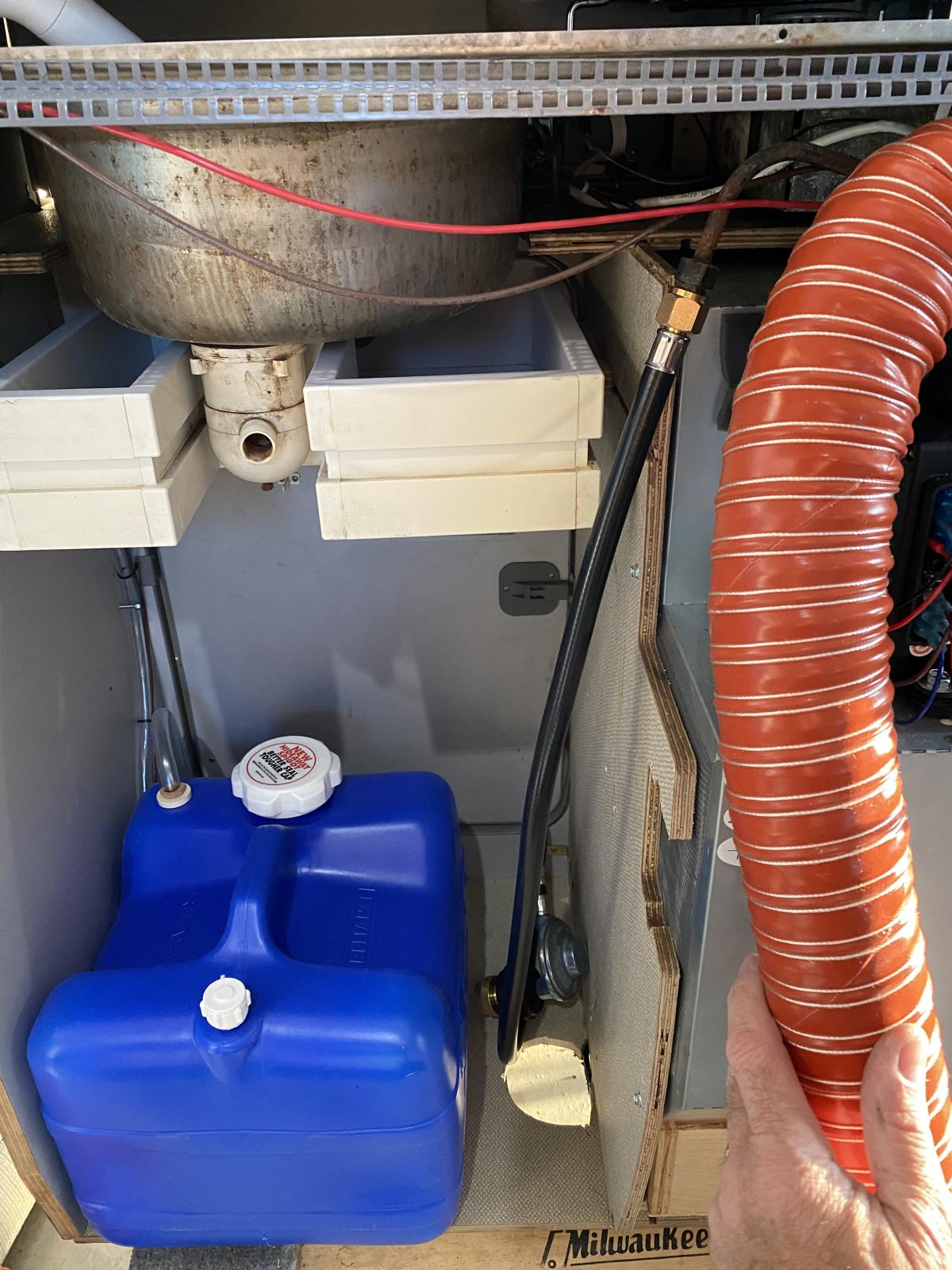

PostPosted: Tue May 12, 2020 4:47 pm    Post subject: Re: Building a bus for travel in Europe Reply with quote

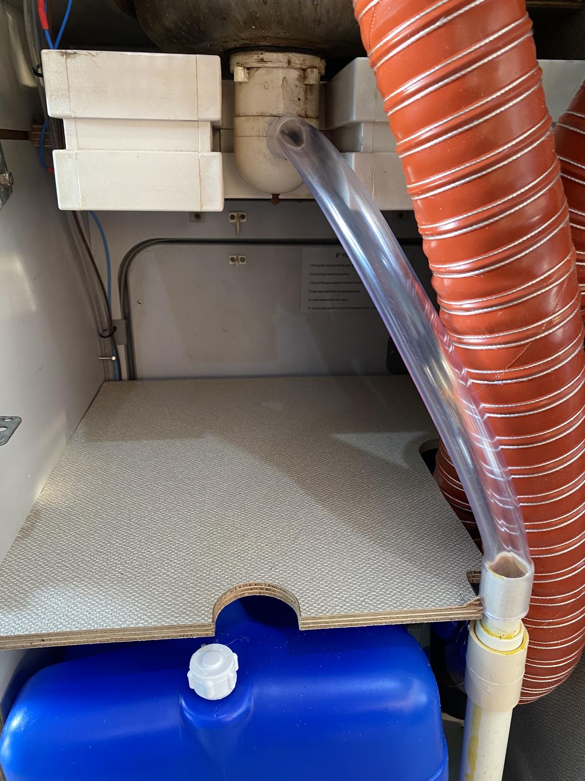

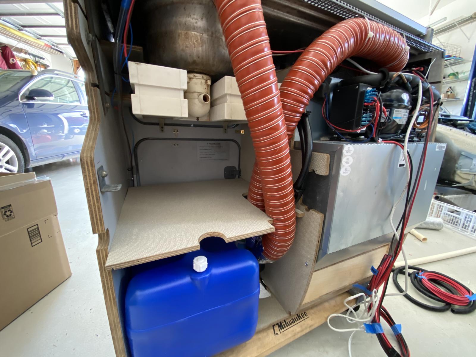

Today I added the regulator and hose with adaptor to use 1lb refillable bottles for the stove.
Cut the shelf to fit the heater hoses.
And added the drain plumbing. (Still need to connect the P trap to the drain tube, need to find a 1 inch flexible tube.)
Man there is a lot of functions contained in that westy kitchen unit....
Dave O
The Western Syncro build

PostPosted: Tue May 12, 2020 7:14 pm    Post subject: Re: Building a bus for travel in Europe Reply with quote
1) The painter drawer looks great, better than expected.
2) I love the heater vent in the kitchen faceplate.
3) Given all the fancy Victron bluetooth battery devices in your van, what are you monitoring on the kitchen faceplate battery monitor? Is it just one more for fun? A different battery?
- Jim

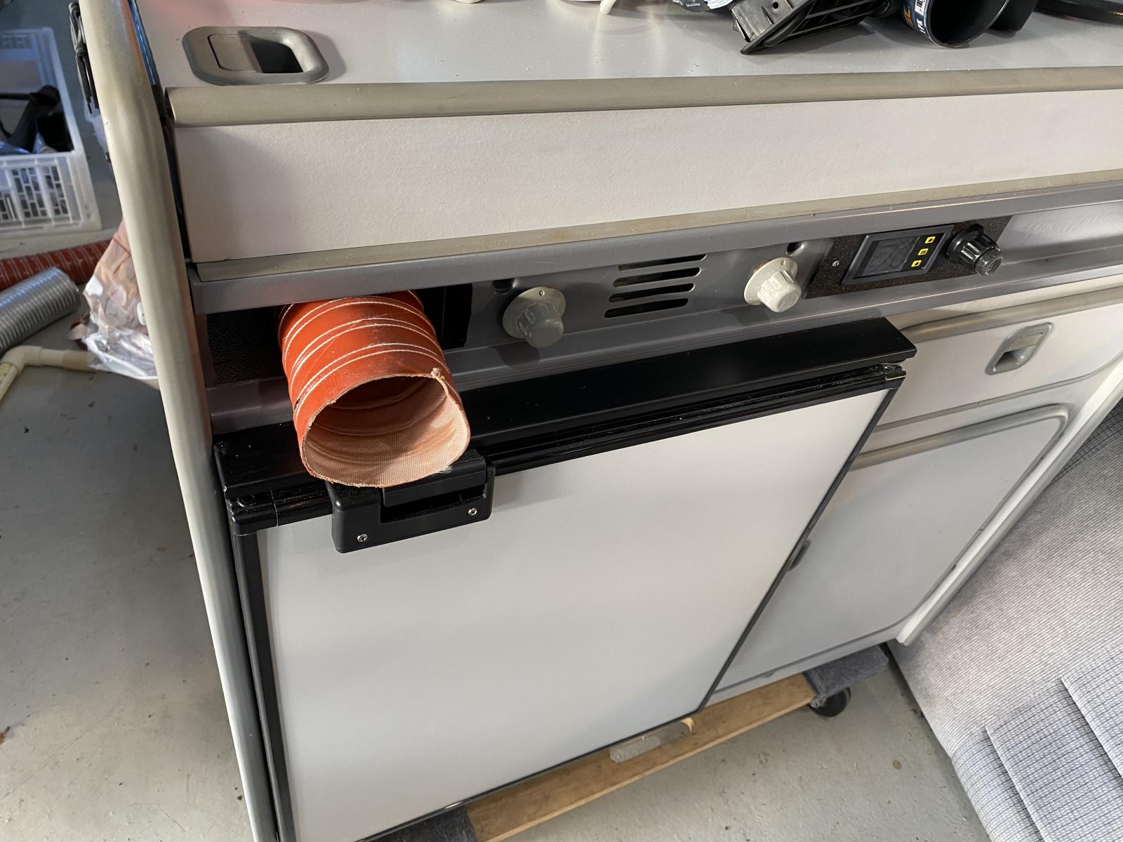

PostPosted: Tue May 12, 2020 7:51 pm    Post subject: Re: Building a bus for travel in Europe Reply with quote
Agreed on the painted drawer.
This is one of my favorite build threads here on the samba. There is so much detail and thought put into this build. You can clearly tell it is his second Vanagon.
I have never seen anyone output heat through that area on the stove. Really cool.

PostPosted: Tue May 12, 2020 8:13 pm    Post subject: Re: Building a bus for travel in Europe Reply with quote
^ Those two just said it, but the heater vent out the front of the cabinet is just icing on the cake. That kitchen unit turned out. Awesome work!

PostPosted: Wed May 13, 2020 5:01 am    Post subject: Re: Building a bus for travel in Europe Reply with quote
It will give house battery voltage and amps in/out of the batteries. Just an easy way to see how it is doing load wise. (It can also do amp hr status of the batteries if I set it up properly.) Yep, another toy.... Very Happy
Dave O

PostPosted: Wed May 13, 2020 5:25 am    Post subject: Re: Building a bus for travel in Europe Reply with quote
I haven't either.
When I was noodling thru how I wanted to do the heat for this build I knew I did not want to outlet heat through the panel under the seat or anywhere near the floor. It really limits what I can put on the floor and can be a hazard if it gets blocked. After sleeping on it for a while I decided to look closely at the kitchen unit for opportunities. And this space turns out to be the perfect size. I have seen some folks put a cutlery drawer in that space so I kind of knew it was available.
I used silicon wire reinforced hose for heat resistance and durability. It fits the stock vents really well.
I have already done this mod to my '87 westy and I love it. Very Happy
Dave O

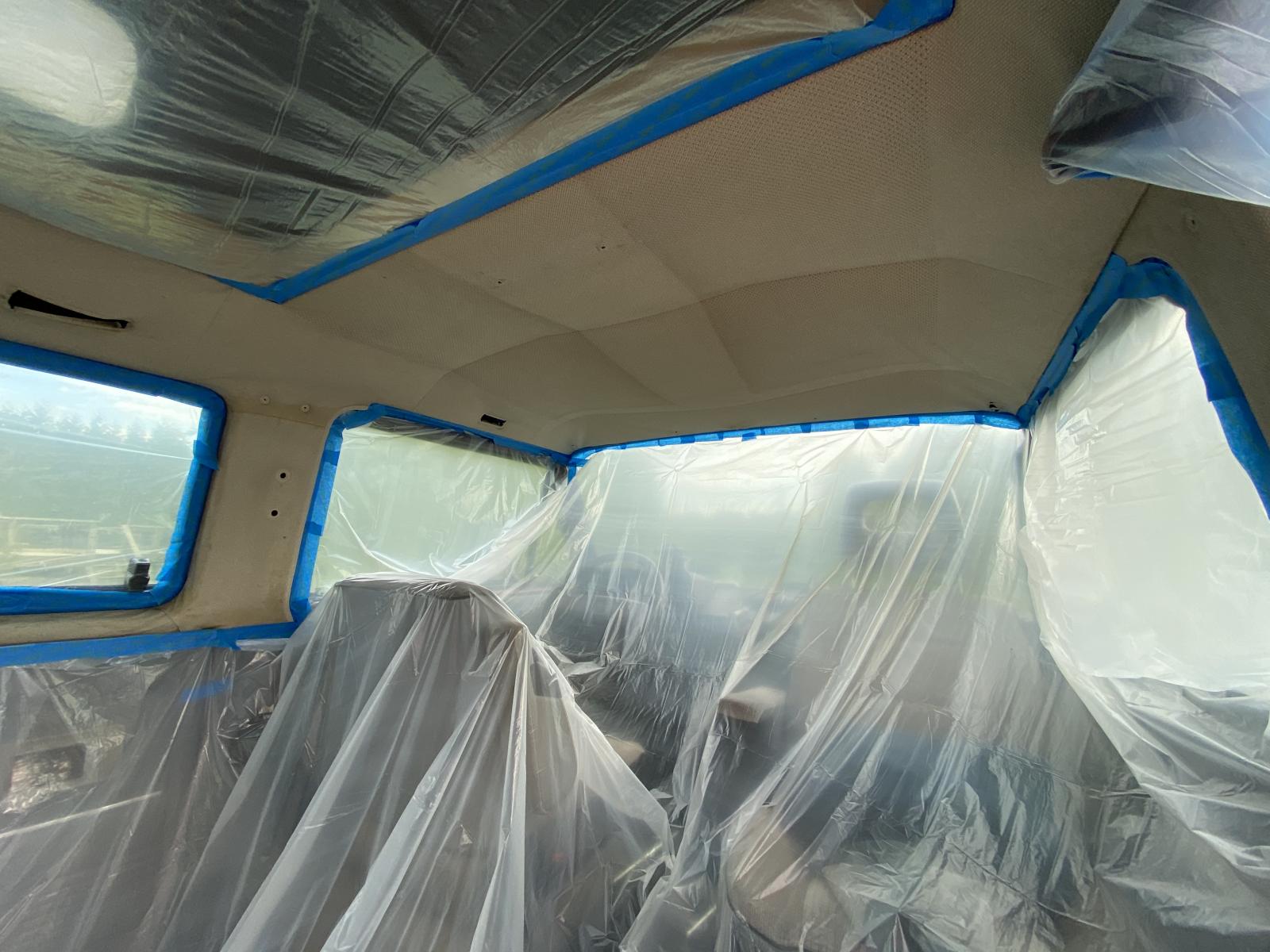

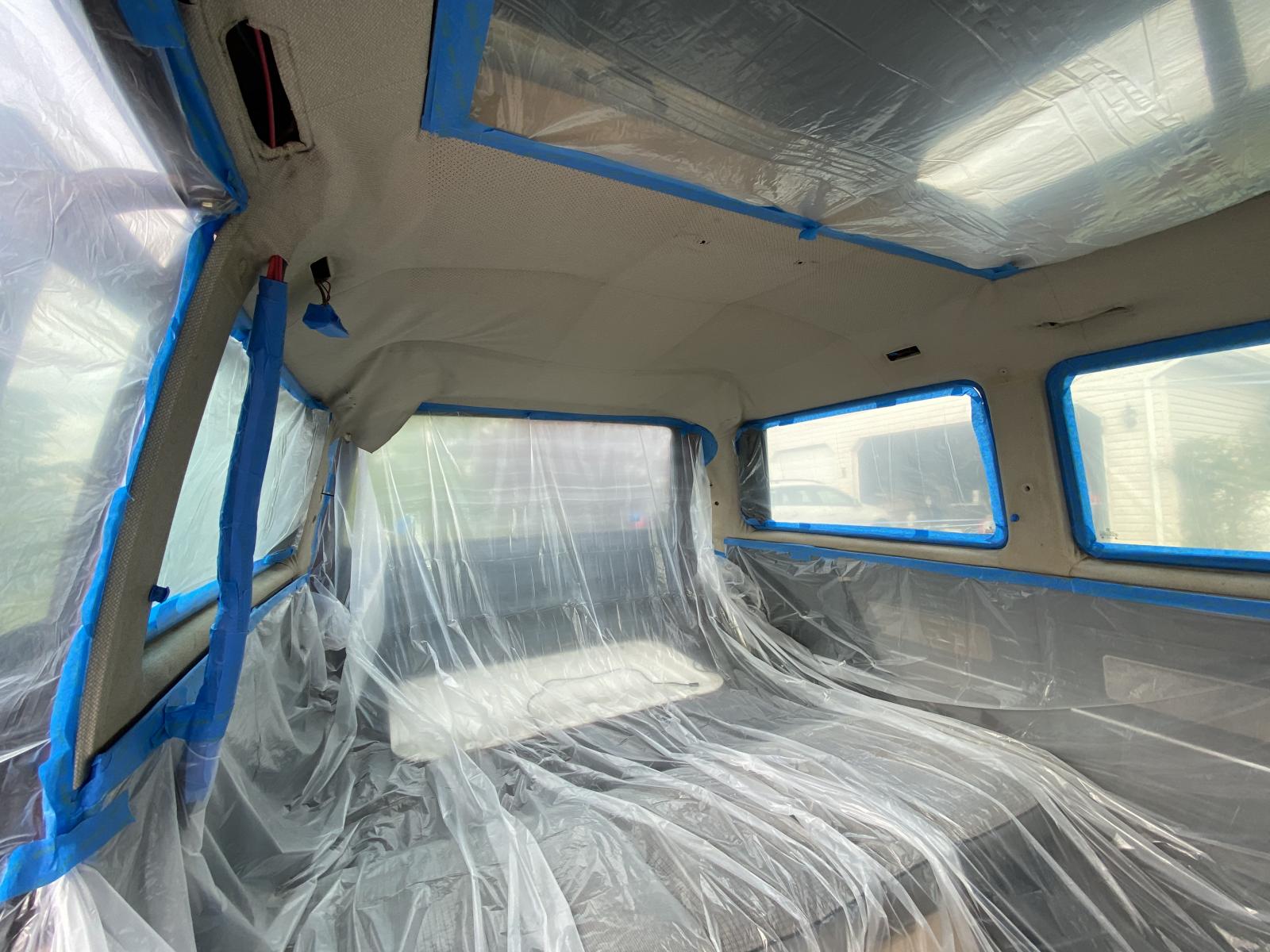

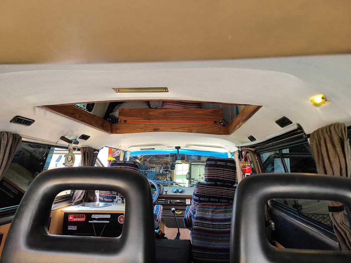

Starting to mask off the interior so I can spray the headliner white. The original headliner is stained and has a mark from where the old A/C ducting was.
Dave O
Hey me too! Are you using SEM vinyl dye? What shade?

Yep. SEM vinyl dye spray paint. Sailcloth White. I originally went with Silver Gray but I did a sample and it is too close to the gray cabinet shade. I wanted more contrast.
I’ll make someone a good deal on 6 cans of Silver Gray! Laughing

And I found that a 3/4” id vinyl hose fit the trap perfectly and by heating it with a heat gun I could stretch it over my Rube G plumbing pipe. I like it when I get lucky.

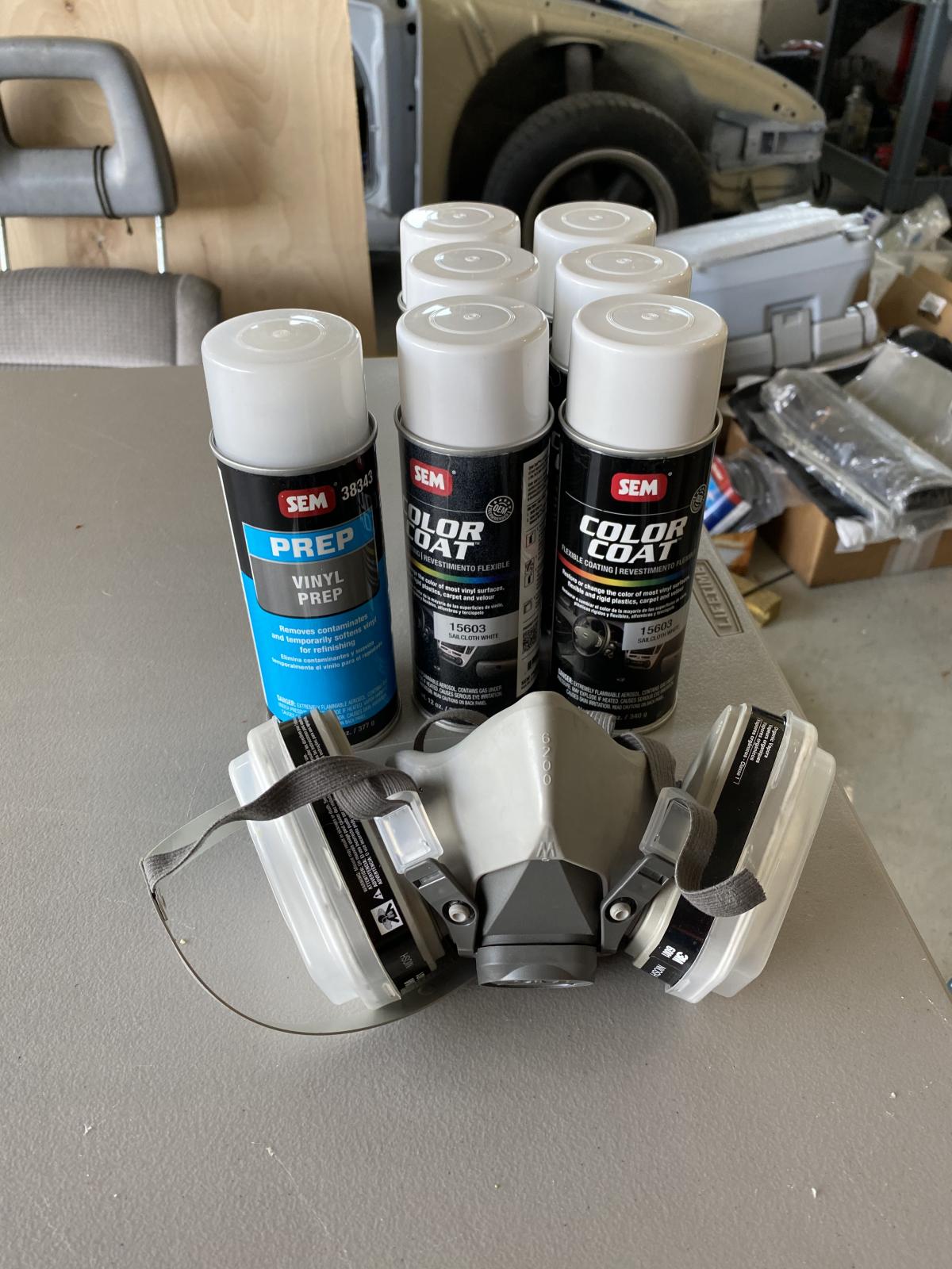

I ‘painted’ the headliner this weekend. I guess I really dyed it.
I used these products.
Masking everything off was a PITA.
It took all six cans of SEM Color Coat 15603 to cover the headliner. You apply in light/ medium coats and it takes several coats. I was getting about one coat per can. Glad I had six.
The result was excellent. But very white. Laughing

I did the same project on Saturday, although I'd already torn out all of the liner below the top window line so it wasn't quite as involved. It came out really nice though! It's a bummer how fast those cans go empty...
