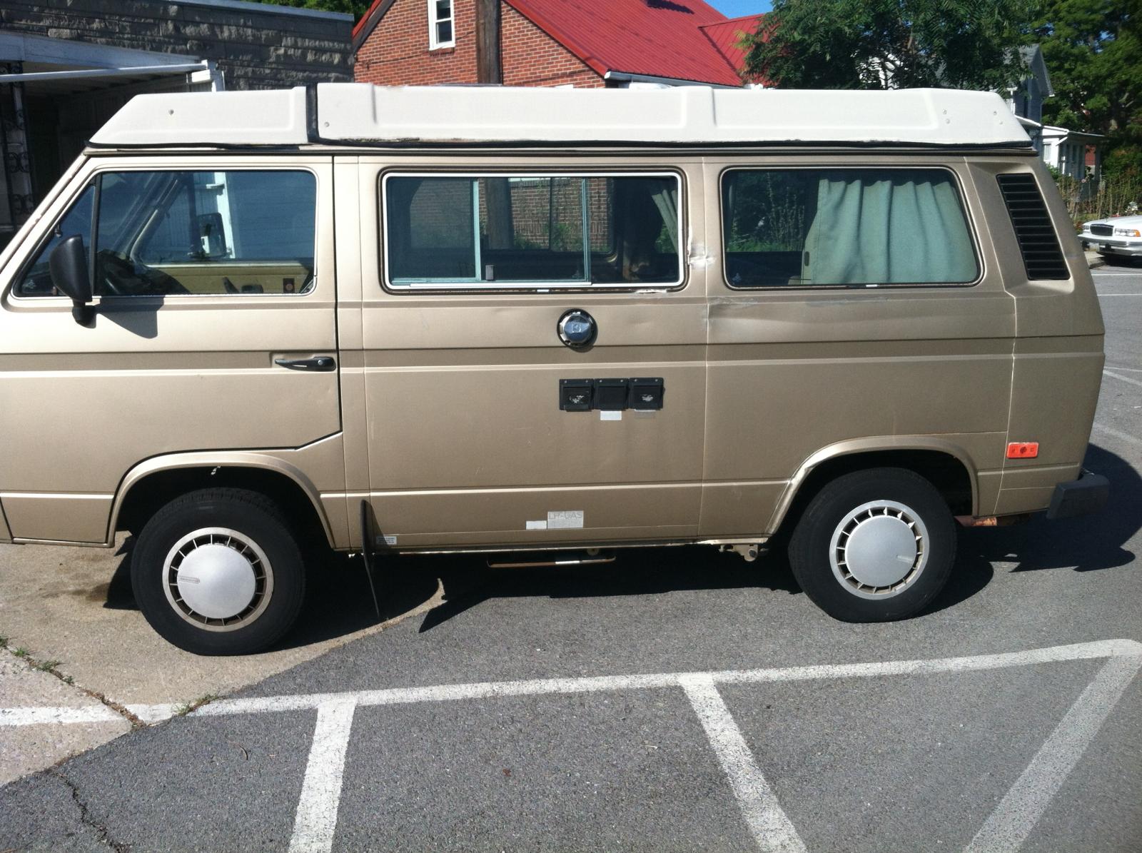

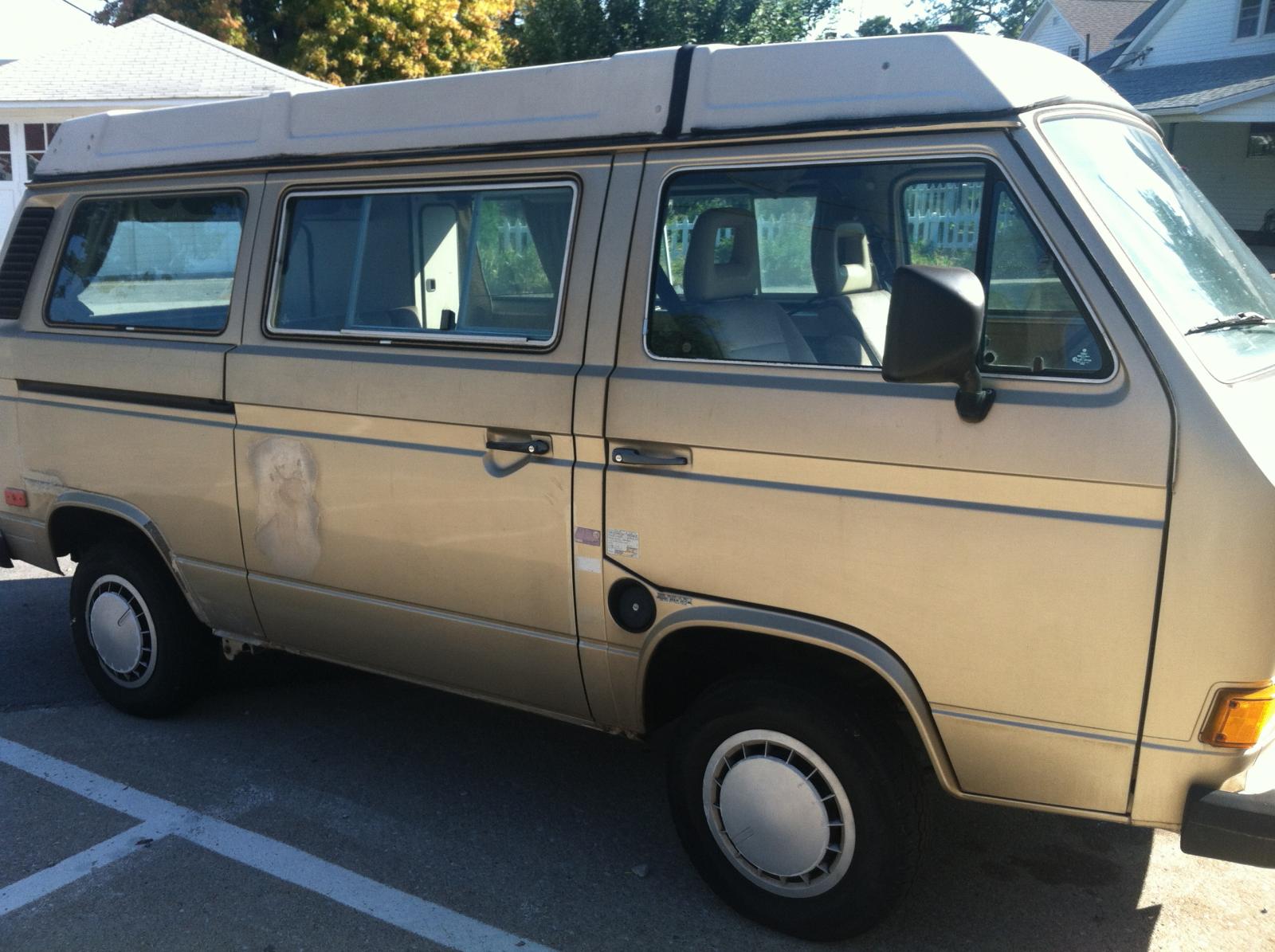

Here are some pics of 'Lady'

nice Westy Smile
you have electric mirrors and AC, congratulations again

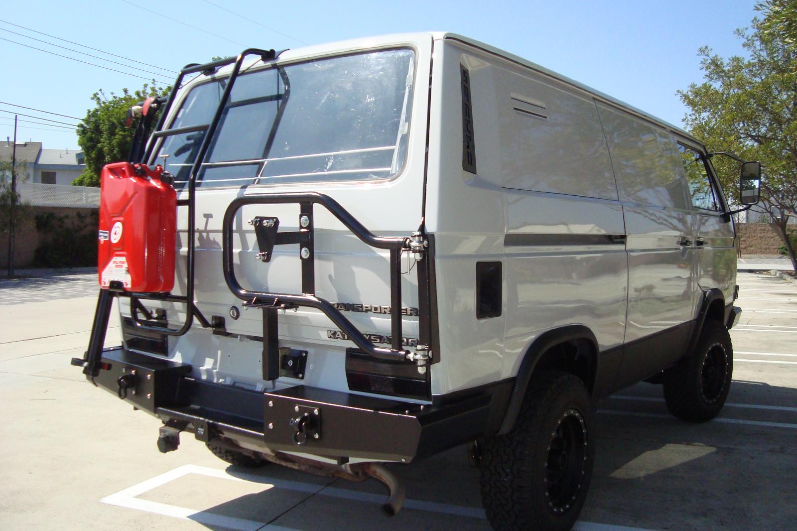

1991 Westy
goffoz
Joined: May 09, 2007
Posts: 1486
goffoz is offline
PostPosted: Mon Sep 09, 2013 10:31 pm    Post subject: Reply with quote
kryptkat wrote:
OK ..now thats a sweet van...very nice Very Happy
Tell me about those vents?
