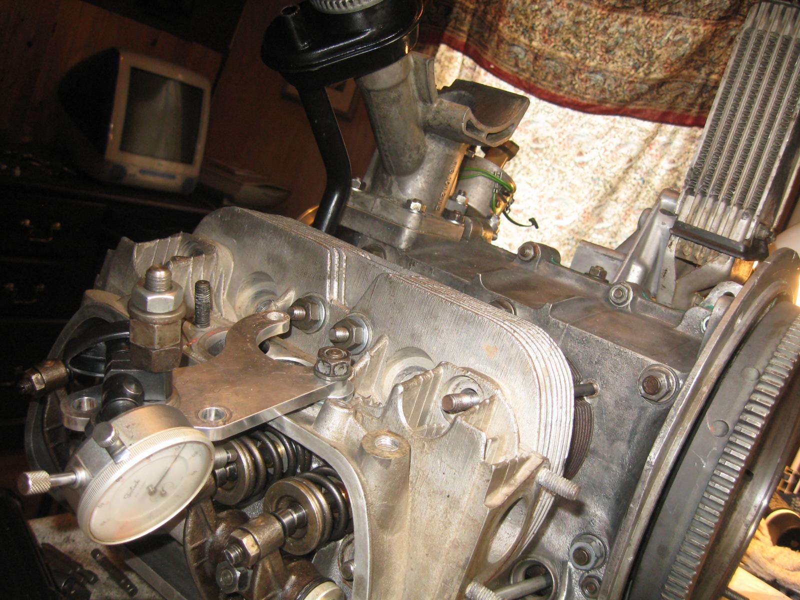

PostPosted: Fri Nov 30, 2018 6:22 pm    Post subject: Should I advance this cam? Reply with quote
Mock up with the W-100 cam looked like this:
Everything was measured @.050" valve lift and Zero lash:
VW Type 1 Engine 1679cc 1.1:1 Stock Ratio Rockers
W-100 Camshaft
Valve Lift (Intake .432"), (Exhaust .412")
Intake Opens 12' BTDC, Exhaust Closes 8.5' ATDC
Intake Closes 45' ABDC, Exhaust Opens 45' BBDC
Gross Cam Lift: Calculated .432"/1.1=.392" Intake
Gross Cam Lift: Calculated .412"/1.1=.375" Exhaust
Duration @50 12+180+45=237'
A W-100 Cam Card:
Mock-Up
Just took a look back at the Mock Up cam readings for this engine and You know, Is it off by 2' degrees? I think I will measure it again now that it's been running. Wondering if It would benefit from a 2' degree advanced gear?
1960 Beetle And 1679cc DP W-100 & Dual Zeniths!

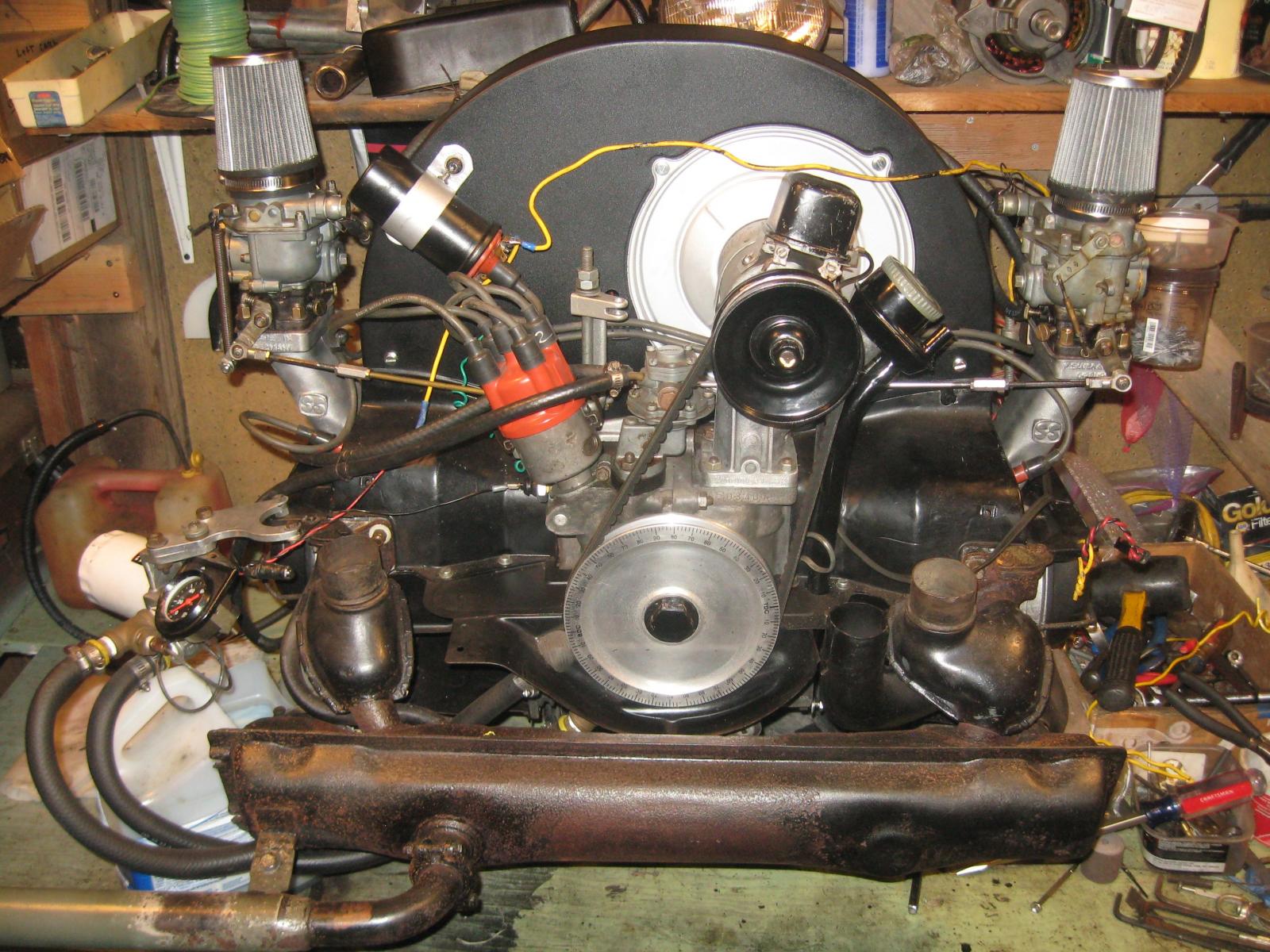

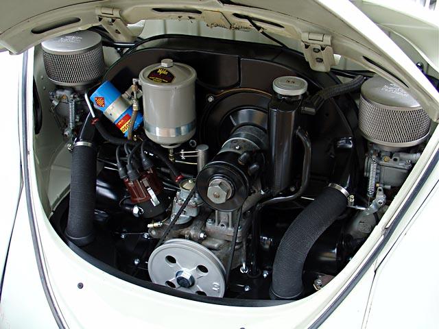

PostPosted: Sat Jul 06, 2019 11:35 am    Post subject: Sort of Vintage Look Reply with quote
Since my spare bus engine is kind of vintage looking I am thinking of making it look even more vintage and had some questions about fitting it to my 1960 VW Beetle while I rebuild it's 36 horse engine but will it fit?
Here "hlwimmer" posted a sweet Zenith Carbureatorated 1776cc installed in a 63 beetle and it seems to fit, looks like the firewall had to come out on the sides though, I took some measurements of my engine and it's going to be tight!
Here my Stock ish 1679cc sort of Vintage Dual Zenith motor. Any Suggestion on things to do as far as looks and engine compartment fit would be greatly appreciated.

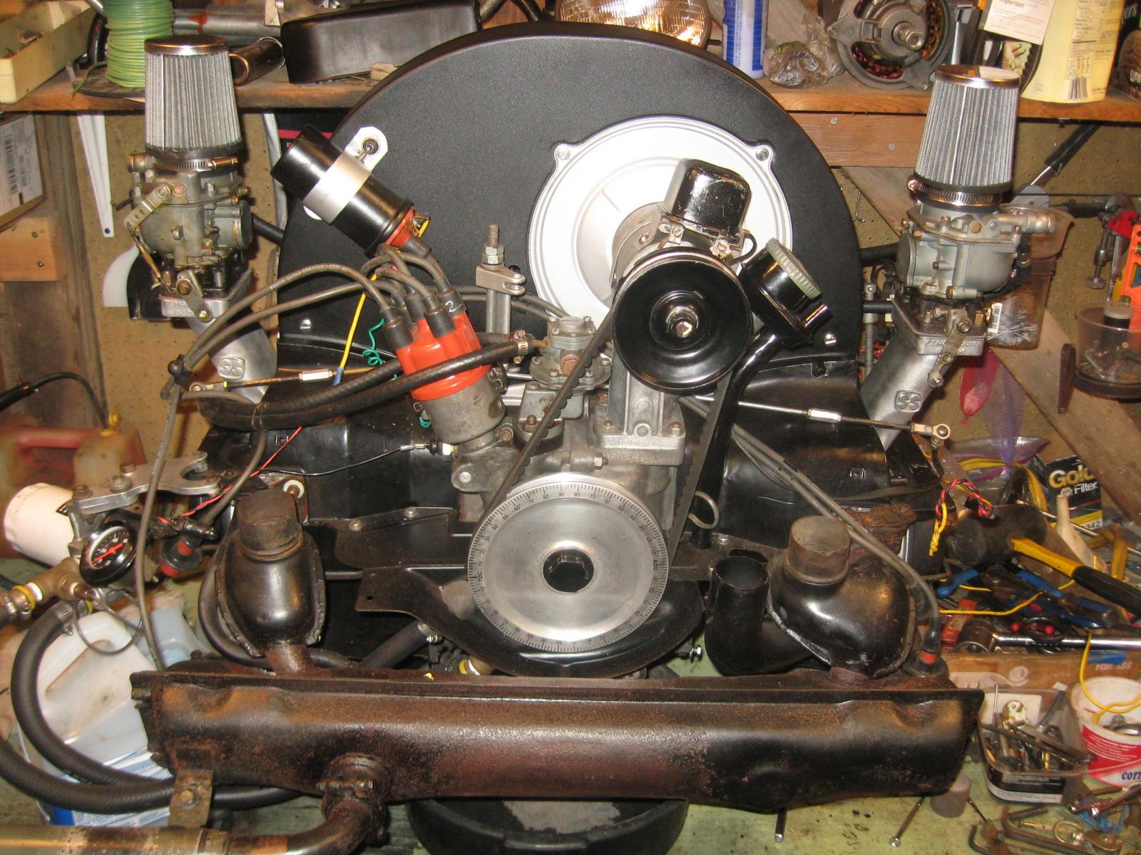

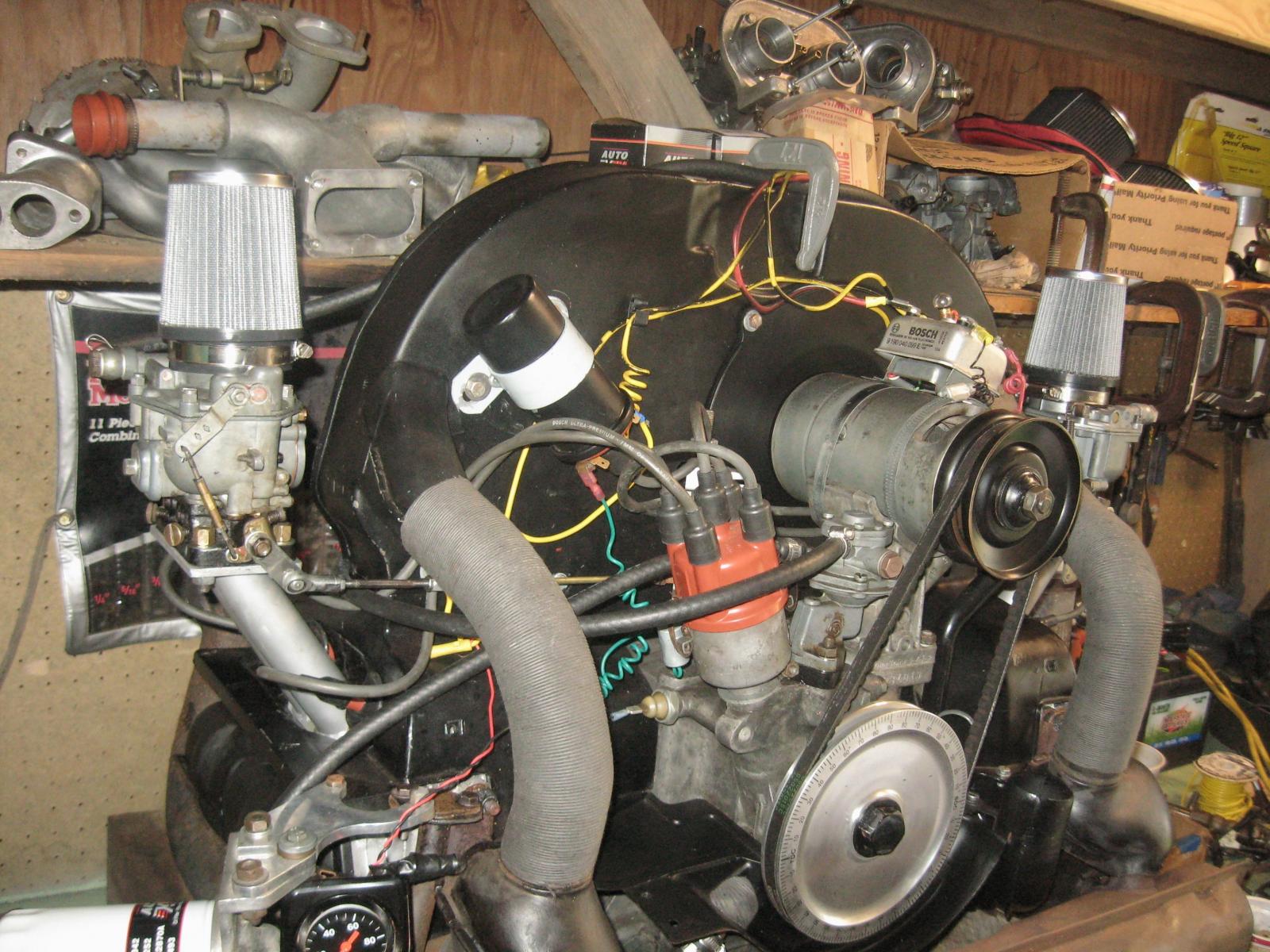

PostPosted: Sat Feb 15, 2020 4:32 pm    Post subject: Stock ish Type 1 engine configured for 6 volts. Reply with quote
So I have been playing with Engine configuration a bit for installing this engine into an early beetle. (6 Volt Generator and backing installed using CB 36 Horse Dog House):
35" Engine Width at Carbs:
34" Engine Width at Carbs with Sanders & Sons NDIX Aluminum Manifolds:
31.5" with the Carbs Reversed:

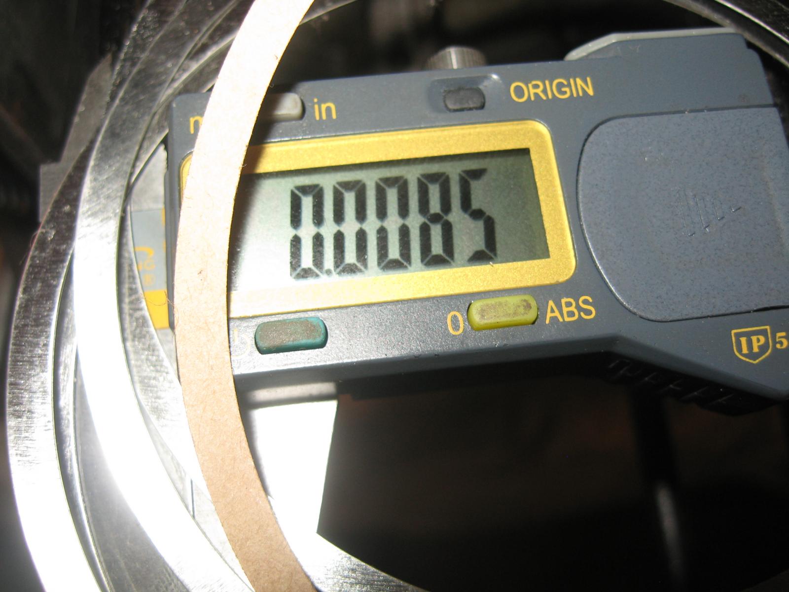

Ok the next thing I am trying to figure out is cylinder shims, My compression will be about right without them so I am wondering if should use metal paper or none at all and what to seal them with.
The Paper measures about .085" and the 10 thousands metal shims are actually measuring .012" to .014"
My Deck is measuring .050" without any shims or paper gasket.
Edit! In the final assembly no gasket was used.

1679cc Type 1 Dual Port Engine, Jtubes, Stock Bus Muffler.
I think it's running rich at least at idle! This NGK BP6ES Spark Plug was new, 150 miles on it now:
Dual Zenith NDIX 32 Carburetors Current Configuration:
35.5mm X 32mm Valves L3 heads,
W-100 cam,
Intake Manifolds: Vintage Scat Steel Dual Port to NDIX Scat Manifolds Now Aluminum SS Manifolds,
Dual Zenith NDIX 32 P010 carbs configured Porsche: L, R, No Crossover, No Chokes,
24mm, 25mm venturi's,
Jets:
180, 210 Air correction,
120, 115 main,
60, 50 idle jets,
55, 40 Accel Pump Jets, #2 Nozzles,
Long pump plungers, (Linkage leverage set long for least pumping).

PostPosted: Wed Oct 21, 2020 8:16 pm    Post subject: Re: Stock ish Type 1 engine for the 1971 VW Bus but put in a beetle! Reply with quote
Danwvw wrote:
Meant to run Brake-in Oil but forgot and wound up putting in More Castrol 5W30 and ZDDP.
Interesting that you went with the 5W30. I use to run the Castrol 20/50 but after reading lots of oil posts here I go with the Castrol 10W30 with the Lucas ZDDP. My builder is not very happy with that decision and wants me to run the 20/50, but I feel that’s too thick for a new, tight engine.
The routing of those oil lines near the J-tubes and those hose clamps on the fittings scare me. I’d be worried about burning through a line or having one of those lines pop off the fitting. I’m sure you’re aware that an AN fitting would be much more secure and if you are gonna run the lines so close to the exhaust, you might want to consider a heat shield for your lines.
https://www.verociousmotorsports.com/Shop-by-Categ...-Oil-Lines
Engine looks great! I wish you many happy miles with it! VW Logo

PostPosted: Wed Oct 21, 2020 8:39 pm    Post subject: Stock ish Type 1 engine for the 1971 VW Bus but put in a beetle! Reply with quote
In Colorado! Man you need light oil in the winter! 20 50 might work in a 21mm oil pump in the summertime. I've got a 26mm pump. I don't know, I guess if you have a burg oil pressure bypass valve on her. I don't!
Those lines scare me too! That's why the Aluminum foil! The An Fitting would be nice for sure. I am just running 2 hose clamps which actually is really strong. I think the heavy oil might work ok in Colorado in the summer if let Idle a bit before revving the engine if cold. My oil pressure spikes well over 60 PSI when the engine is cool with the 5W30 motor oil. But after just 1 minute of fast Idle it's manageable.
Good to hear from you Rich!
