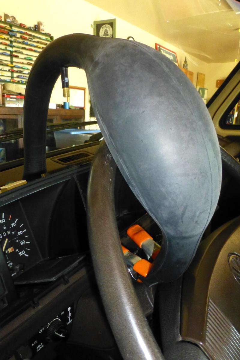

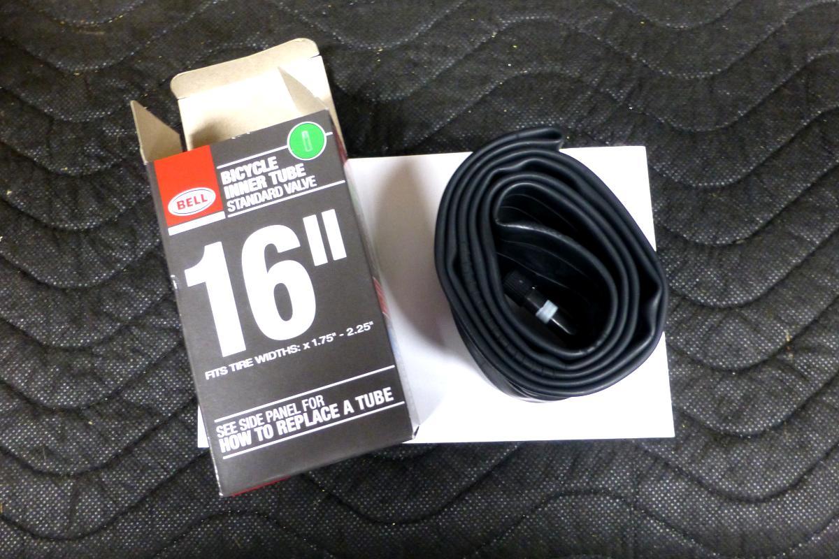

I use air only for pressure bleeding. Applied by attaching a bicycle inner tube to the top of the reservoir...
Then applying modest pressure (say 10-12 psi or so):
The inner tube I used (cut and one end clamped closed, the other affixed to the neck of the reservoir):
