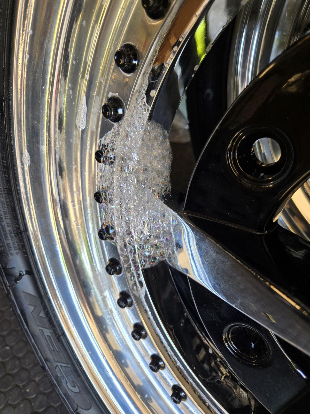

Buyer beware. I purchased a set of 3 piece radars 17x7s from Bruce on January 10th and was told to expect an 8 week turnaround. However I received them May 19th after getting the run a round,I couldn't believe what showed up. They were covered in greasy fingerprints, not a deal breaker. The crome finish had many flaws and divets, the front wheels had 2 valve stem holes in the inner and outer barrels with no stems or plugs for either, the back wheels had no stem holes at all and they sent 17x6s for the front. Took 2 days of running around to fix this issue. Finally got tires put on to only find that they leak everywhere ( see pictures) For $7k I would recommend finding another vendor.
On a side note, what I had to do since it took so long to get the wheels I disputed the transaction after 60 days and repayed him bc he said they needed more time due to moving. I received the wheels 1 week prior to the next 60 day dispute window. After all the run a round and not being happy with what I ordered I told Bruce I need to return the wheels, he said just hang on to them and he will send me replacements. By this time I'm on to his bs and this is a stall tactic for my dispute time to run out and considering what I went through and finally got I disputed the transaction again. Both disputes they lied and said I received what I ordered but the first dispute was bc I haven't received anything. Lucky for me I got free garage art, be careful y'all.
Poor quality, bad service and dishonest.
See pictures in gallery button below
