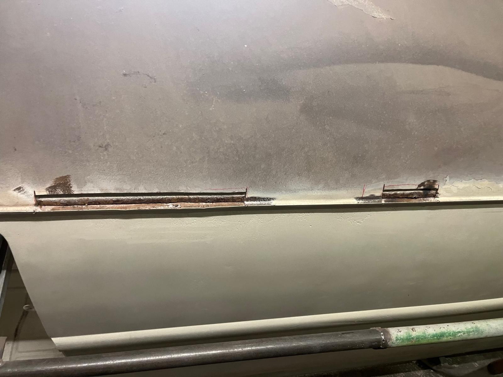

these are the last two spots that need welding on the body, there were some pinholes because of the sandblasting

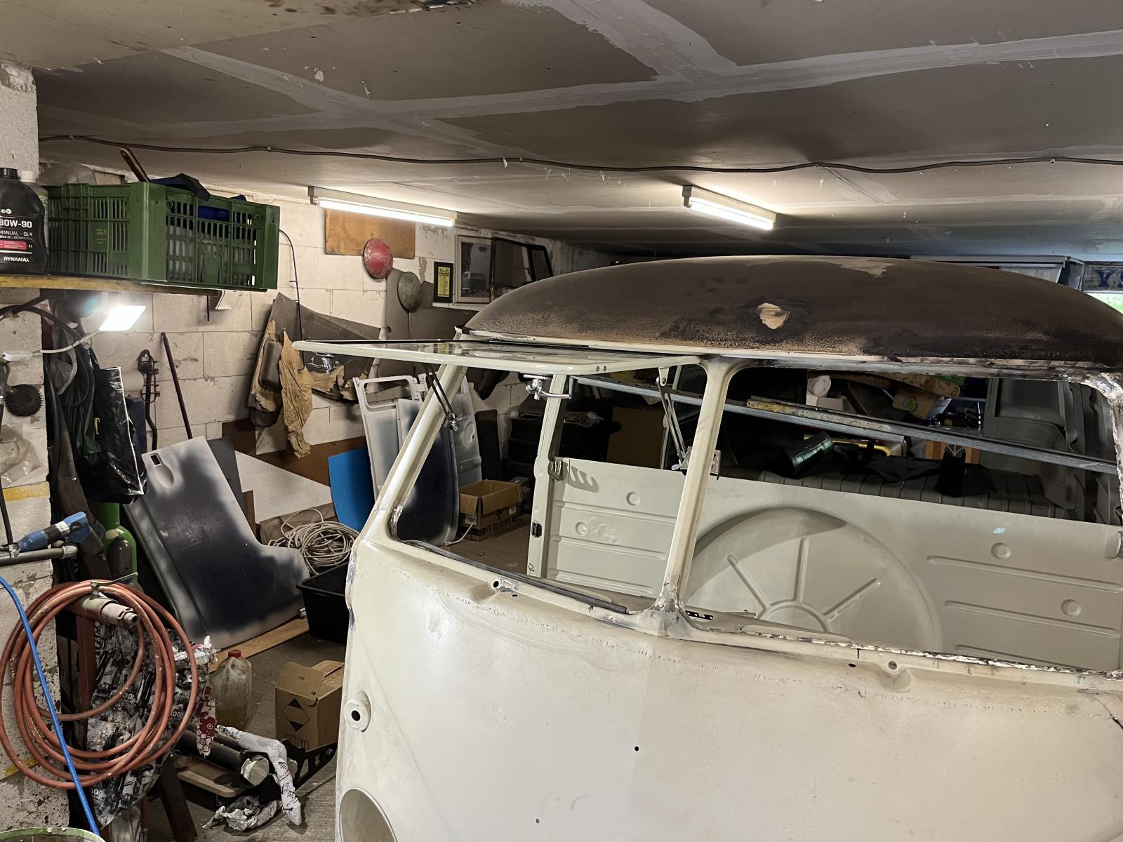

i had to find out how to make the safari recess in the upper windshield frame next
first i marked the metal left and right with a sharpie where the hinge is, window
centered

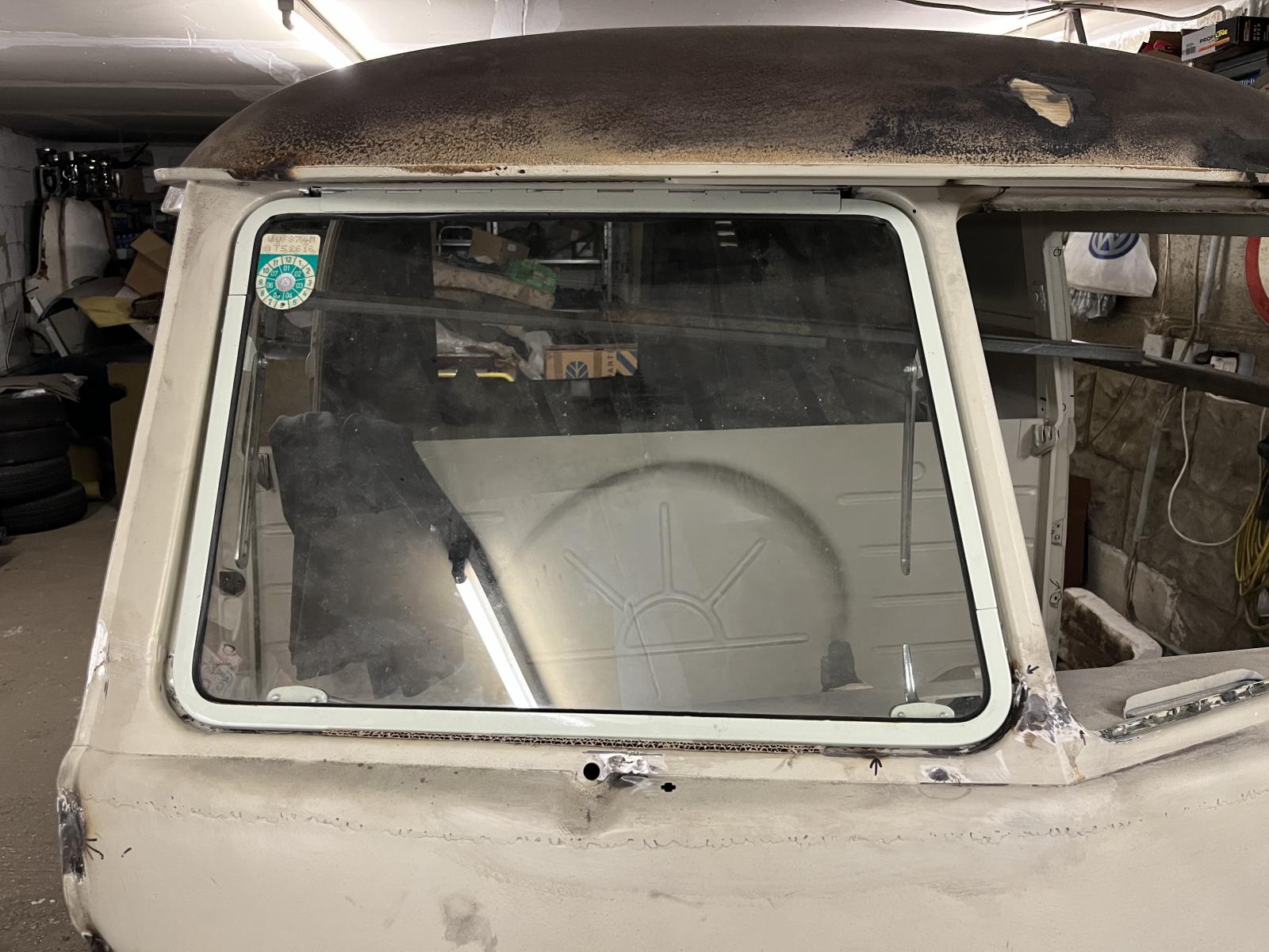

then, using a dremel with a tiny cutoff disc i cut 10mm outward of these marks

using a rounded off chisel
and some visegrips to not desort the lip, i knocked the metal inward and upward very carefully

the result was
trial fit

and welded shut. i used a mini abrasive disc and a rotary file (the one i port my heads with) to even out these

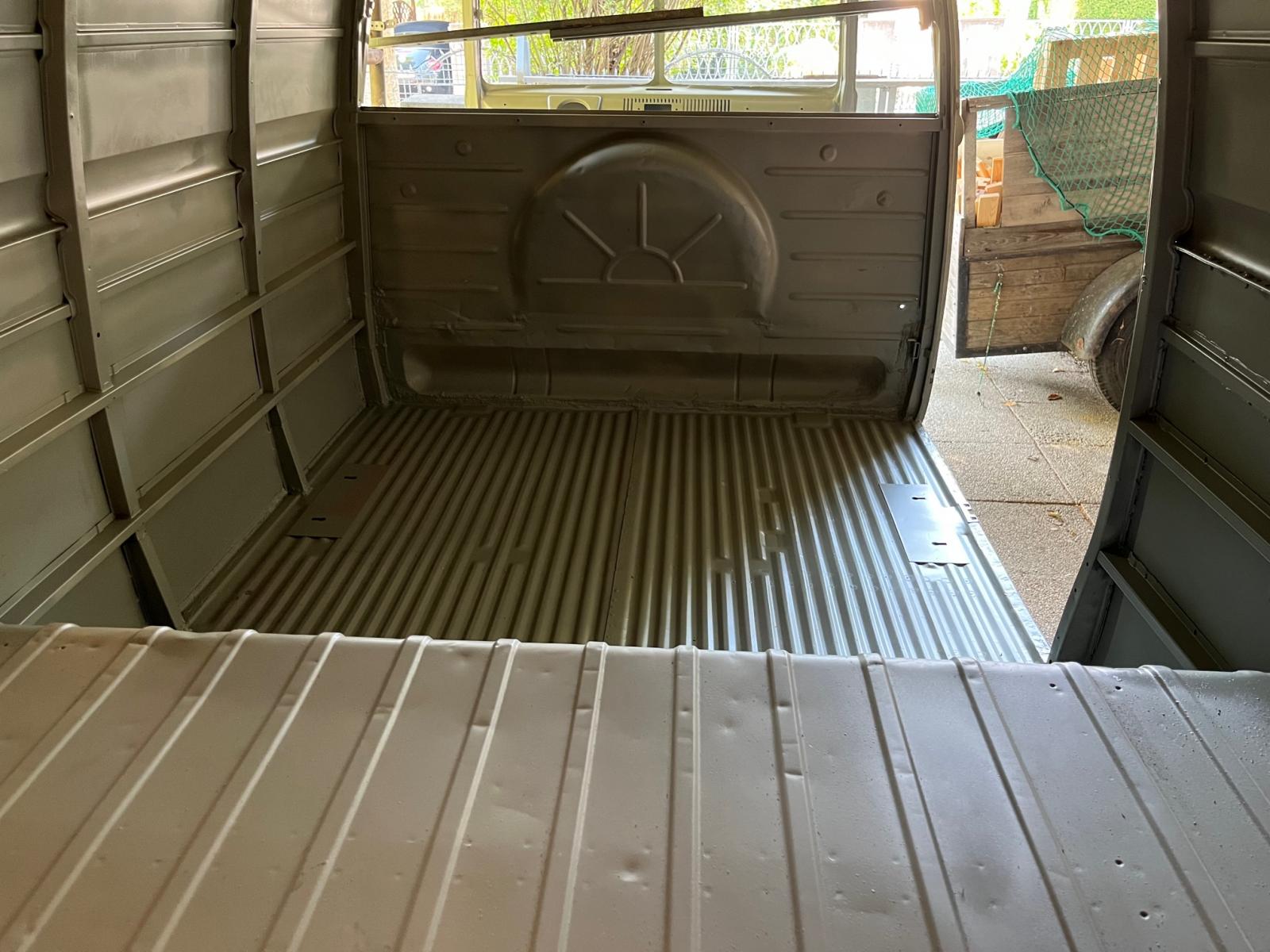

cabin primered
