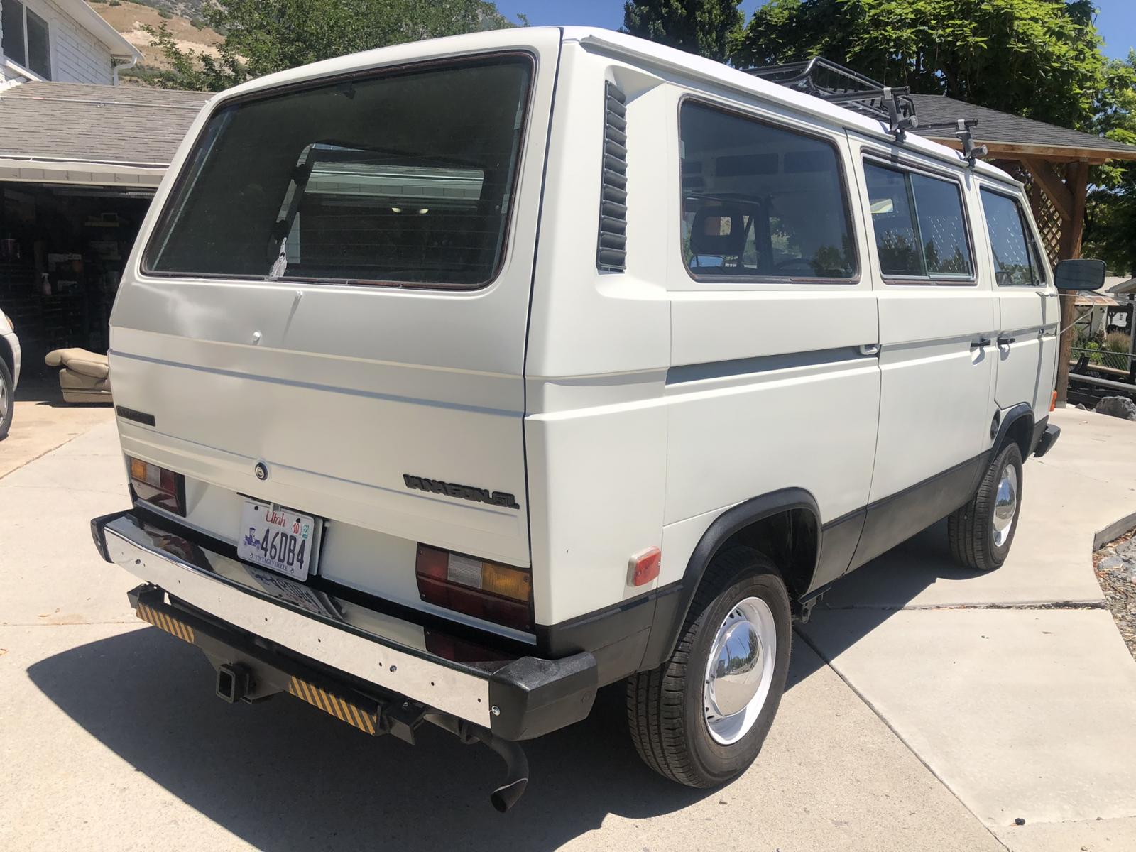

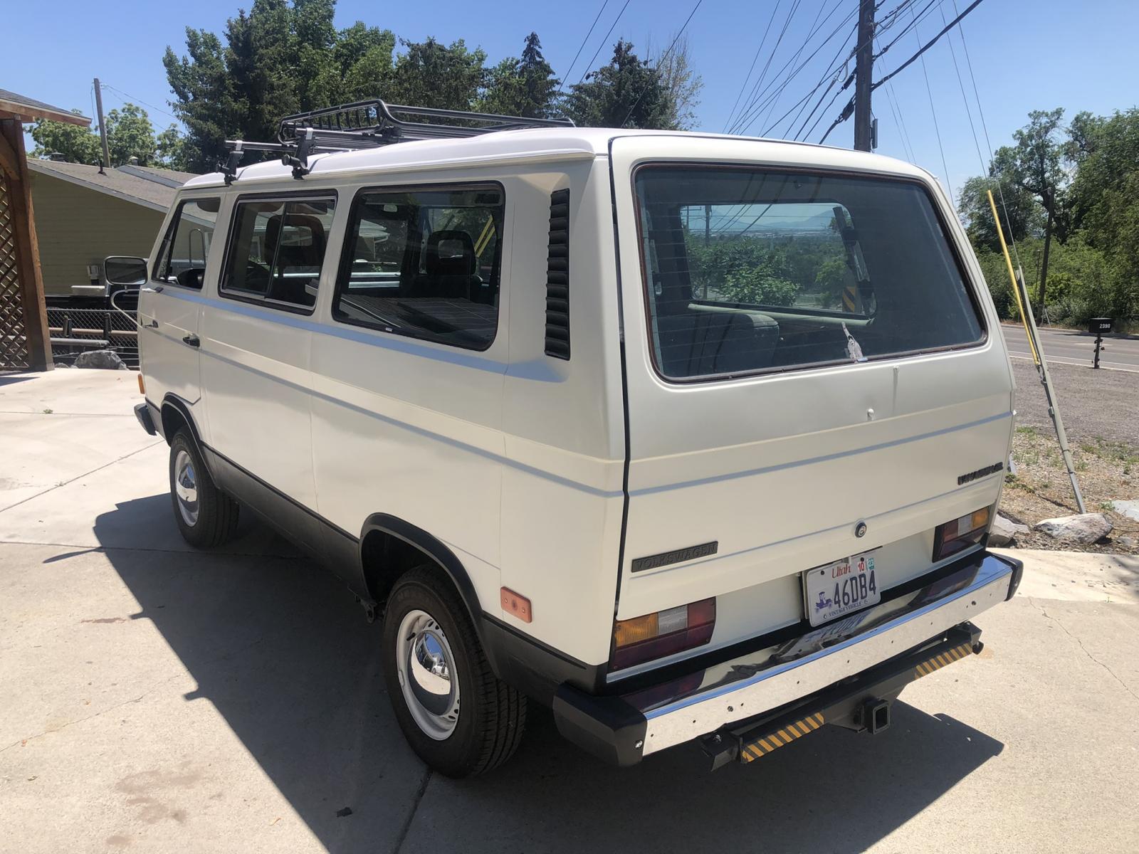

Today July 1st, we got right to it early, to beat the heat (just after scoring a great Shop-Vac from a Yard Sale for $3), the starter went in perfect, I cleaned up all the wires, and did all the due dilligence, hooked the battery back up and voila, Freddie cranked into life. Excellent.
Then we put the rear bumper on, that I scored in the week. Needed some hardware for the end caps but otherwise a fun and simple install. We just need the rubber block trim that goes across the face of the chrome and we're set.

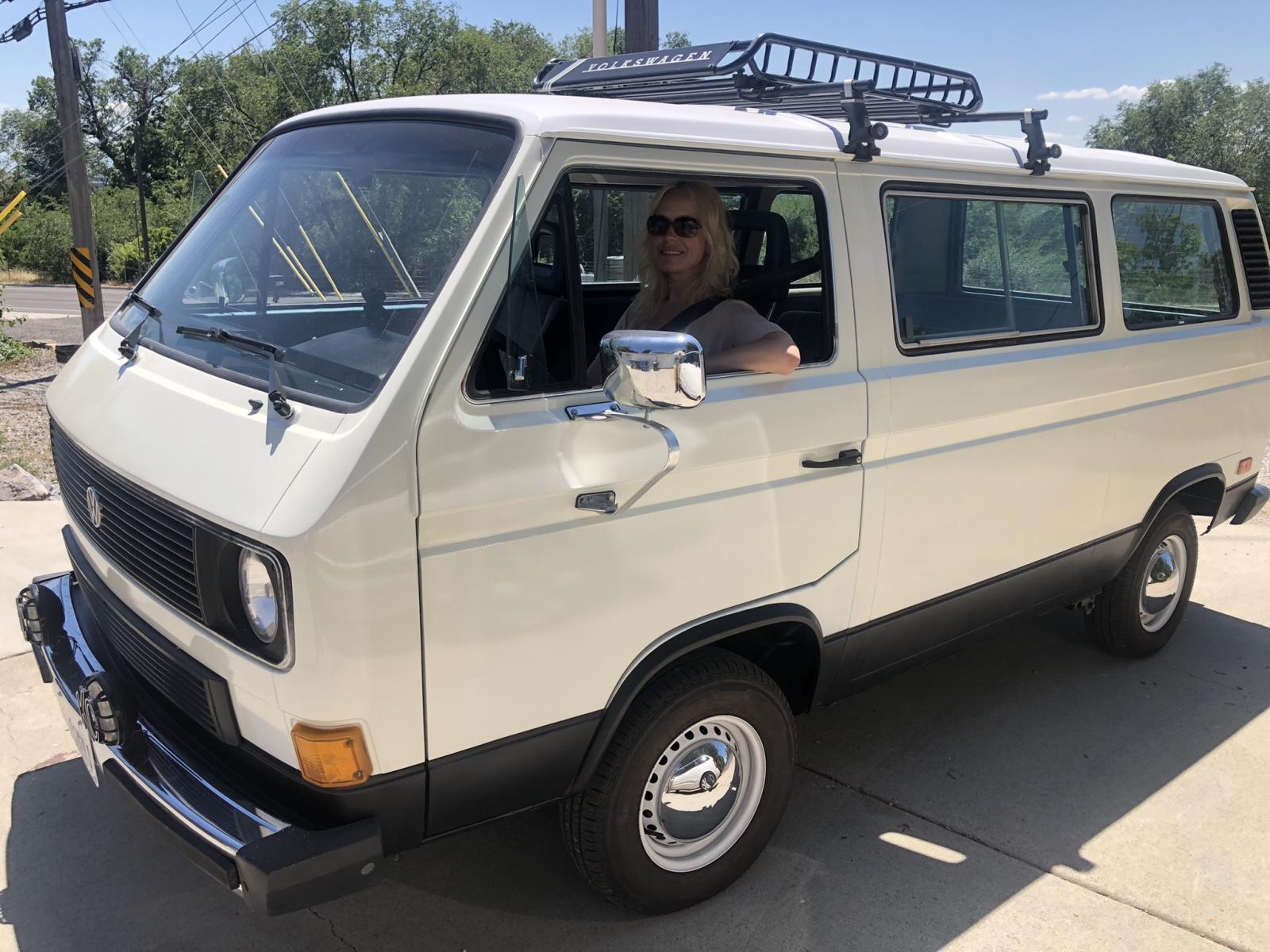

Wifey was very happy, as you can see... and Freddie looks very handsome.
