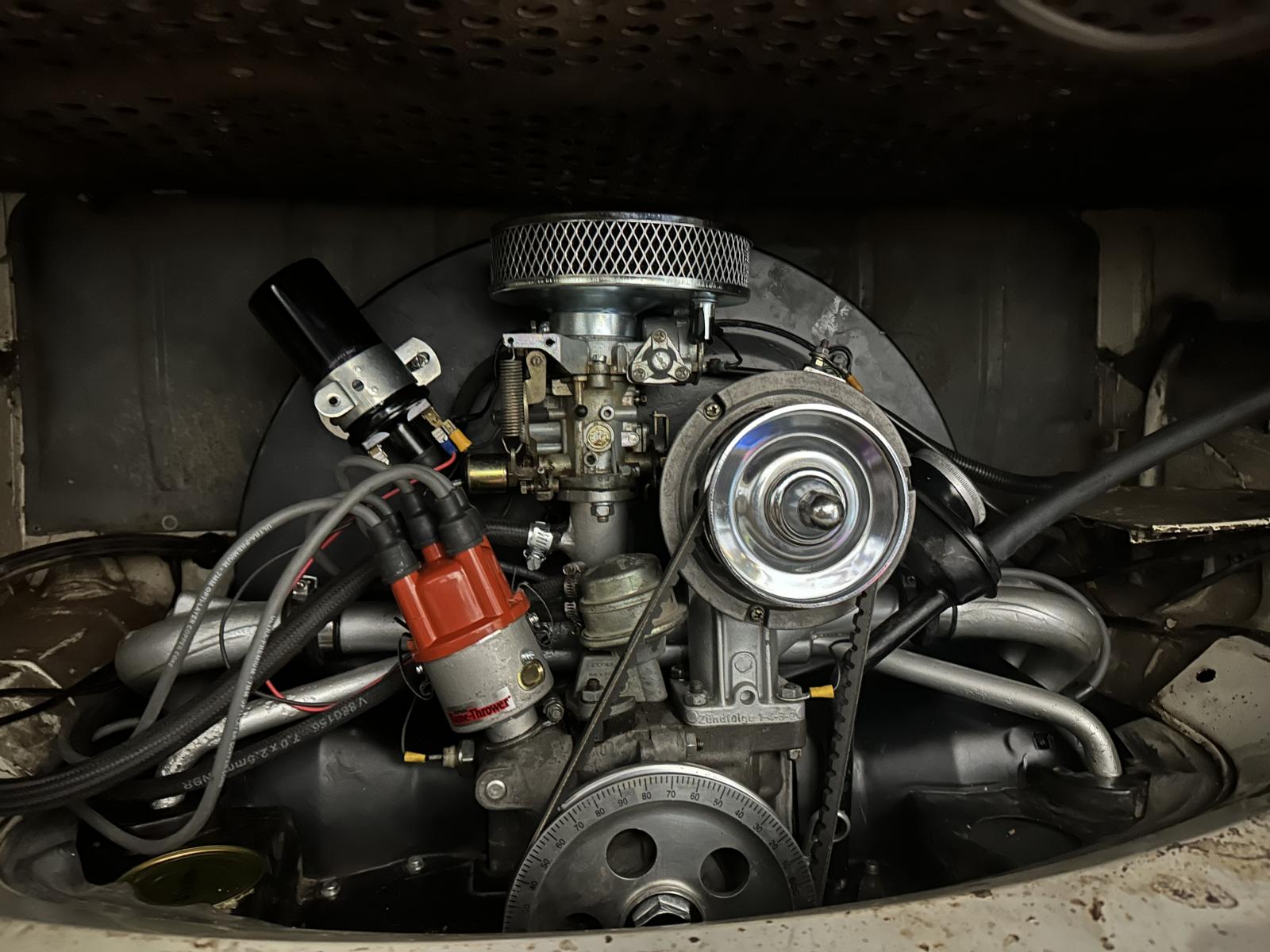

Checked valves while motor was cold, all is good, timing is set, no obstruction in doghouse/fan, oil level is good with fresh oil. All engine rubber in place and tin in place.
I am stumped on cause of why dipstick is pistol hot after driving 3 blocks. . Anyone else encounter this issue? Appreciate any help or advice.

1971.
You say it’s stock. Does that include thermostatic flaps in the fan shroud as well as a working thermostat?
Pics would be nice

Fan shroud from China = no internal fins to direct air flow, chrome alt pully = belt slippage, and power pully = slow fan speed, it might have worked in a bug but a van is heaver. I would start there.

It’s pretty common for folks who slap those fan shrouds on to delete the air deflector tin that forces the cooling aor over the cylinder breadth.
Another thing to check , I’ll try find a picture
