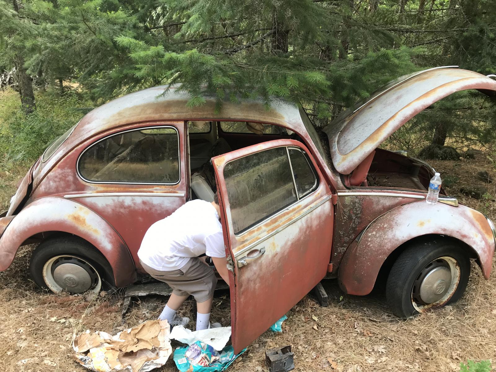

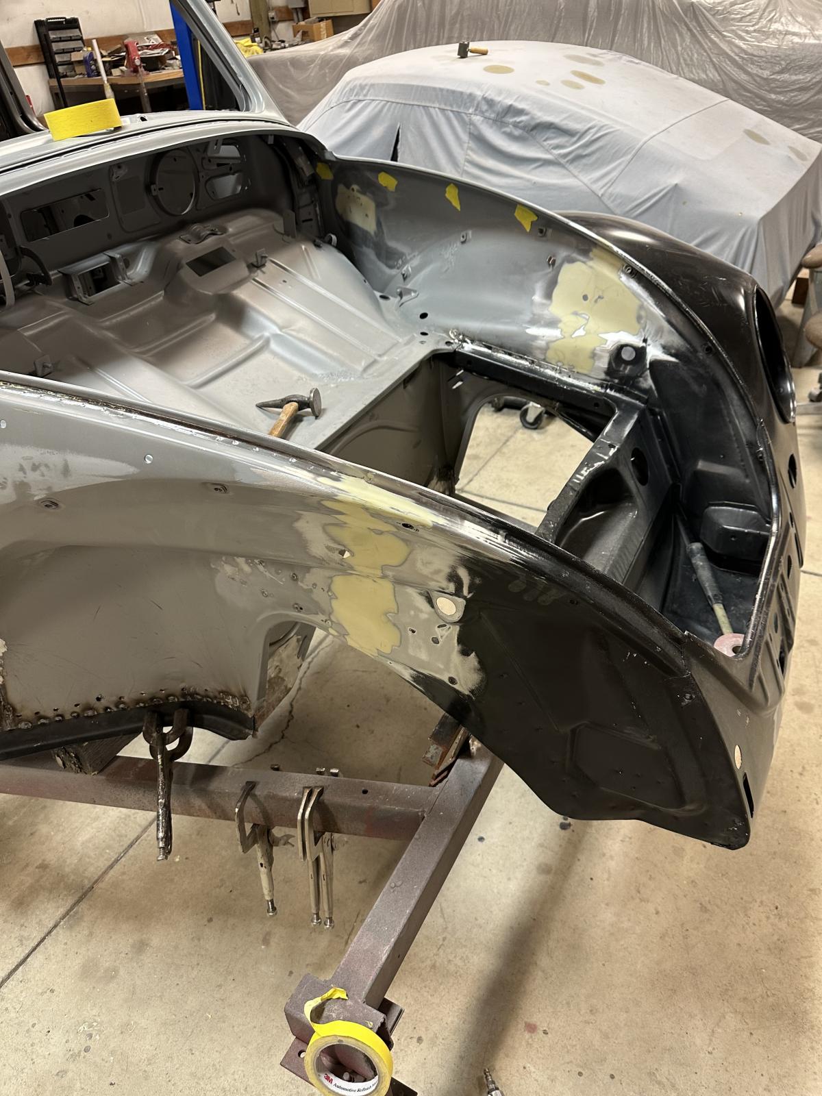

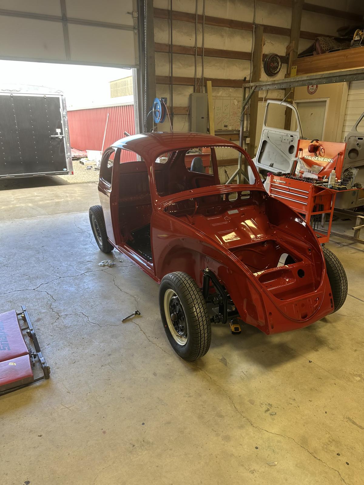

My son bought this car when he was 10 years old. Will be 16 in a few months. Hoping it will be done before his birthday. My son is an old soul who wants the car completely factory. Only upgrades will be 12 volt, 1500cc motor and 4 wheel disc brake conversion. Advice on making improvements to the safety of the car?

Curious, who did the body work on the car. Not many locally want to tackle a bug. The shop complaints are "too many curves." Very Happy

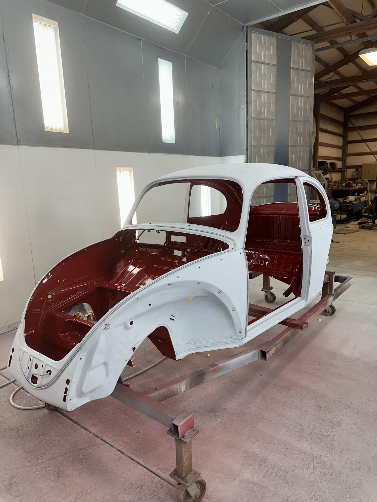

Wow, great job so far. And that's quite the impressive painting facility you have there as well.
Classic car restoration in Harrisburg. His name is Richard Morton and he is insanely talented. He knows these bugs inside and out.
