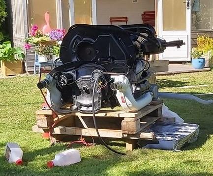

Eric&Barb wrote:
Not enough room for that.
How so? I'm using a 1500 air cleaner on the metal elbow. Mine is on a 1600 dual-port engine. It all fits, even though the 1600 fan shroud has the fresh air outlets.
The air cleaner touches the fresh air outlets, but it fits.
Andy

Who.Me? wrote:
Is this picture of yours an early 1500 Bus air filter on a 40 horse Bus fixed tube from the carb?
If so this looks like it may work for me. I have a beach buggy with almost no room above the top of the fan shroud, making a good air cleaner solution difficult. Since I have a 36 horse style fan shroud on the engine even that slight contact you show wouldn't happen.
Exactly, touching means rubbing a hole thru the air cleaner.
