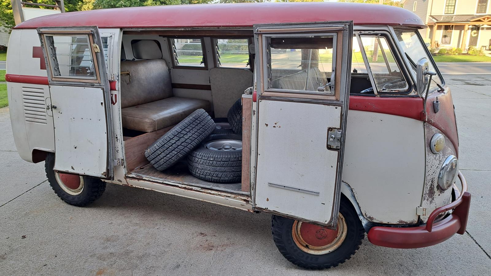

Here she hauls some tires for an American car, because she is open minded.

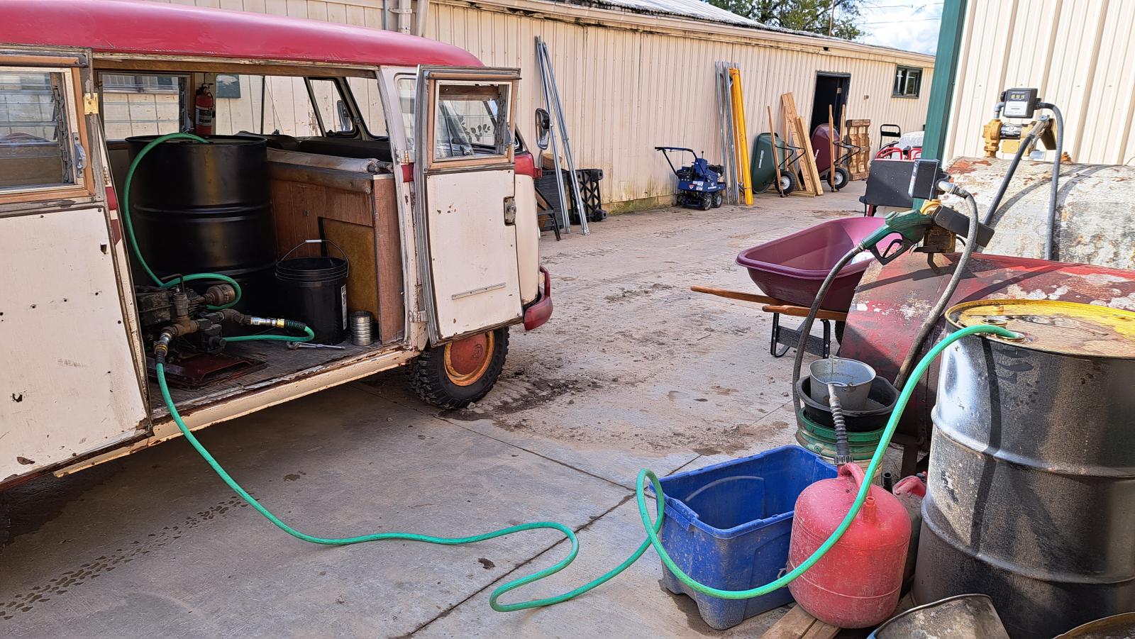

Here is her hauling the waste oil harvesting apparatus, to feed my barn furnace in the Ohio winter, her gift to siblings in que for resuscitation. As well as some shots at the local hardware store and my buddy's auto shop. Laden with about 900 pounds of oil and cargo she lumbered home with the black gold.

You can see the waste oil furnace in the background of these pictures.
It's like a big diesel torpedo heater siting sideways in that blue box, with the exhaust going up the black stack and out the roof. The cylinder of the torpedo heater serves as a heat exchanger. The squirl fan on top of the blue box blows air down inside around the cylinder, and out the front left of the box as warm air. The warm air supply could be piped through ducting but mine just blows out into the shop like that.
The black tank under the blue box holds about 250 gallons of waste oil. It burns almost anything automotive related but NOT BRAKE FLUID (brake oil is too corrosive). It burns dirty motor oil, transmission fluid, gearbox oil, hydraulic fluid, as well as being able to run on diesel or home fuel oil (dyed farm diesel). This one is not set up for bio-veggie oil, but I'm sure those are available if you had a source for it.
The main difference between the burner on one of these compared to the burner on a home fuel oil boiler is that this uses compressed air from my shop air compressor to atomize the oil for the burn, rather than just the pressure of an electric pump. On this, there is an electric motor driving a little head unit to push the oil up from the tank to the burner, and there the compressed air adds its push to generate the mist out of the burner orifice to flame up when ignited. So it needs both 110 household current for the squirrel cage blower and the oil pump, plus the compressed air from a steady supply (mine is an 80 gallon 5hp 220v compressor if I recall, and it runs this plus air tools easily).
To harvest the waste from the hardware store or wherever, I use an old time fireman's pump that has a little Briggs & Stratton gas engine with a pump head on it and some garden hoses to transfer it from tank to tank. I tried a rotating hand pump, but it required significant devotion to upper arm development beyond my interest, and went through a couple 12v DC electric pumps, which burn out after 2 or 3 transfers, but have not tried a 110 AC electric pump as I found this little gas engine pump on Craigslist and it works well for my shenanigans.
Even with an open ceiling, 5 pot vents in the roof and an uninsulated barn, I can keep it in the mid 50s in the worst of Ohio winter weather, and easily 70 at just below freezing outside.
If I recall it burns a gallon for an hour of run time. It cycles on and off at the command of a wall thermostat just like any other furnace.
The best is I don't have to prop a door open and get dizzy risking poisoning by the portable torpedo heater I used to use. It exhausts to the outdoors so its just warm air.

Thanks for the explanation. The atomized oil I did not know about. Is there a lot of smoke coming out the roof? I love being warm when it's cold too.
There is a puff of white smoke out the stack when it first fires up and then runs clean, so to speak, mostly just heat waves out the stack. It runs just like a great big huge torpedo heater. It's not like a wood burner at all. You can hear the whoosh of it while it's running, like a turbine sound. I'm really happy with it.
