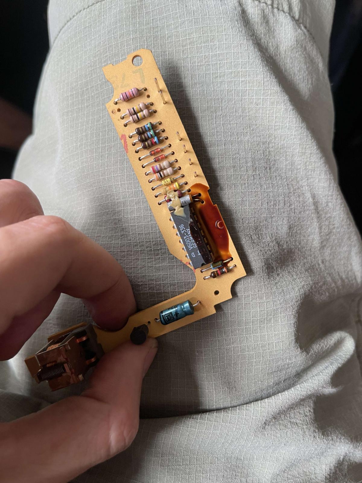

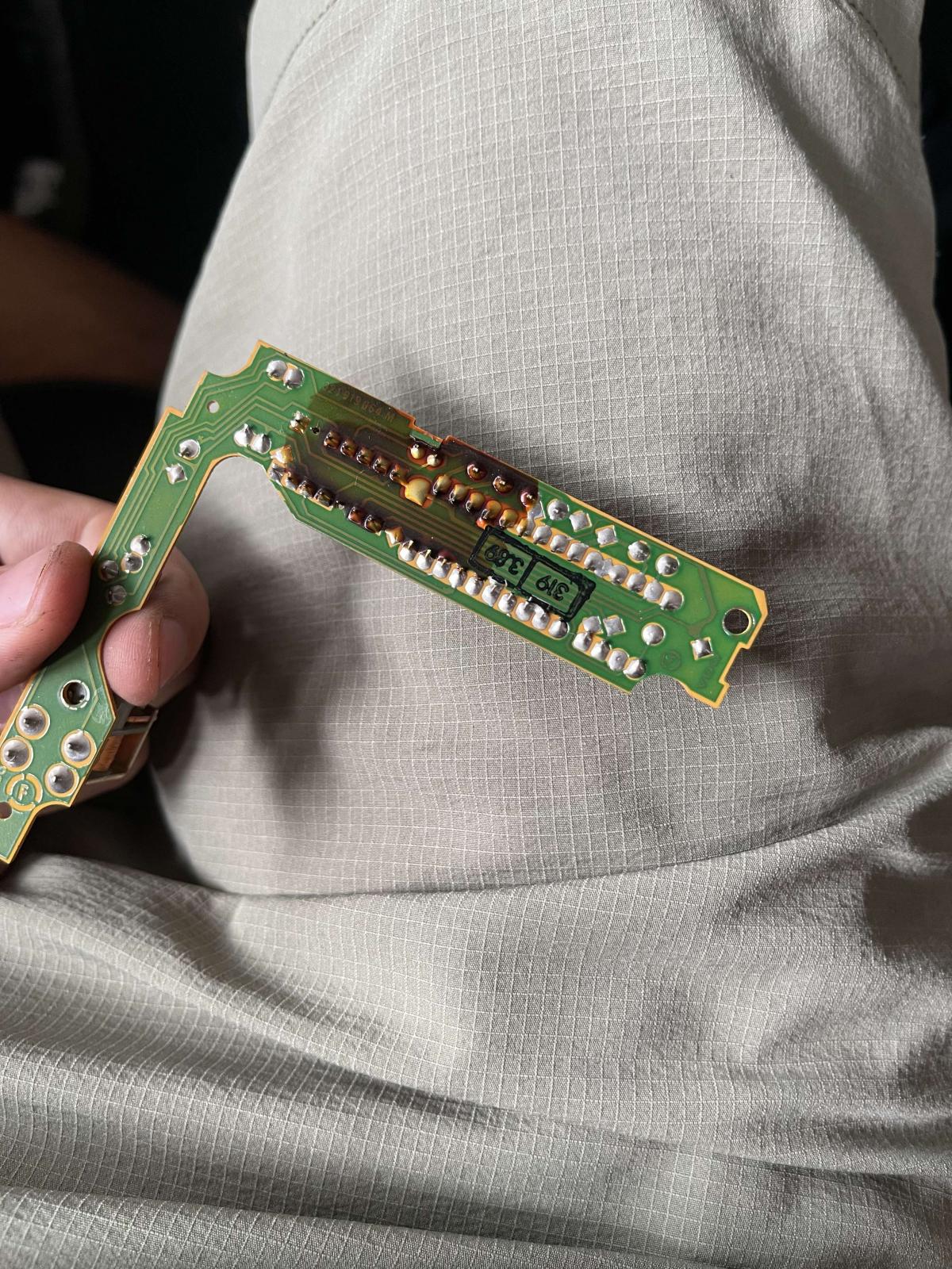

Hi there, hoping to get some help and thoughts on this one!
The oil light on my T3 has started coming on solid. It's dim at idle but goes bright when rev'd.
My current hypothesis is it's a false reading because to my understanding it should only ever flash/buzz but never come on solid? It also doesn't make sense to me that the oil pressure would reduce with revs.
What I've tried:
- To test the buzzer/flasher, I disconnected the sensor in the engine bay and rev'd it to 2k but it does the same thing regardless of whether the sensors are plugged in or not
- Tested the two sensor leads with a test-light following Thomas EXOVCDS video which came back correct - indicating the sensors are ok
- Cleaned a ground crown
- Removed the oil pressure logic board to check for damage - not sure what I'm looking for but it has got a brown residue on it, unsure what it is however - see photo.
What I haven't tried yet:
- Oil pressure test (will do one but I think its unlikely as the engine was rebuilt not long ago)
- Replacing the sensors
Questions:
- Keen on any ideas / help!
- Am I right that the later model T3s with the buzzer/flasher oil pressure units shouldn't ever come on solid?
Video of the light coming on during a cold start:
Photos of oil pressure logic board:

jmac66
Joined: September 11, 2024
Posts: 6
Location: Sydney, Australia
jmac66 is offline
PostPosted: Sat Sep 14, 2024 6:16 pm    Post subject: Re: 1990 T3 Oil light on solid Reply with quote
Ok so update - I've replaced the two sensors which were relatively crusty, and unfortunately its still doing the same thing.
Next step I'm taking is to verify oil pressure once I've borrowed a tester from a mate.
Haven't been running it other than to check if any of my attempts have been successful.
I still think its highly unlikely its low on oil pressure as it doesn't make sense the light is solid - but keen to verify for peace of mind.
Thanks for all the help so far!
